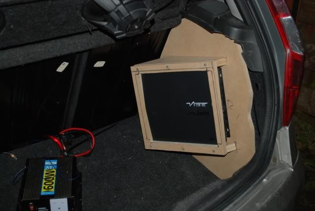

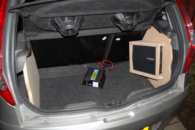

Quick Preview
Here is a wuick preview of what ive been up to today.
Here is a similar install for an Alliante. I would say that most subs need more layers and deadening because they move a whole lot more air than this sub.
http://www.talkaudio.co.uk/ipb/inde...-step-by-step-building-tutorial-lots-of-pics/
Please note that a normal sub would need much more air space too.
got fleece now metre by 6foot for £4.20. What you think of my amp setup. still got to finnish the back plate thats just a quick preview what it will look like. before fleecing
