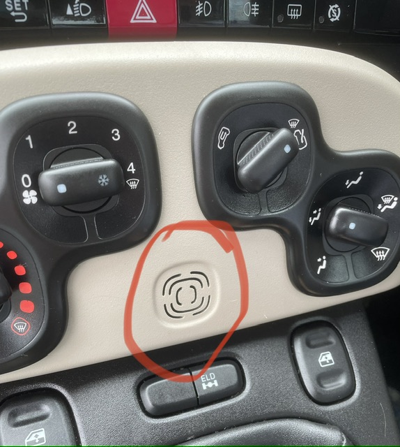

So what’s this lil fella for then?
Yep… cabin temperature sensor for cars with climate control.
Auto climate control? I've manual air con so no sensor presumably?
BTW, there's another one on the roof above the windscreen, I just thought that was a small speaker, so is that another sensor?
Fiat Panda Hatchback 0.9 TwinAir [85] Wild 4x4 [Touchscreen] 5dr
@AndyRKett Correct: The one by the interior light is (when fitted) the mic for the phone/Bluetooth (and used by the 'talk' button on the steering wheel for voice commands). (if you have the twin spotlight interior light, the mic is built into the light unit itself)
@Jamie KC On cars with auto climate control a tiny fan sucks air in through that little vent on the dash and over a thermistor (temperature sensor) to monitor the cabin temperature. Over time, that becomes less effective as fluff fills the vent! On my Multipla (many moons ago) I cleaned out out and it made a big difference to how well it regulated temperature. The Climate system also has a sunshine sensor on top of the dash (and turns up the cooling if the sun's streaming in), and may have a humidity sensor too (on my Volvo and now Skoda this is on the back of the interior mirror) which it uses to sense if the windscreen is likely to steam up. And yes, if manual aircon, that grille has nothing behind it.
