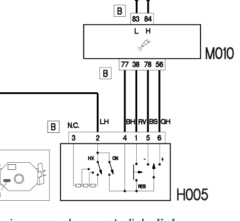

The "Cruise Control function" is managed by engine management control unit M010 by the left steering wheel stalk control H005 (connector B).
The steering column stalk control receives an (INT) ignition-controlled power supply - pin 2 of connector B - protected by fuse F51 of the junction unit under the dashboard B002.
The steering column switch unit H005 is connected to control unit M010:
  • from pin 1 of connector B to pin 38 of connector B, with the RESUME signal;
  • from pin 4 of connector B to pin 77 of connector B, with the ON/OFF signal;
  • from pin 5 of connector B to pin 78 of connector B, with the SET - signal;
  • from pin 6 of connector B to pin 56 of connector B, with the SET + signal.
The engine management control unit receives the speedometer signal, through the CAN (pins 83 and 84 of connector B), coming from the ABS/ESP control unit M051 and the other signals useful for the function internal management logics.
The engine management control unit M010 is connected, through the CAN line, to the Body Computer and the instrument panel E050 to manage the "Cruise Control on" warning light.

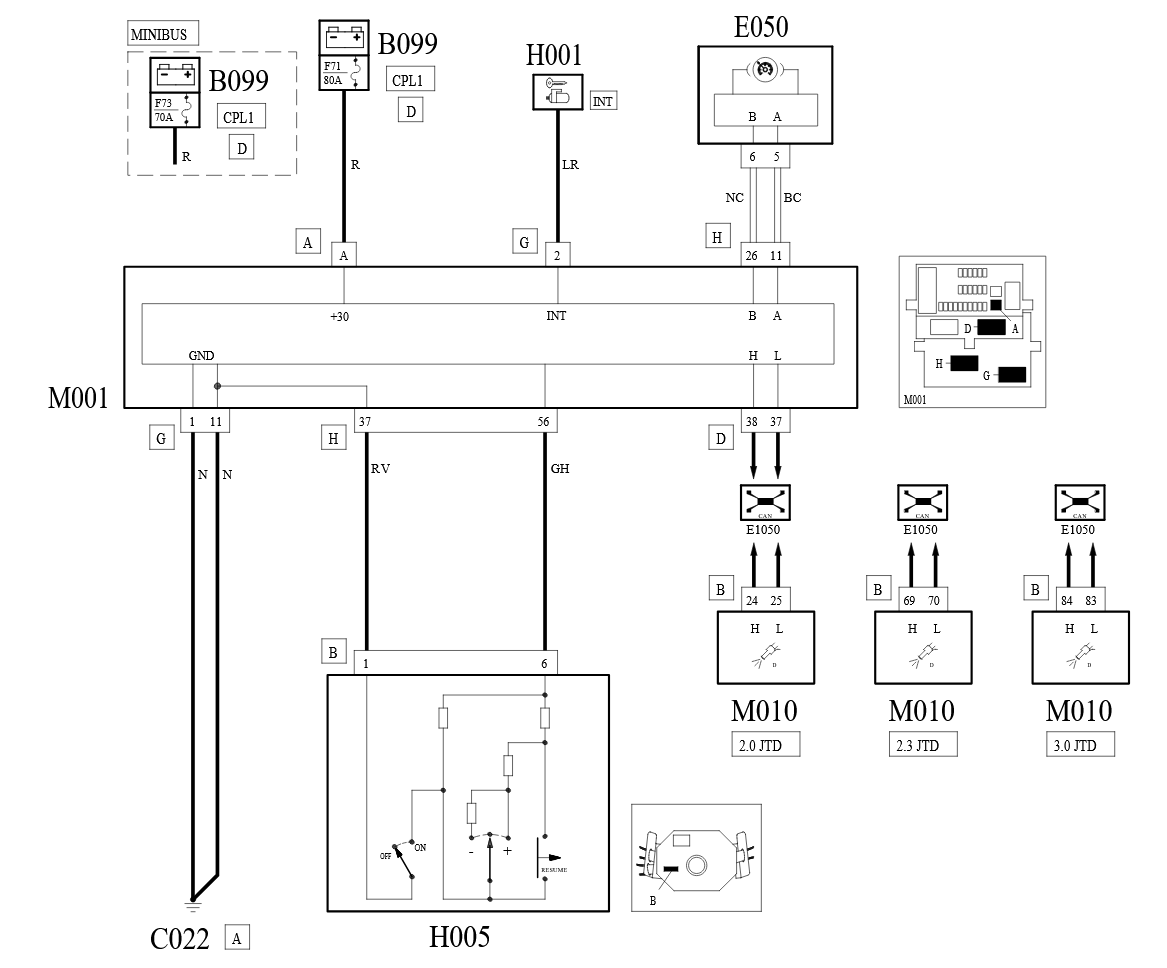

That's the x250 EUR5 cruise control wiring diagram (2 pin lever):
That's the x250 EUR4 cruise control wiring diagram (5 pin lever):

As far from I've found on the internet (other forums, youtube, etc.) a part of the x250 has the wiring ready, so there are only two things to do: buy and install the lever and activate the cruise control function in MES. In some of the cases, activation via grounding one of the terminals is possible, can't find the details at the moment. If not, this part of the wiring has to be done. I've read people were reusing the pins from the looms leading to the ECU.
The original wiring is 0,35 mm2.

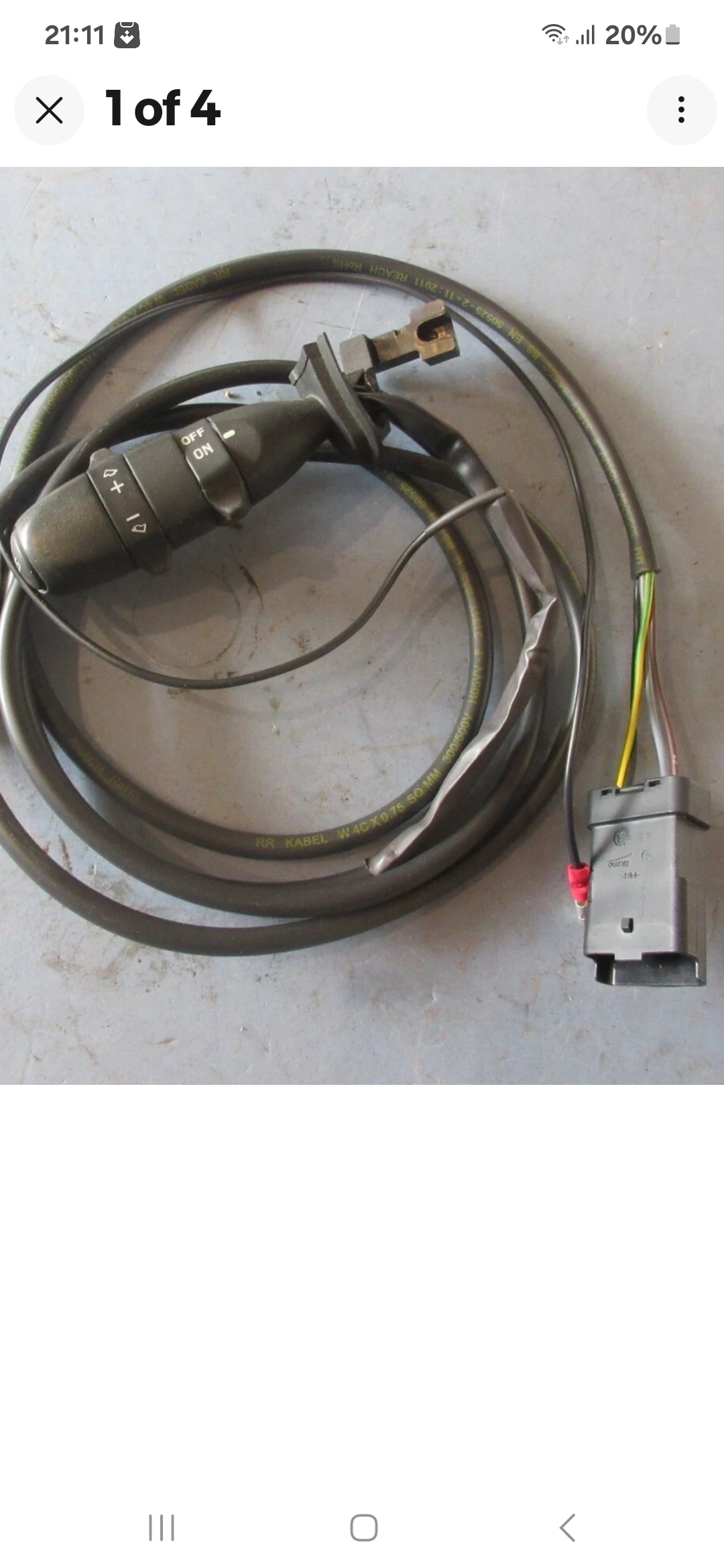

This is how the lever plug looks like. I had somewhere the producer part number, can't find it right now.
