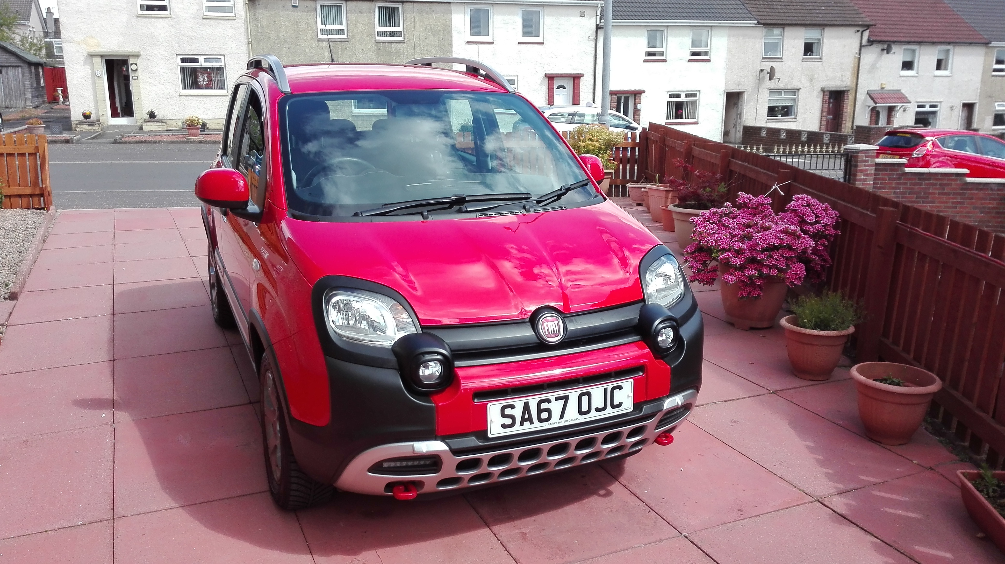

Hi.
This is the cross version with the fog lights beside the headlamps.
Not low down on the lounge etc.

Hi.
Can someone tell me how to gain access to the fog lamp bulb on the nearside (RHD) on a cross. Looks like a bumper off job.
