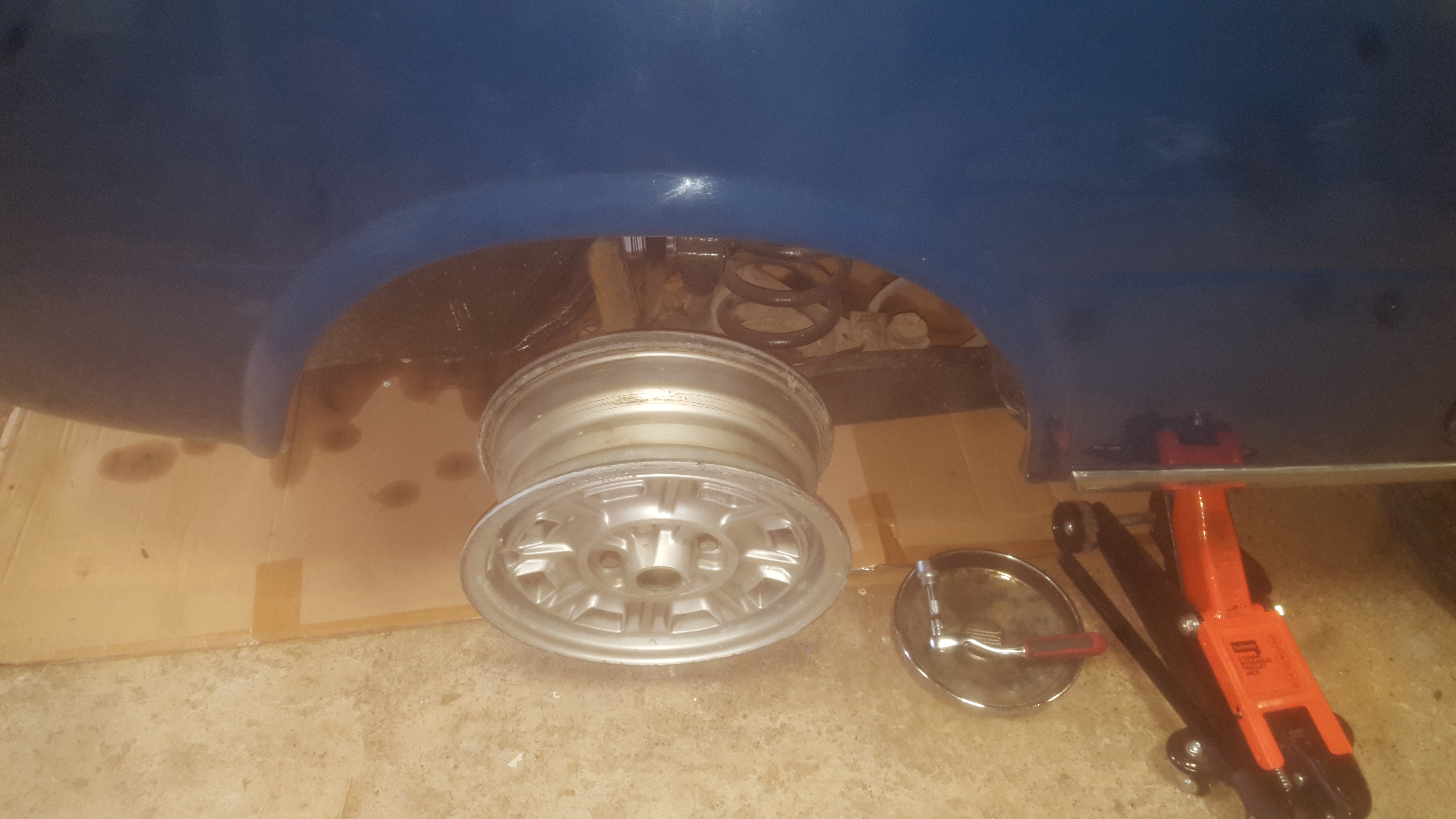

What tyre sizes are folks running on they're Berlina/Sedans while using Cromadora alloys?
165/70/13's work or?
Thanks!
Gav
Can't leave them sticking out like that anyway!!!

Don't forget. Due to the pivot position as the wheel goes up in the arch it will tuck in at the top.
I did fit some 165/80/13 tyres using the same wheels on an 850 saloon about 7 years ago and the did run a little on the inside of the arch. 165 width is only helpful if you start increasing the performance otherwise it adds drag. I would look at 155 70 13 but speak to a tyre outlet as you want to keep the diameter close to original for the speedo to be accurate.

Thanks Tim, as always you are reliable at coming back to us on questions.
I foolishly never thought of the weight going back on them resetting the camber angle to a degree, going to have a look at getting the size you suggested. There will be no performance enhancements with the exception of a beefed up exhaust that will more so generate noise over grunt. Found one on Ebay that I'm going to go for purely as I've a lot of time on my hands and boredom is setting in.
Tim
Tim,
I trust you are keeping well? I went with your tire size suggestion, a pal is going to fit them to the rims this week. Got a set of brand new/month old tires that a mate bought for a micra but road noise on a motorway drive him nuts, I'm not going to be doing 80mph nor am I going to be doing that much driving so €50 well spent.
You that has fitted these, what thread length did you go for on the lugs? Going to go to a motor factor tomorrow with a standard lug and see what they have in and around 4-5mm longer. There is a bite there using it's own but not enough.
