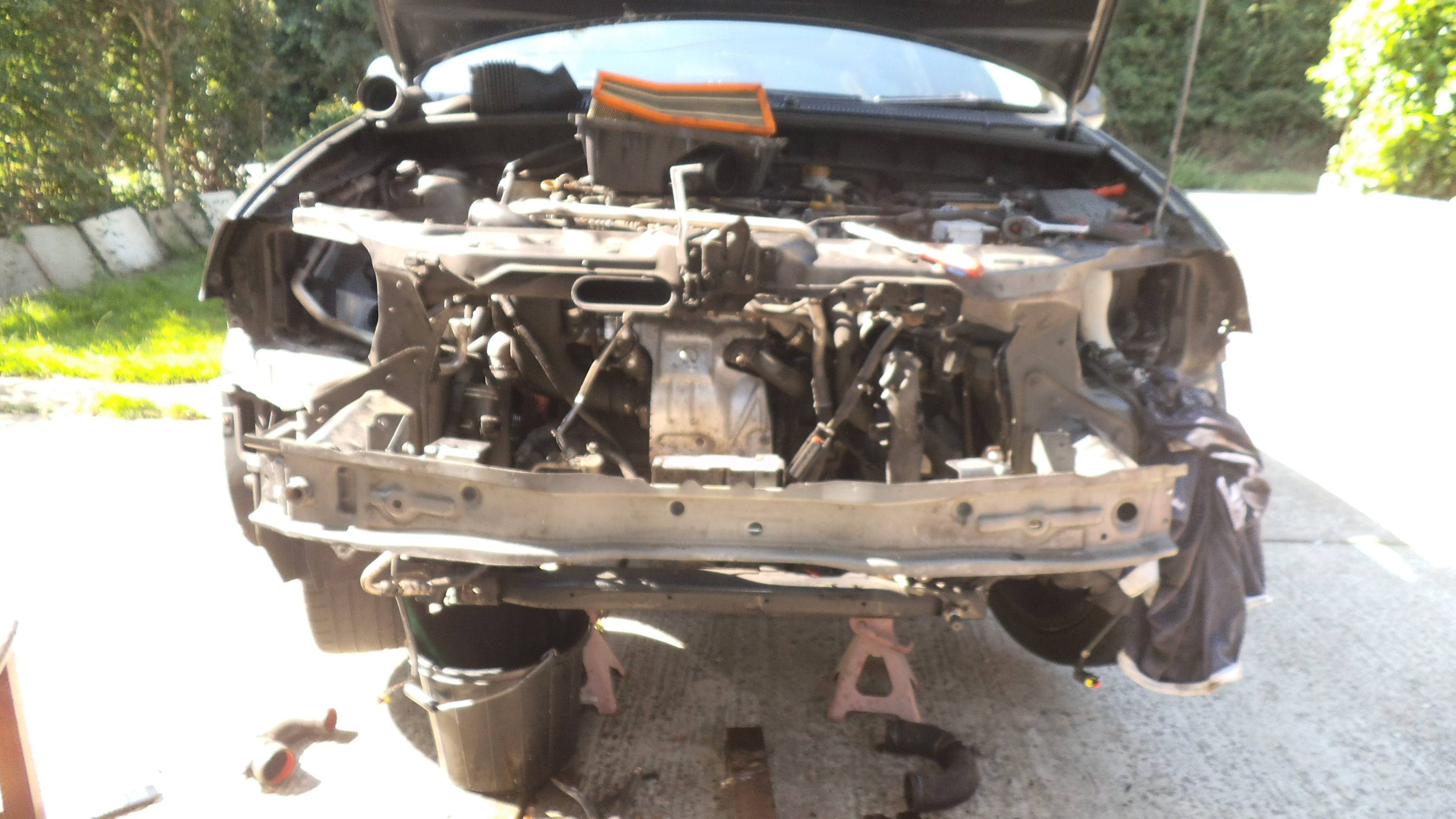

Some years are passed and I don't remember well...but now if I think about that...I think i had not removed the wheels and so the curves... to remove the bumper.
I certainly removed them for other works (eg. alternator, ditribution etc.)
I found this photo of my car taken on 24/11/2012
I don't remember well as said....but maybe I removed right wheel only and after I found that it would not been necessary...so I didn't removed the left one...
