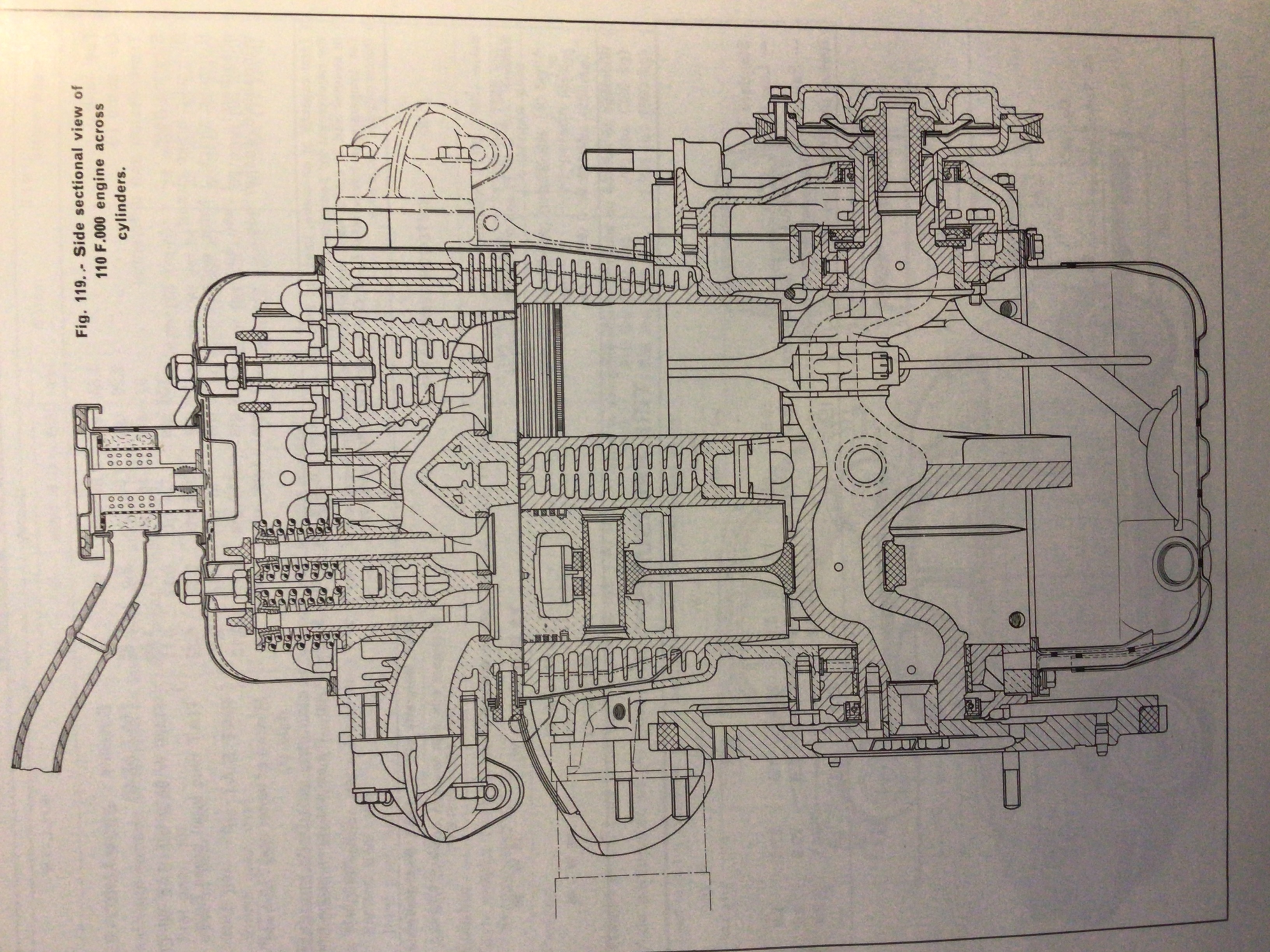

I have never seen a rear main bearing that protrudes beyond the face of the bearing case in fact all the engine drawings in the original workshop manual show it flush. I believe that originally you could buy the main bearing white metal inserts to fit the housing so you could have one that has been fitted incorrectly or possibly been made as a repair. Apart from that the crankshaft end float is determined by the components at the timing chain end. The sectional drawings show the crankshaft nut, tab washer, oil flinger, crankshaft pulley, timing chain sprocket, piston ring type seal, spacer with chamfer onto crankshaft & main bearing.

Steve, I think some confusion may have set in cause partly by the naming of the parts. On this forum at least, No. 1 cylinder is usually taken to be the one nearest to the back of the car; logically, the front of the engine? So I would call the bearing you have shown, "the rear main-bearing". Although, as Toshi 975 has said your old bearing is wrongly setup, if anything, the protrusion might have taken up existing float in a crankshaft; but the new one looks correct.
It is the front bearing which controls end-float, and it does this, once the pulley-nut is tight, by having the white-metal in a top-hat formation. This provides a thrust surface with lubrication grooves. A new bearing should err on the side of having maybe a little too much metal, which can always be taken away. I confess that I have never measured end-float but never been aware of a problem that could be put down to too much float.
