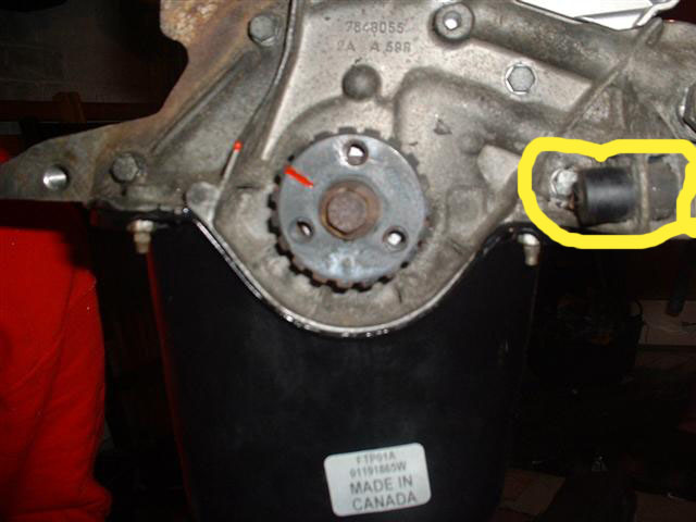

I was advised in a previous thread that my Cinq's intermittent stalling problem might be due to faulty wiring to or failure of the crank sensor. I can't find crank sensor in my repair manual - is it also called the TDC sensor?
If indeed it is the TDC sensor, the manual gives instructions for removing the spark plugs, etc. to set TDC for each cylinder (I think), but no instructions for just checking/replacing the sensor. It looks like the sensor is on the outside of the engine. Can I remove it easily without taking off other bits first?

crank and tdc sensor are the same thing. if you look under the car from the front, left hand side of the engine. look at the auxilary drive pulley. it has teeth on the outer bit of it - and pointing at them teeth is the TDC sensor. just taken a couple of pics of mine to show you, but my car has a few other bits missing atm so might look a bit different. circled the TDC and cabling in yellow. hope this helps.

The crank sensor is the TDC sensor, so thats quite straightforward.
Now, The TDC sensor tells the ECU when the engine is at TDC (top dead centre) by looking at the toothed wheel on the end of the crank. If you look at the wheel you will see it has two teeth missing, these missing teeth is what the sensor is looking for to send the signal to the ECU.
You do not need to remove any other engine components to access the TDC sensor, although taking the wheel off will greatly help.

Thank you both so much!!
The pictures are brilliant - the diagrams in the book never quite do it for me when I'm trying to find something under the bonnet.
And thanks for the tip about removing the wheel, I'll keep it in mind if I'm struggling to get to the TDC sensor.
