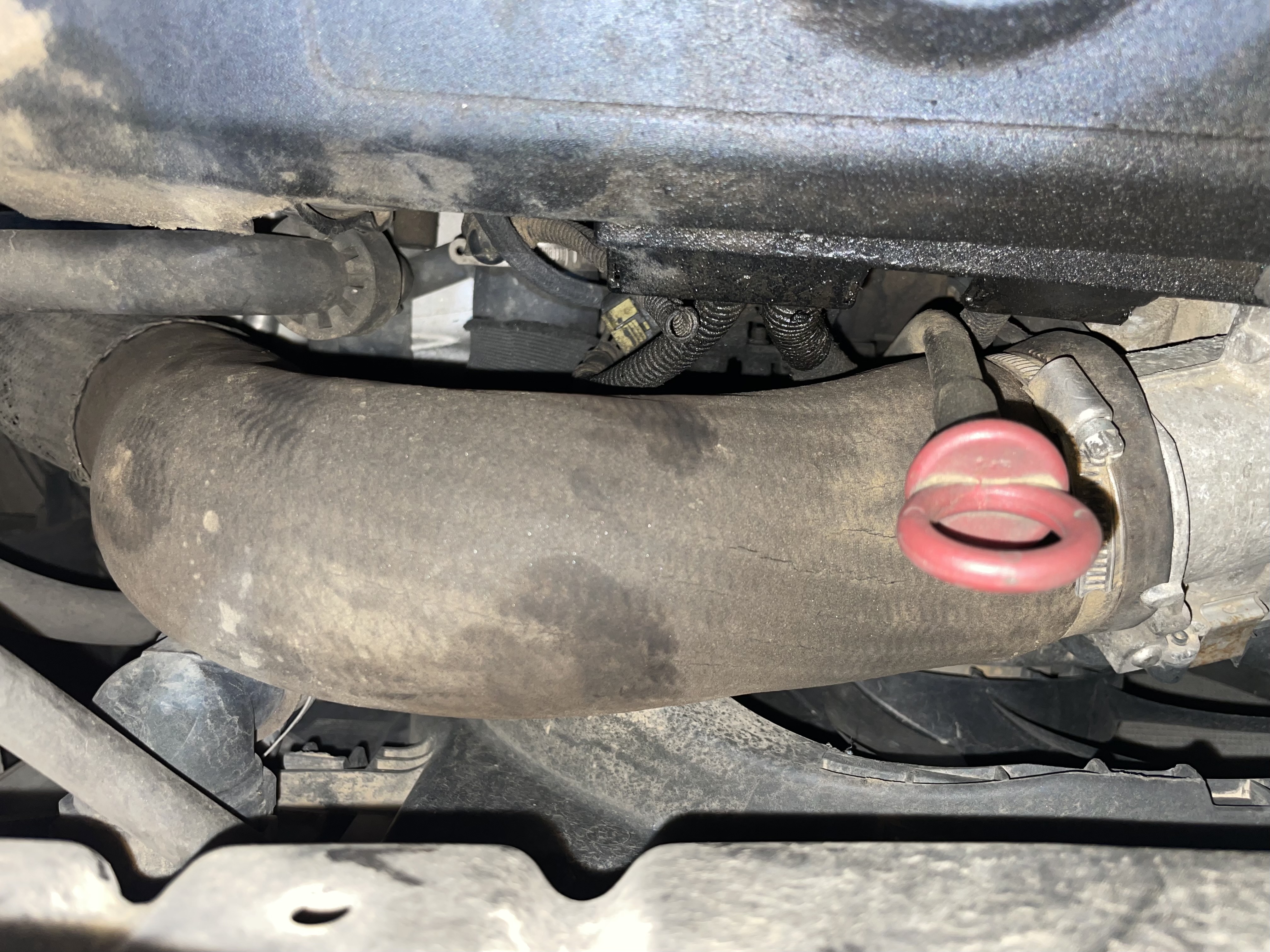

Hello all,
I've been having some unusual lag when accelerating since yesterday. The response when I push the gas feels mushy and takes maybe a second longer than usual? So I started looking for air leaks among other things.
Everything I can see seems ok except for the section of rubber pipe from the cooler to the throttle body. See attached photos.
These cracks are not new though, they've been there for a couple years at least. If I squeeze, I can see the reinforcing thread in some of them. Is this acceptable/cosmetic wear for 12 year old rubber sleeves or cause for replacement?

'Rubber' hoses often rot on the outside where they are exposed to light etc, but remain perfectly fine on the inside. So you need to look at the inside, not just the outside.
your best bet is to build or buy a smoke tester.
they use baby oil to make the smoke.
id probably change that hose as its not looking too good.
