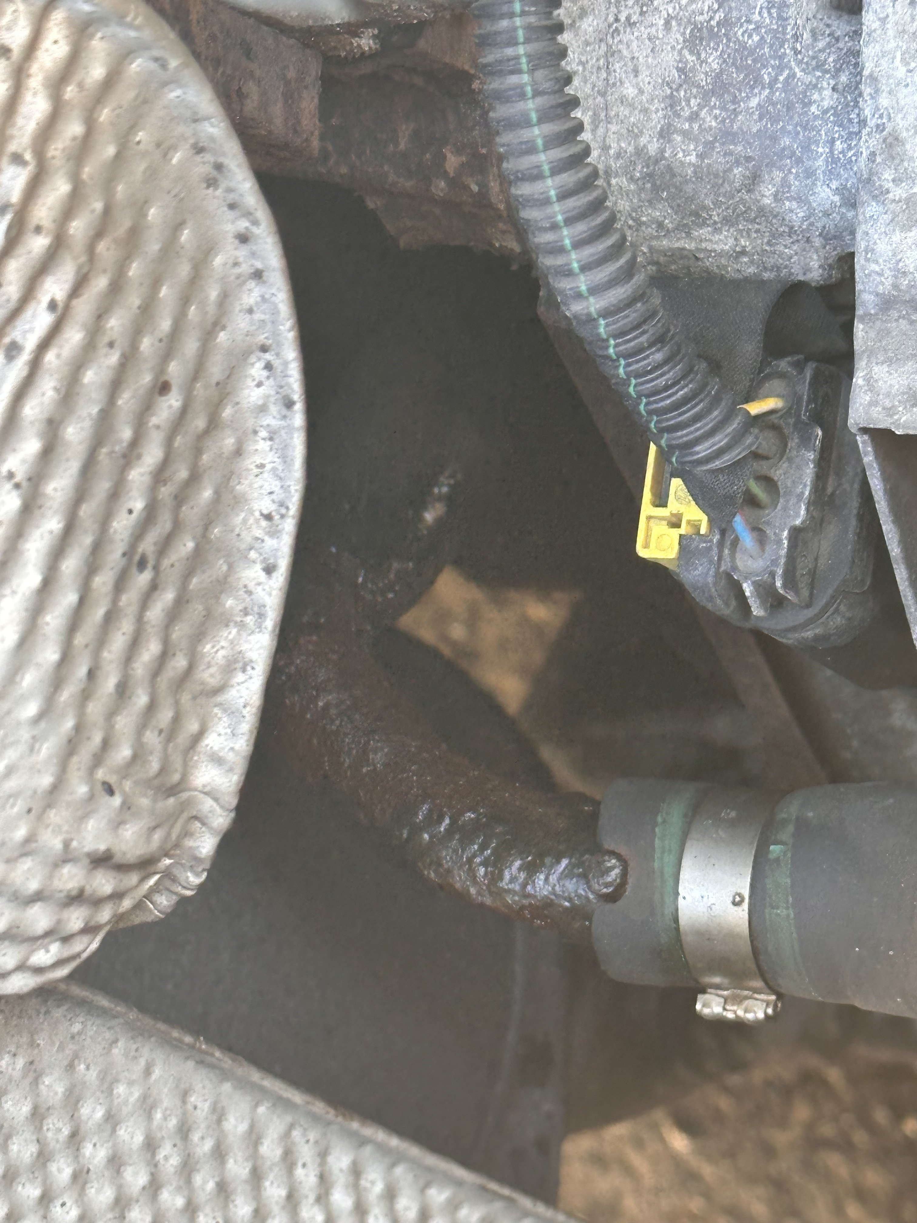

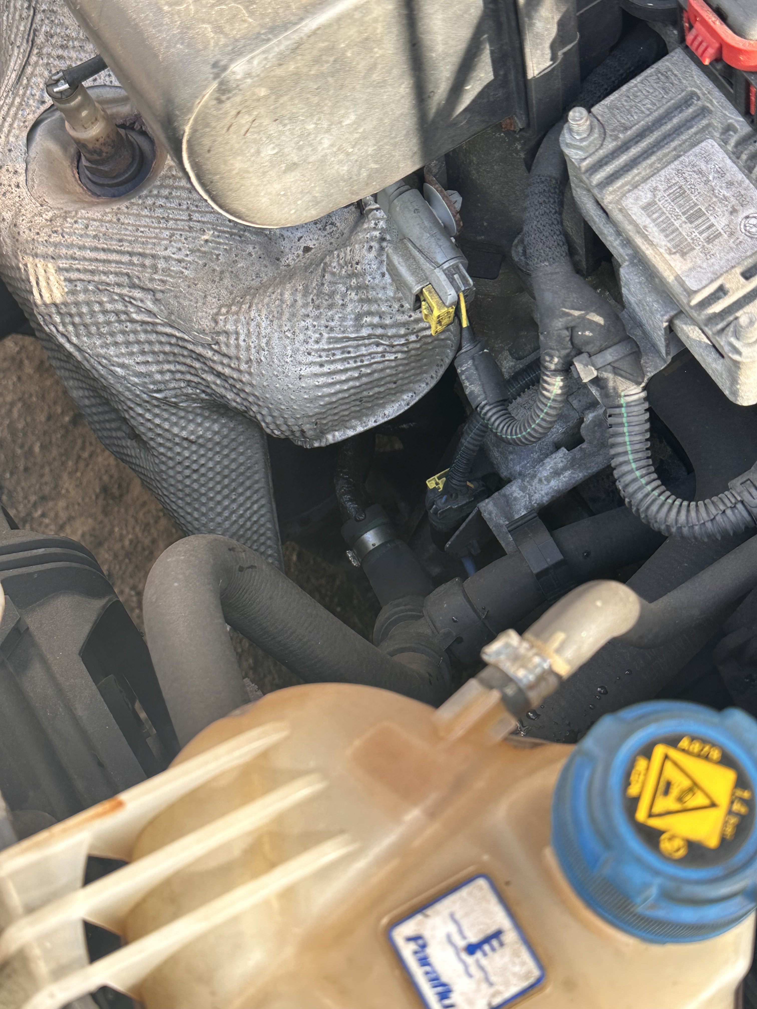

General Could some one tell me where can I get the flange part as my car has a broken coolant pipe, ,? Is it called flange or any other part..?

There's a bolt that holds it in place its tricky to undo but doable remove the cooling fan(s), you'll need new jubilee clips too and replacement coolant, be especially careful with the heater hose bleed screw once filled and purging, do not put off this job!

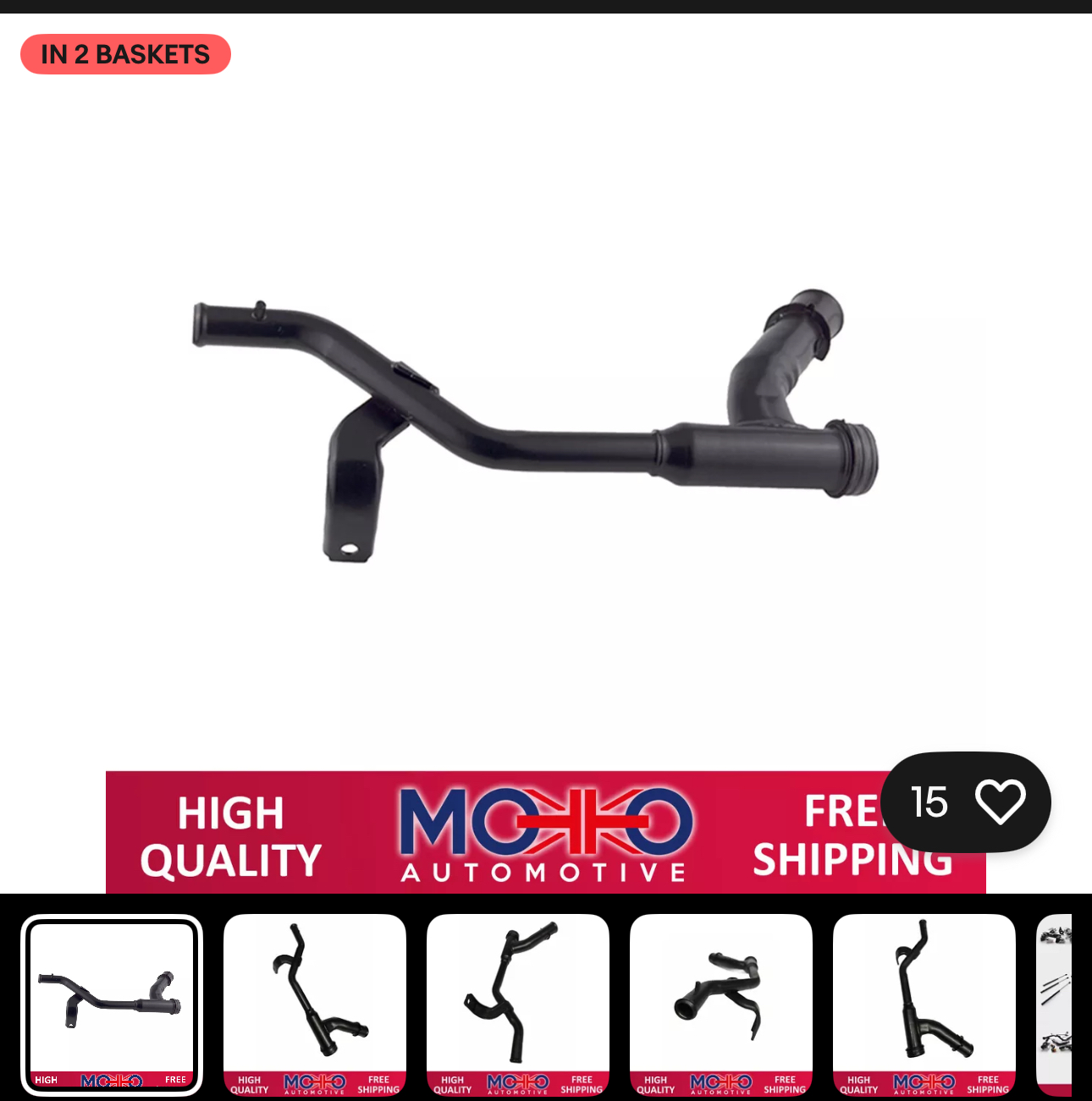

Thank you very much sir, I approximate your time. I’ve just bought a new flange on eBay . I hope that fits well with my car .
