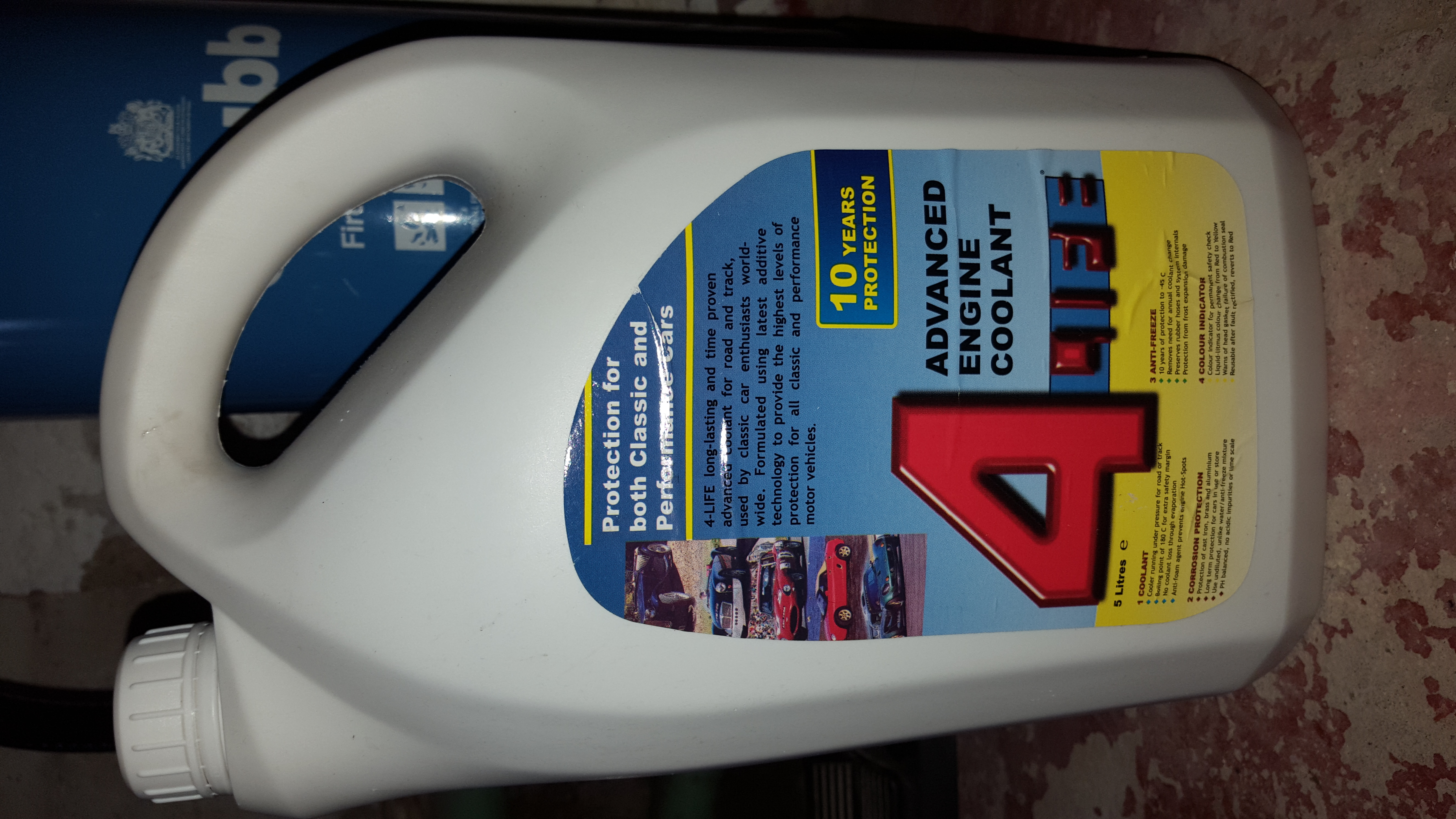

Any of yous ever come across '4 Life' coolant? My Panda came with it already in the engine and the car took forever to get up to 90 degrees; would often run at a steady 70 degrees and that's in summer/early autumn temperatures! Has all the hallmarks of a permanent open thermostat but I've my suspicions that it might be the 4 Life coolant as I recall reading about some similar stuff years ago that was designed to keep the engine cooler.
Anyway, changed the coolant today for the 50/50 blue glycol stuff along with the 'stat and top hose. 'Stat looked as though it had already been changed in last year or so as it was clean and shiny compared to the rest of the engine. Good result though as car heats up normally and sits at 85 to 90 degrees just as you'd expect.
Didn't want the 4 Life despite its great claims after some Googling found reports that it can leak through gaskets and joints alot easier than the bog standard stuff! :( Doesn't bother me to change coolant every two years and I certainly don't want unnecessary leaks.
Would like to hear if anyone else had used this and what affect it had?
I've a full 5 litre container of the stuff still sealed if anyone local in N. Ireland wants it for free they can come and get it. It came with the Panda when I bought it and I'll end up selling it on Gumtree or somewhere just to get it away. I hate waste so would rather someone got use out of it.:D
