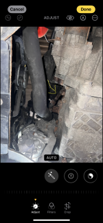

2015 KA with the Fiat 1.2 Engine. It has a coolant leak somewhere near the Water pump/Thermostat to the right of the engine looking from the front.
Hopefully attached picture shows general area but is there any usual suspects I should be checking ?

Two common places where coolant can leak are (1) the thermostat housing (many, but not all, have a plastic spigot which cracks; replace with a metal type if you can get one) and (2) the black metal coolant pipe coming out of the back of the water pump, which often corrodes badly and then leaks.
These engines are very prone to HG failure if run low on coolant; this often happens before the overheat warning light comes on and may not even register on the temperature gauge. I'd advise you to get this sorted before driving the car again.

The water pump is driven by the cambelt (so you have to disturb the belt to replace it, and would generally change both together), but you can change that metal pipe without disturbing the belt.
My money is on the thermostat housing, though; it's the first place to check.

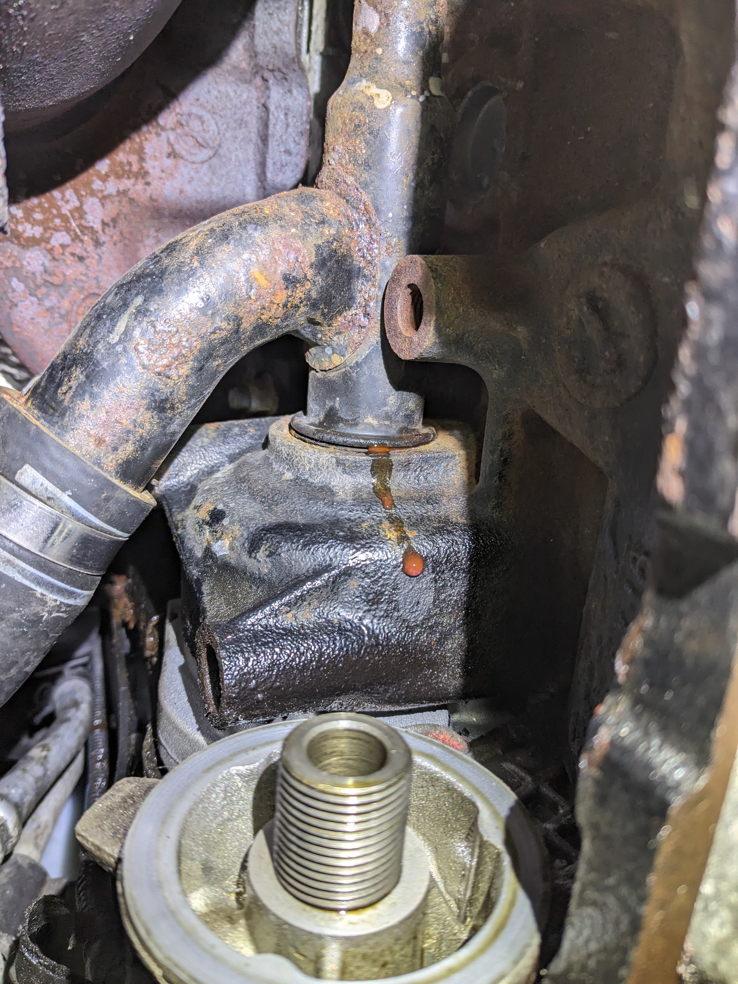

This was my leak on 2008, 1.4View attachment 449388. Easy to check with oil filter off.
'Mornin fellow countryman. Looking at the rust on it, I guess you changed the whole pipe? I find they're a bit of a struggle to get them into the hole in the back of the water pump casting.

Yup. Replacement pipe has integrated seal, but did clean the housing first and smidgeon of silicone grease. No lube applied to the seal.

I couldn't get enough on the pipe retaining bolt to remove. All off the front and easy with the impact wrench.
So therefore... A/C rad. and seals replaced.
Mine too, 'specially as the leak's at the clutch end of the engine.

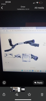

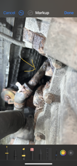

Hi, could anyone please help me. I’m at m wits end, we put our car a 2016 Fiat 500x in to get fixed yesterday and we’ve been told it needs a new water pump but that the small black metal pipe coming out it is completely rusted. He called Fiat and they said they don’t have the part so we’ve been told the car is done! We can’t afford to get another car and only months ago it needed a new clutch only having done 40k miles, this cost £1000. It’s been one thing after another but the mechanic has said unless we can find the part then the car is useless. He doesn’t know what this part is called and neither do we so I don’t know if I am ordering the correct things, if I upload pictures could someone please help. It does sound like what some people are having issues with above. Our Aircon system doesn’t work either we paid £400 last year for a new compressor and re gassed it and it all disappeared. I’m wondering now if this is where the leak was? Any help would be appreciated I have attached some pictures.

This pipe is easy to get for the 500 (shop4parts have it), but they don't list anything for the 500x. You could try giving them a call anyway; they may be able to help.

If the timing belt is disturbed for any reason, it should be replaced, since the tensioning procedure is designed to set the tension correctly only if a new belt is used.
But if it is just the metal pipe that needs replacing, then there is no need to remove the water pump or disturb the timing belt.
