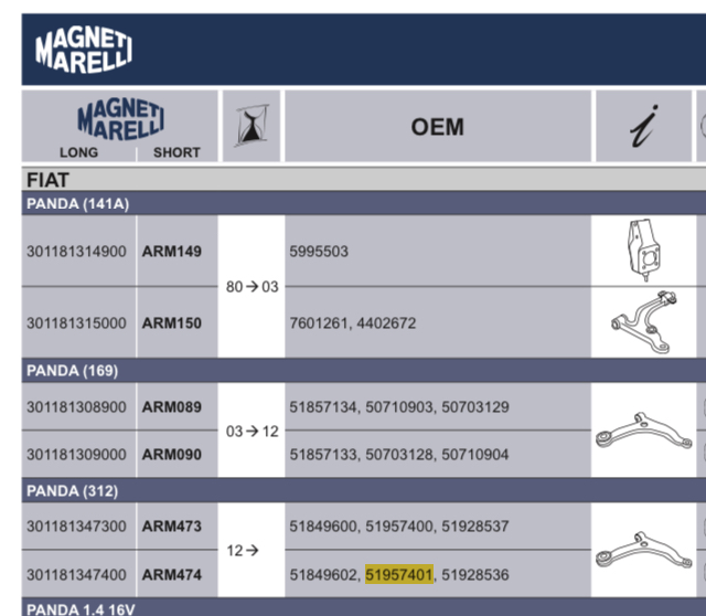

I wondering if any of you guys can help!
I've got a 2018 Panda Pop. Its done over 70k and the control arm rear bushes are beginning to separate. I've been doing a bit of research into replacements. What I've found is most web catalogs show arms that go up-to 03/16 construction year. Nothing for post 2016. I can't find anything on the internet aside from a used one on eBay. I've messaged ZF aftermarket and they drew a blank. My question is, whats likely to have changed after 2016? I can't see the overall design and bushings to have changed??
MK3 2012-2016 O/S 51957400 N/S 51957401
MK3 03/2016 O/S 52013959 N/S 52013960
I dont really want to pay sky high fiat prices for what will most likely be Lemforder parts as i've seen their stamp on the original arms.

Molar only list one 2012 onwards
There’s only one listed in M/M catalogue
