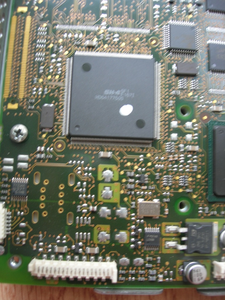

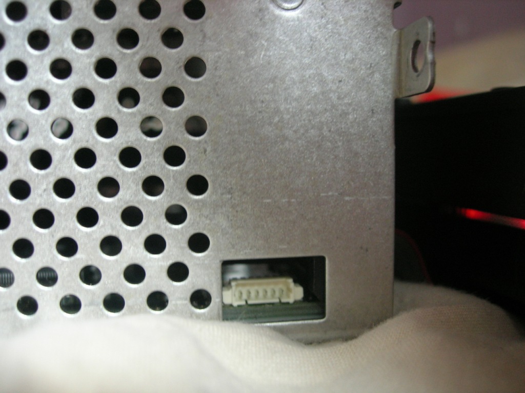

JTAG is a great solution but unknown for me so far on connect nav.Do you have any picture which socket?What processor you have on the mainboard?On mine is SH4.Please look on the picture attached.I have white 6 pins port on the left.How you will numerate the pinouts from left to right or right to left.?
