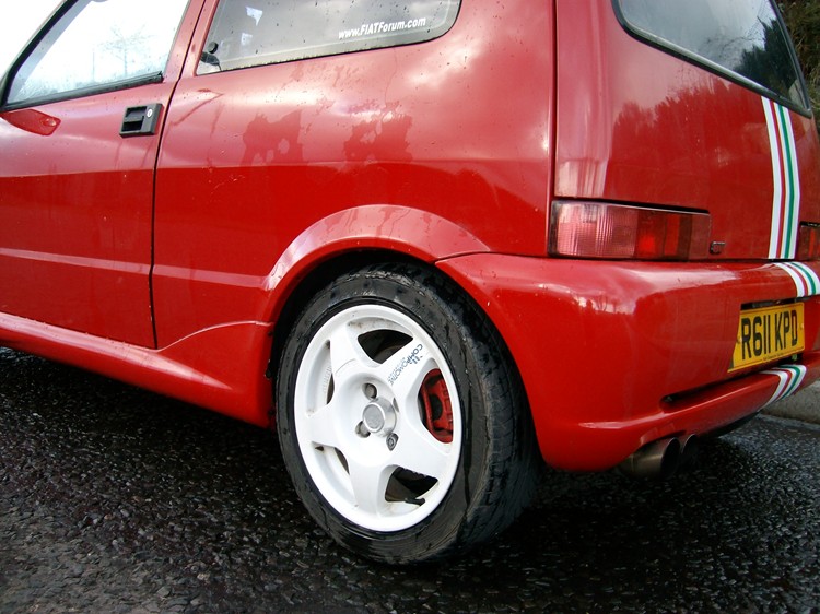

or you could just look at my car in the garage if you want to see 14x6 mo's on a cinq ;)
heres a pic of my car
mo's suit the cinq well imo, better than any other compo design ;)
