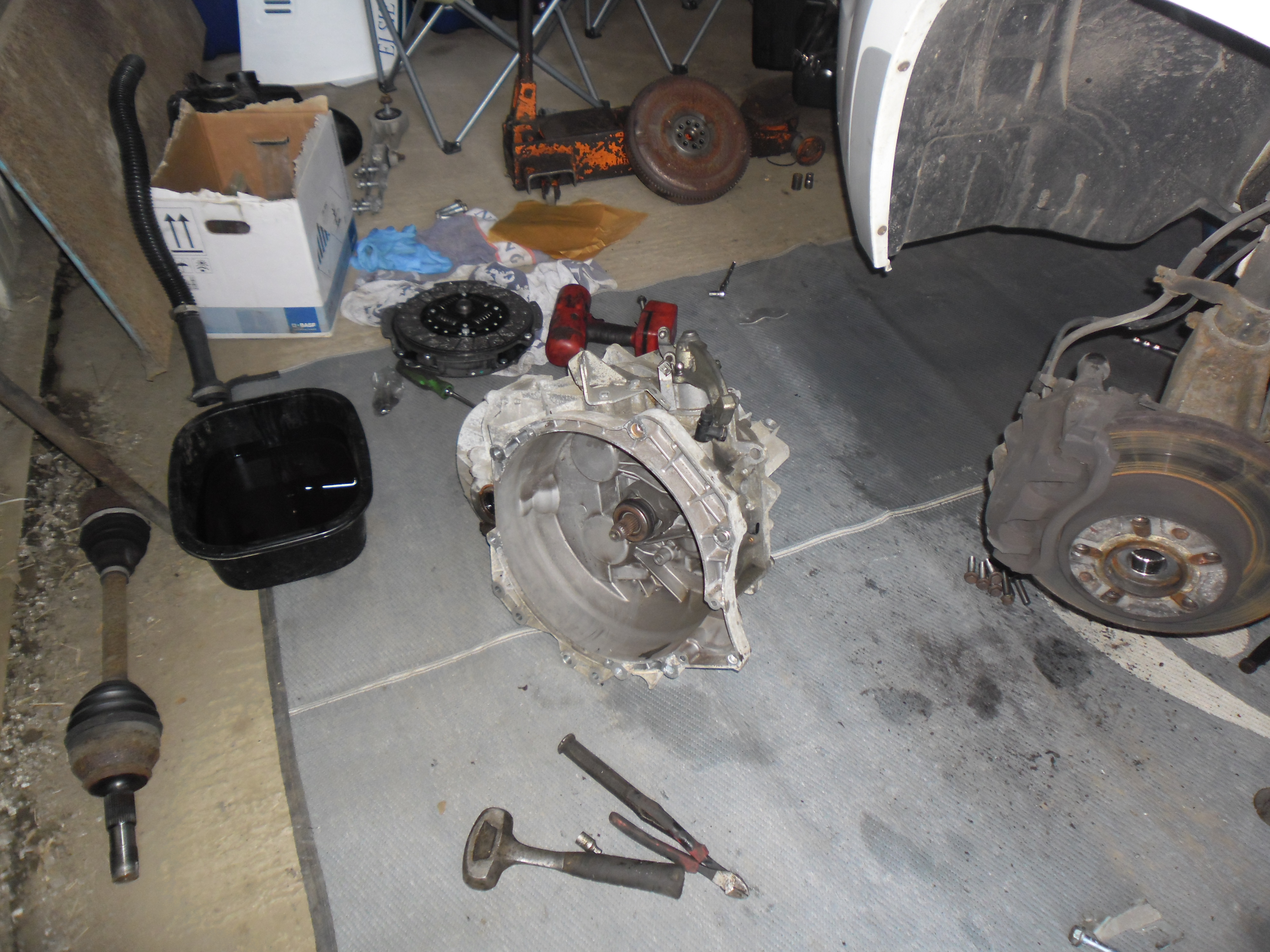

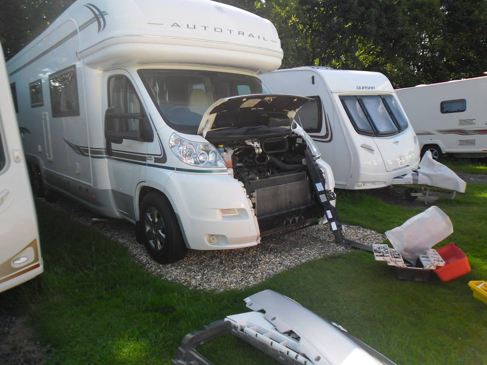

hi you need to get jacked it high enough to to get the gearbox out from under the bumper we stood mine on stands the gear selector was left on the box the engine has to be lowered enough so the box passes under the chassis but needs to be turned so the selector can pass underneath dont forget the 2 little bolts holding the conversion plate between the engine & the box should take you about 3 hour max ( 2 men )as you can see the slam panel has to come off
