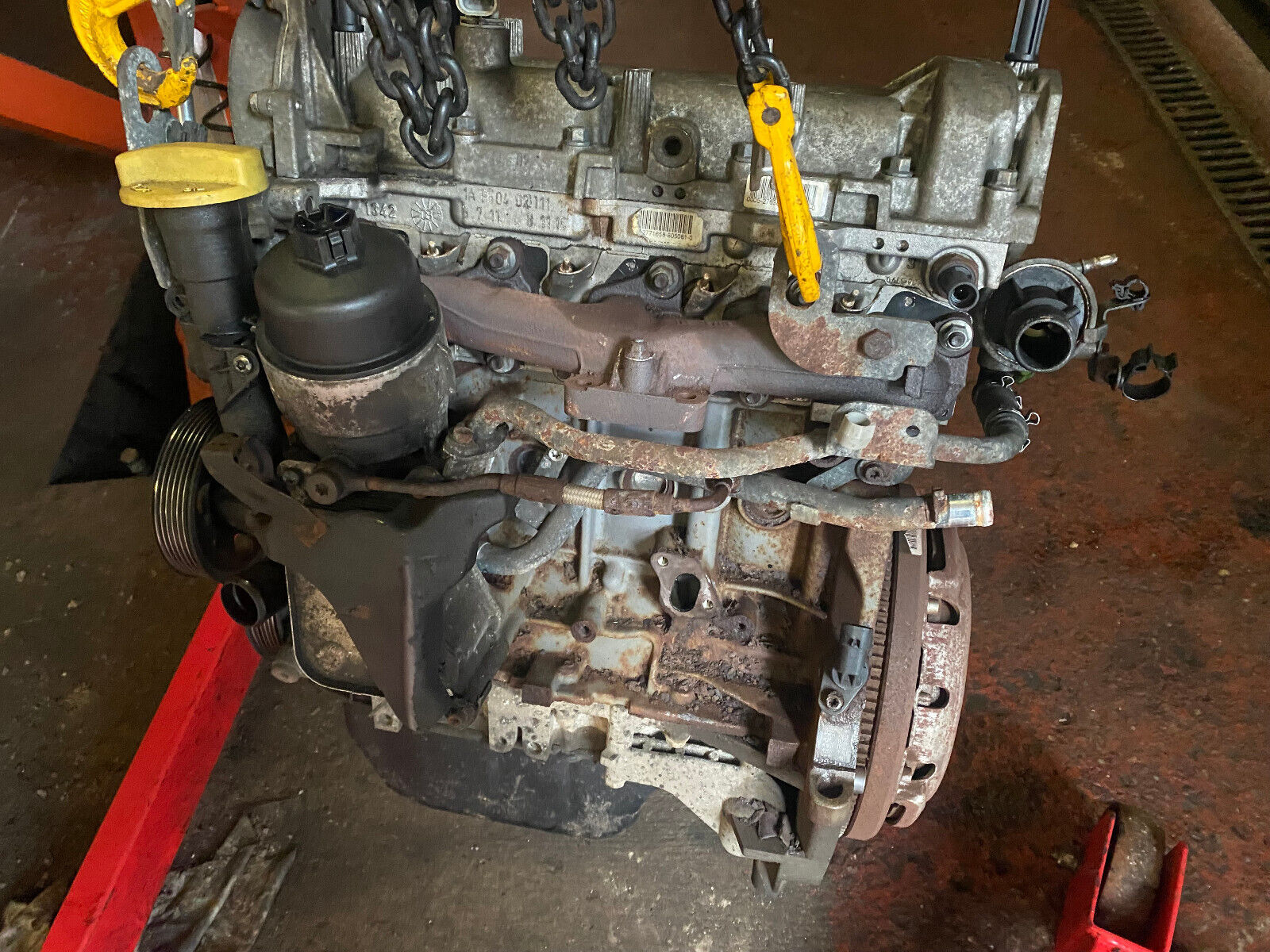

M Mr Posh Member Joined Jul 28, 2021 Messages 58 Points 66 Jun 3, 2025 #1 just a quick one Does anyone know the location of the crankshaft sensor on 2015 Vauxhall combo 1.3 cdti with fiat engine Cheers Model Combo D Year 2015
B bugsymike Patron member Joined Jul 2, 2022 Messages 13,797 Points 5,465 Location Torbay Jun 3, 2025 #2 Mr Posh said: just a quick one Does anyone know the location of the crankshaft sensor on 2015 Vauxhall combo 1.3 cdti with fiat engine Cheers Click to expand... On the older ones it is on front of engine facing flywheel, bottom right of photo, not sure if later one is the same or not. Had a quick feel on my 2014 Combo 1.3MJ and there is something down there. Attachments 1748975215298.png 3.5 MB · Views: 66 Last edited: Jun 3, 2025
