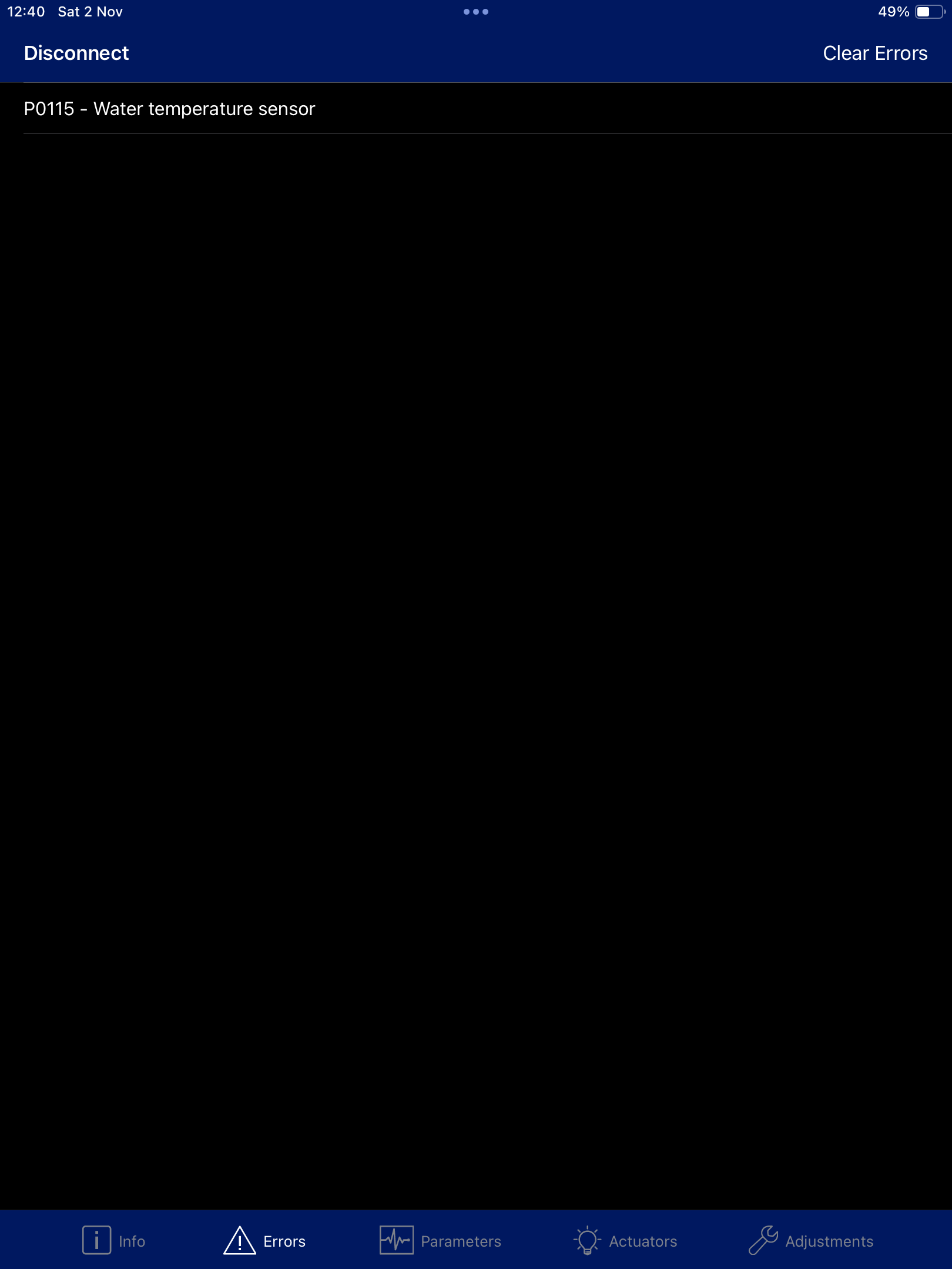

That was a good suggestion trying to get some working diagnostics. Gendan weren’t able to deliver internationally, but I found a local supplier. Ran Multiecuscan with a OBDlink MX+ interface which showed fault code P0115 - Water temperature sensor. So we have something to work with now! I’ll do some investigation which part to replace, if you have some information about this already that would also be nice. Thanks.

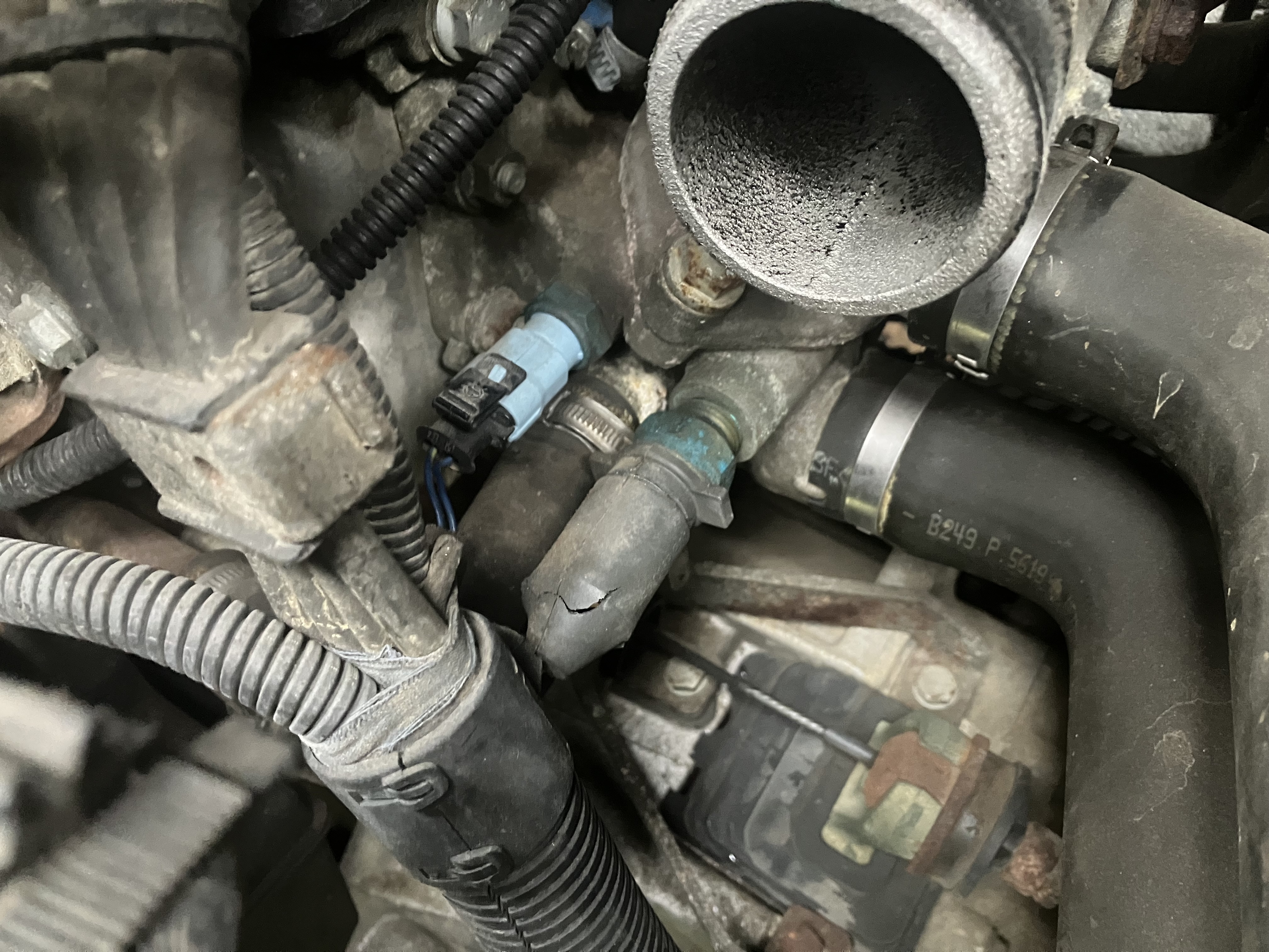

The 2.8jtd has two temperature sensors. One is for the temperature gauge and warning light, while the second, which may be faulty is connected to the ECU. This second sensor is the smaller of the two. It has an M12 x 1.5 thread, and measures 19mm over the hexagon flats.
The sensors are almost completely hidden behind intercooler air hoses, but a sneak view may be obtained at the vehicle LHS of the engine. On my RHD x244, I was able to remove the air inlet hose, air filter, and housing. ("Clik" pliers required for hose clips. Swivel headed type easier to use.) With the air filter hosing removed I was able to get my head in and reach the slightly nearer gauge sensor. The ECU sensor is slightly further towards the RHS of the vehicle. I do not know whether the brake servo, on a LHD model would affect access. For a straight on view you may to need to remove the intercooler hoses, which could have special clips.
My problem was with the gauge sensor, as the gauge was indicating normal with a cold engine. I checked with a new sensor held in an earting jump lead, and connector transferred. All OK. Rechecked with original sensor, still OK. Used contact cleaner for good measure, and refitted all components.
I advise trying something similar before removing original sensor.

That went rather smoothly this morning. Just to be sure I replaced both temperature sensors (around 25 euros in total).
Needed to remove 2 air hoses, with a 19mm and 22mm spanner the sensors were easily replaceable. Lost only 100ml of coolant, that was easily topped up again. Some before and after pictures are added.
Cleared the fault code, did a test drive. Starting issues were not there anymore, engine was also running very well. No new error codes for the moment, so it is looking positive. Planning a trip next week, I’ll be able to do some more thorough testing.
