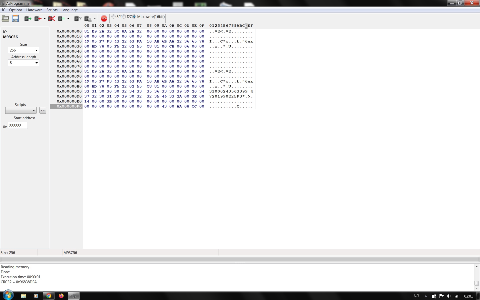

Is the emergency start code stored in the codebox eprom and can anyone identify it (and the current key/chip codes) from this eprom read? 93cl56b

the original key has a #2 on the blade so assuming code2 type key? (no red key)
from what i can gather 0000-0003 is key one 0004-0007 is key two (repeated at 8000-8003 & 8004-8007) but what is the emergency start code?
autodata says upto 8 keys can be programmed i guess this would be in 4 byte intervals between 0008-100f repeated at 8008-900f, can additional rfid chips simply be added to the codebox via asprogrammer or is there a pairing procedure/keycount in the ecu?
