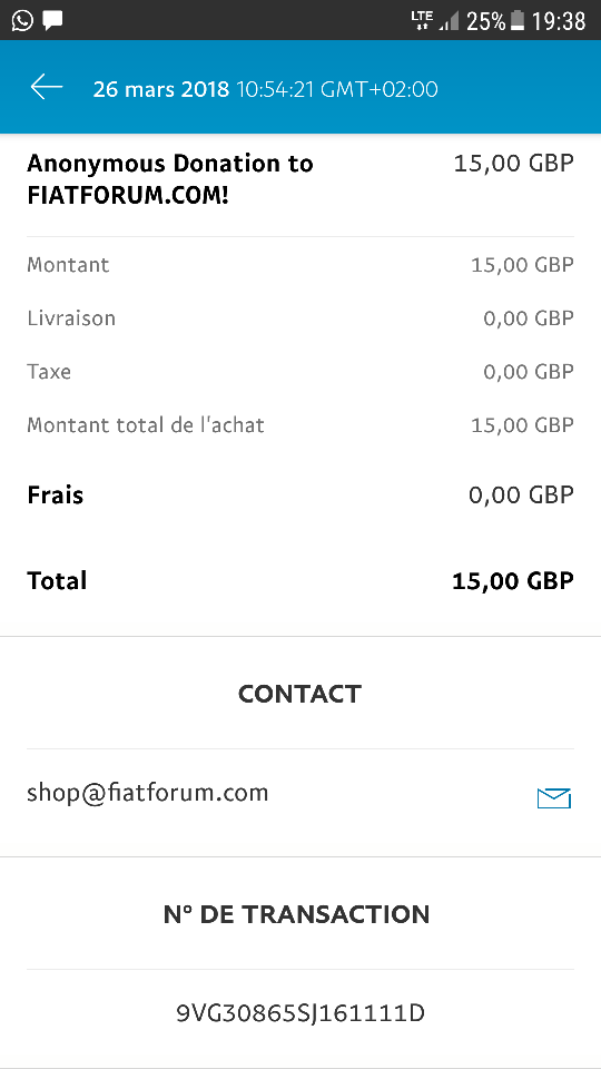

Hej,
Payment is posted anonymously!
here is the proof of the £ 15 paid
could you change my account status?
thank you

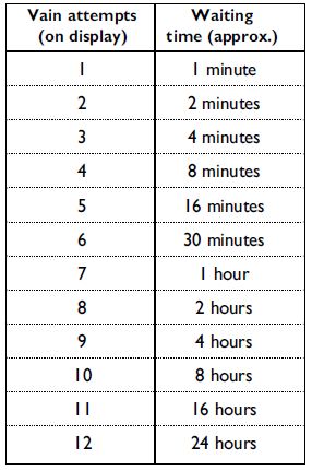

thanks, now the radio stays on radio block / wait! What to do???
The radio is showing the block / wait message because someone has tried wrong codes too many times. You need to leave the radio and ignition switched on continuously until the message clears.
Depending on how many times a wrong code has been tried, the waiting time could be up to 24 hours.
