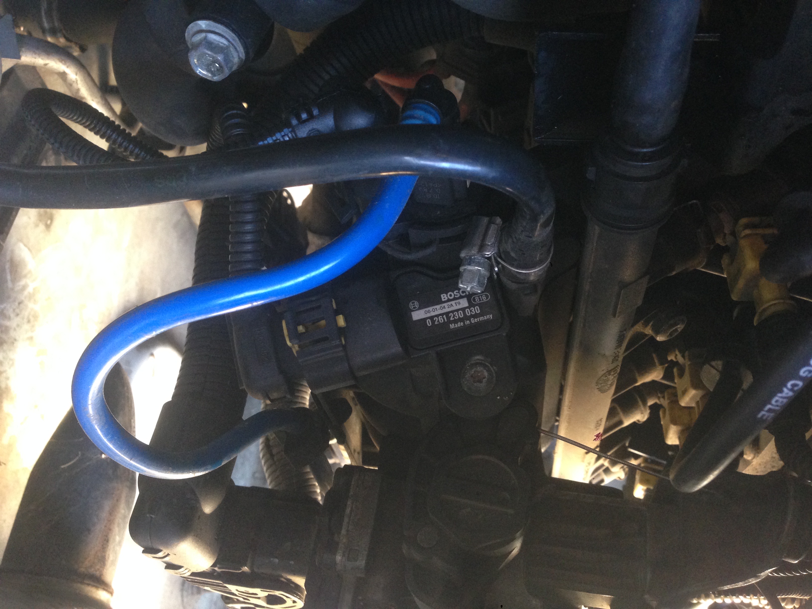

Just for clarity when you have a chance could you please post a picture of the solenoid valve you replaced in situ on engine. I have a feeling this problem will occur more often.

Hello Alan, I would like to see a picture aswell in case mine isnt fixed with my cracked airbox repair, I havent even found my 'Evap' cannister yet.
Here it is. Is the one at the end of the blue line, fixed into the manifold under the MAP sensor.

Kevinpanda The evaporation canister is at the back of the car, inside the offside rear wheel arch and connected to the fuel tank. It is connected to the solenoid (at the engine end of things) by a plastic tube running the length of the car, following the same route (more or less) as the fuel line, brake pipes and exhaust pipe. The function of the canister is (perhaps surprisingly) to minimise emissions of petroleum vapour evaporating from the tank when the car is parked, and is basically a large charcoal-filled filter. (Item 1 in this diagram https://www.fiatdalys.lt/en/catalog.../ZFA31200003210975/0/0/0/fuel-emission-filter)
Herts Hillhopper That is correct, the charcoal canister is in the back of the car.
I've put in the previous post the pic with the solenoid valve as that was the subject of discussion, that is the one Alan changed.
Thanks... (I was answering Kevin's comment that he'd not even found the evaporation canister...)
By the way, your photo also provides the clearest view yet of the fabled 'duck bill' drain from the scuttle (the subject of many a previous post about water getting into the footwells)
Yeap, you are right, it is a clear view. I didn't even pay any attention to the duck bill drain (in the photo) untill you've mentioned it.
Thanks for the image, unfortunately mine is not there, but now I know what to look for I will try and find it in the morning, my Panda is a different year but wont be to different. Thanks again, Kevin.
