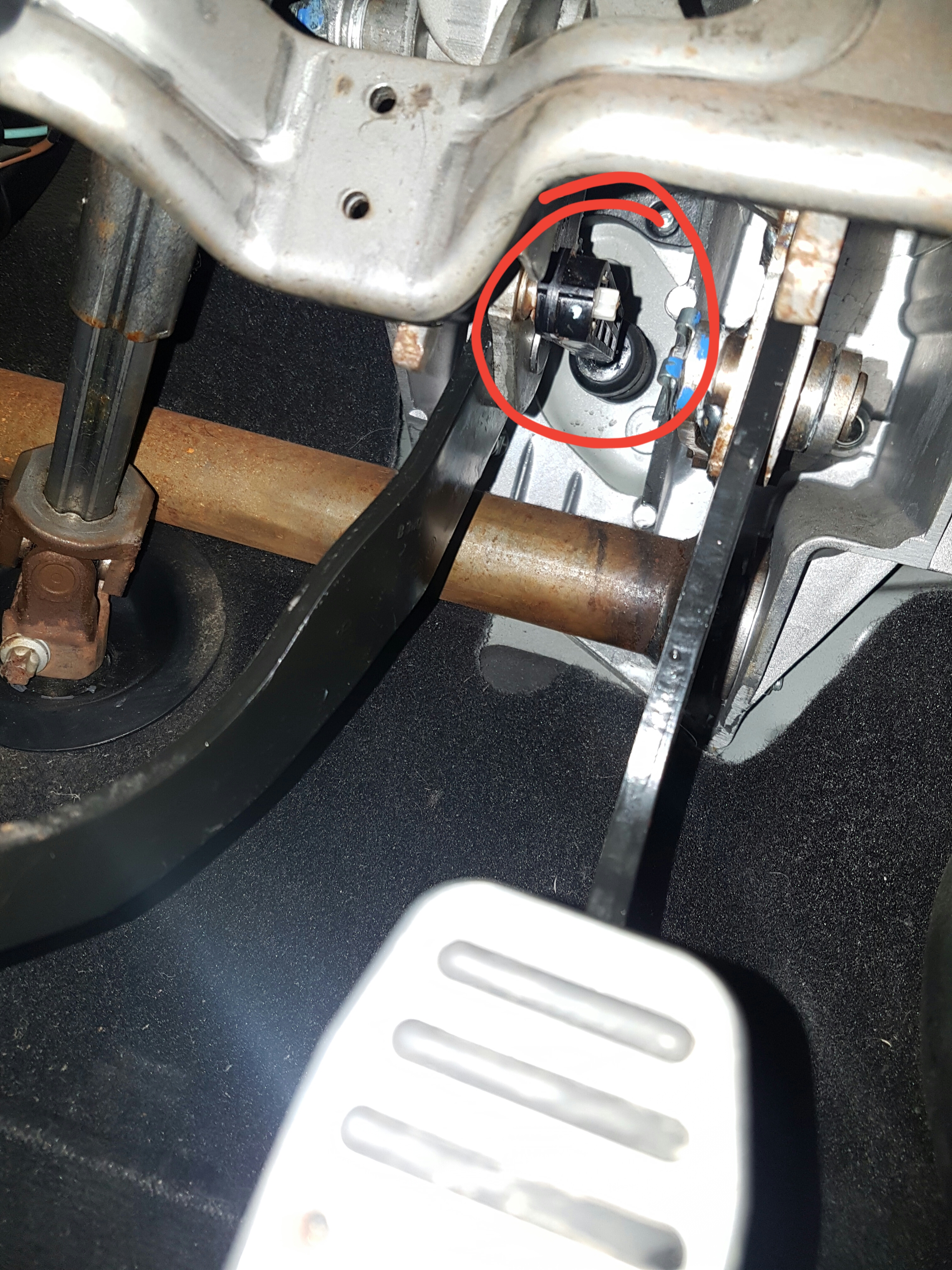

The other night i was driving on motorway and when going into 6th clutch pedal hit the floor and didnt come back up.
After a bit of fiddling found that the master cylinder rod had come off. When looking at this i found a tooth on the white plastic has broken and this is causing the rod to keep poping off.
As this is only a piece of plastic which is broke i dont want to pay for a whole new rod. Does anyone know where i could buy just the clip?
Ive circled in red the rod i mean.

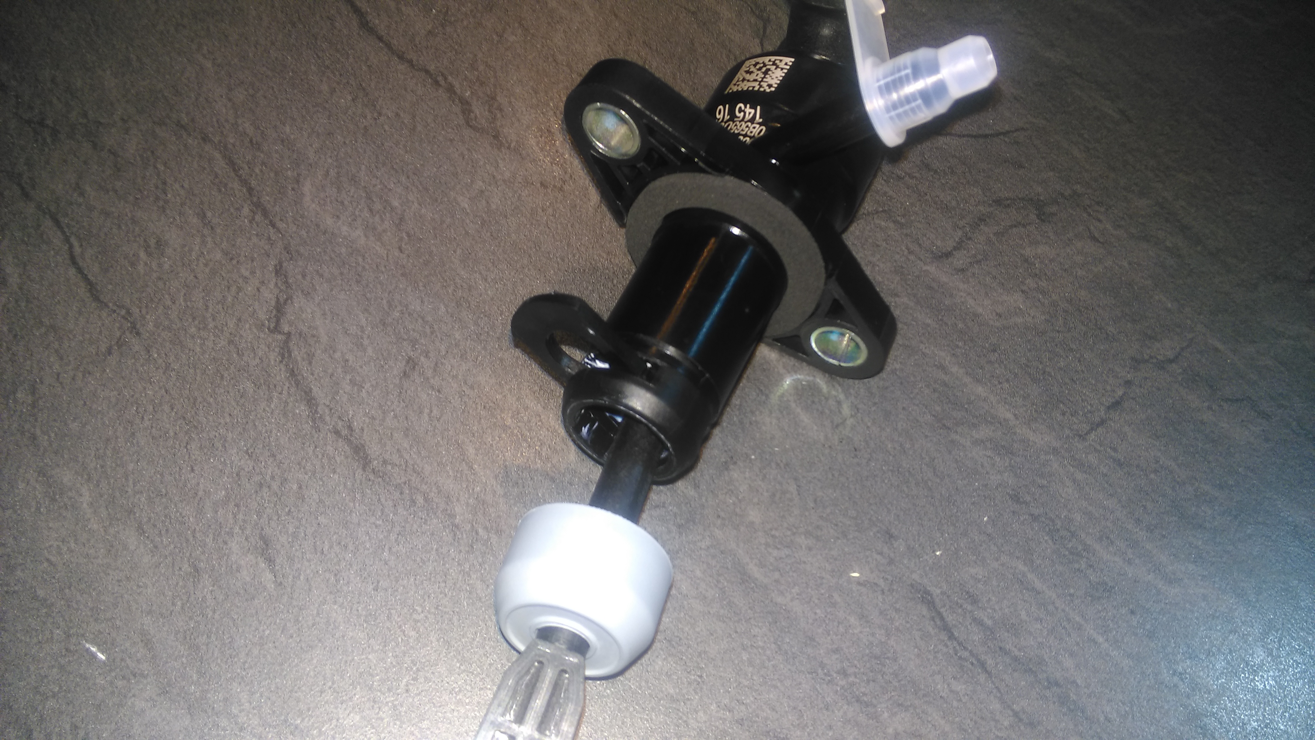

Evening chaps. I had the same issue as above so bought a new part from Shop4parts for £49 delivered. Rather than replacing the whole unit I've taken my new one apart as shown in my pictures and will be doing this at the weekend and doing the same with the unit in the car and just replacing the shaft bit.

I was curios so I vent out so I could have a look at that white clip but where is it? Is it down on the floor or somewhere up at theclutch pedal ?

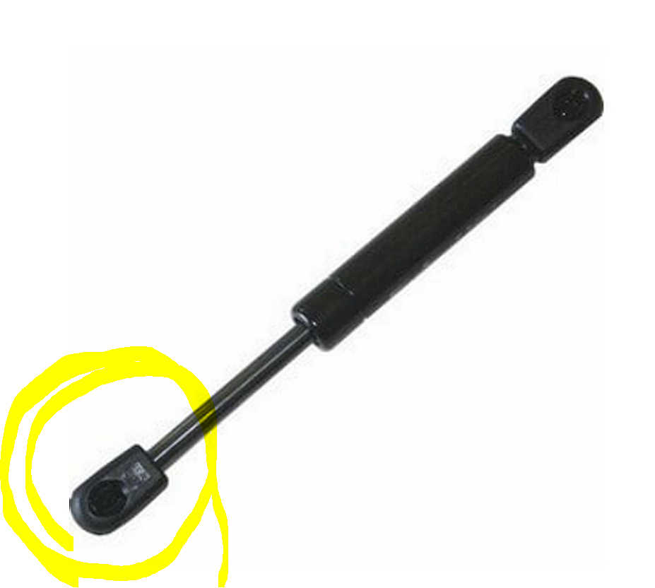

Must be possible to get these 3D printed... Anyone got one without a master cylinder attached?
I've got questions :
-does the clip go on a ball?
-how big the the ball part on which the white part clips on to????
If it's the classical 10mm size, you could possibly use the part of a hatch lifter ( it unscrews 8mm thread); cut/break off the plastic on the original clutch rod, thread the rod; thread in the head from hatch lifter strut.. and that's it..
A lot of unknowns, but if i had to do it i would try.
Might not work
Also:
Do all the Bravos use the same type of master cylinder?
Maybe you could get a different one, and with minimal modifications get it to work. and be fail-safe for the future ( at least no more plastic clip).
Might not work
Also:

Right I've fixed mine today. I'd bought a new part from shop4parts and today removed the white female ball holder clip that fits into the long arm of the cylinder from the new part and the old part. They are virtually the same except the new part has two location type lugs that prevent it from pushing right into the black rod. I had to buff these back and worked straight away. Just make sure you when it's located on the ball you then push the arm so the ball and clip are fully inserted and clicked into place. Apologies for no pics
