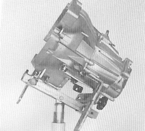

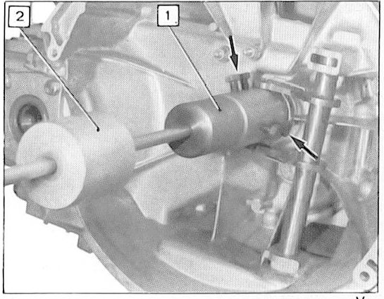

Don't know the situation without having seen the gearbox/bell housing itself, whether this will be of any help but maybe a welsh plug or something similar might be the answer if you can get one the correct size. Or is it possible to drill a hole across the pin hole & put a roll pin in to secure it remembering that it must be able to be removed again so can't be a blind hole - is this possible from the pics if this is your box ??? From your last post it isn't as the pin doesn't go through to the top of the box. The only other type is the newer 244 2.8 type - also a diagram attached.
Attached are 2 pics of the an "early" Ducato gearbox & clutch pin assembly I could find in the info I have, probably not even be the same type of gearbox. Also attached a diagram from the elearn Manual for the 244 model.
