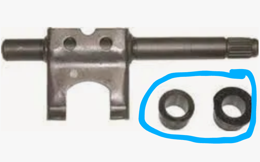

If you are talking about these
There designed to be self lubricating PTFE impregnated
Shouldn't be anything on them

It’s a 2004 model and the clutch was done about 8 years ago by myself but at the time I lubricated the fork bushes with some molybdenum disulfide grease from loctite.
So next time with a new clutch and slave cylinder, it’s probably best to leave the fork bushes “dry” due to them being self lubricating? I did look at the e learn manual and there is no mention of lubricating them.
