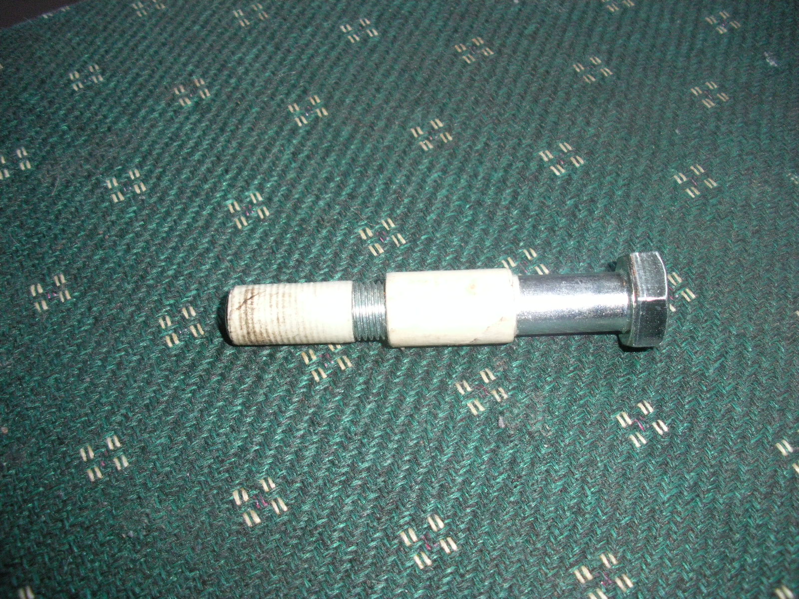

Clutch centering tool MKII
Masking tape wrapped around a bolt. Tape can be added and removed to get a tight fit.
