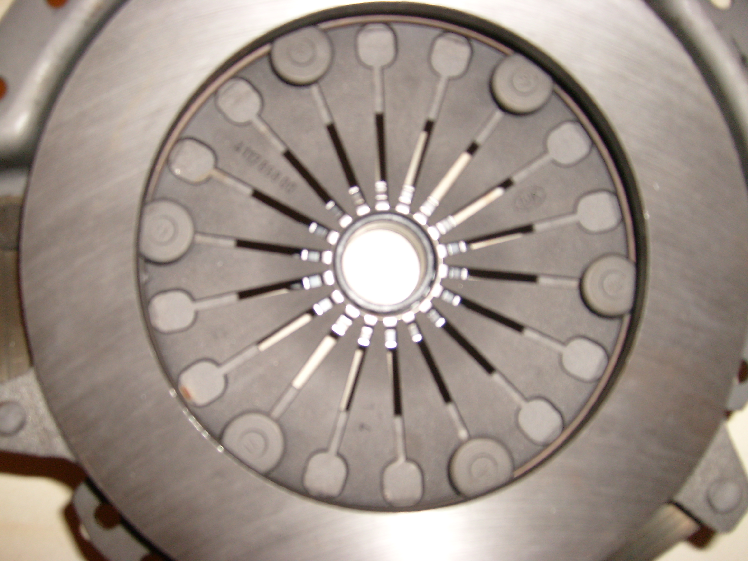

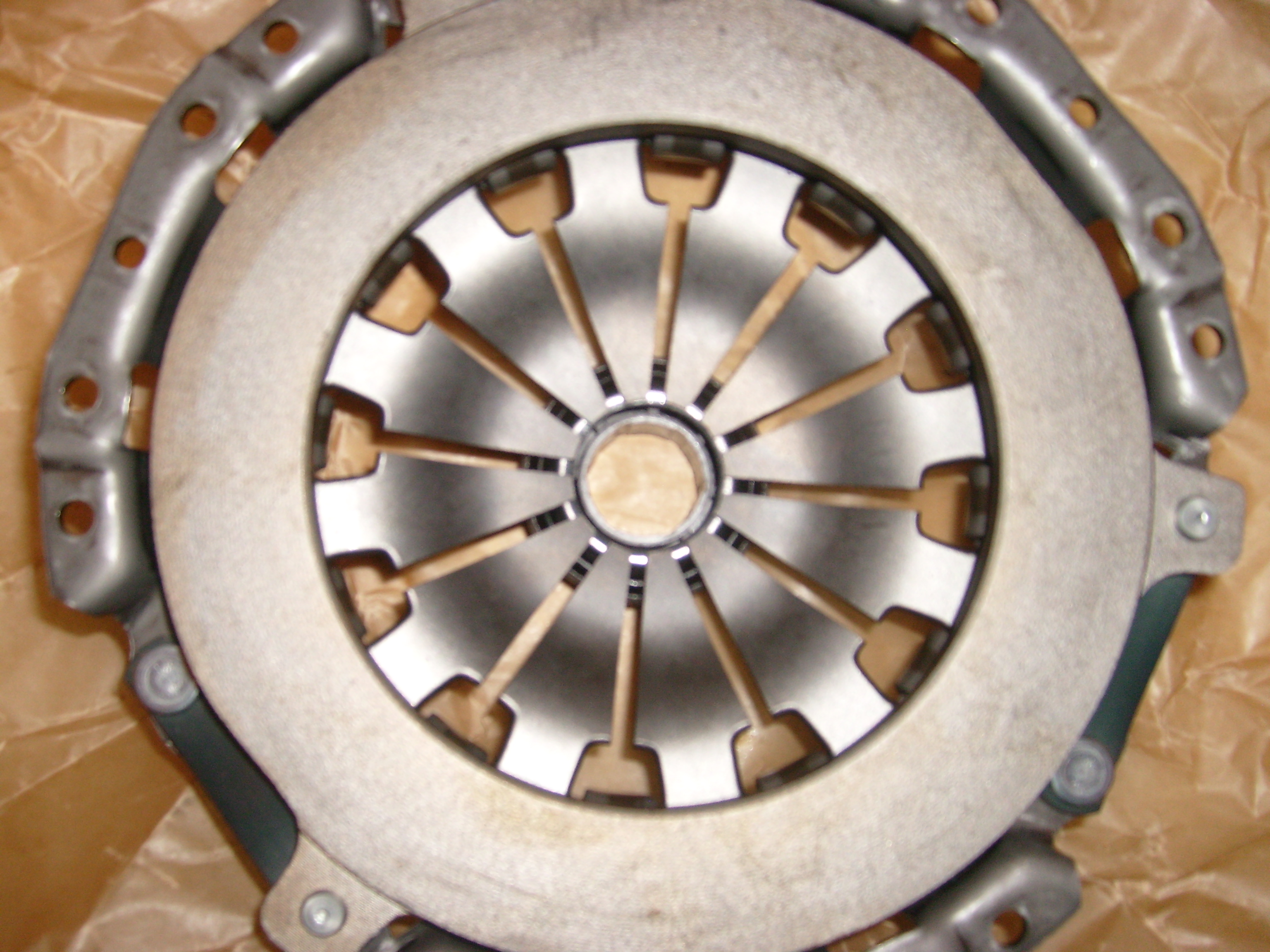

LUK and cheap ones. Release bearing will go throught the pressure plate quite quick.
....LUK and cheap ones. Release bearing will go throught the pressure plate quite quick.
I'm avoiding LUK -I've seen the horrible photo's of the fingers (no, not that one ;)). I wondered about the Transmech kit.
