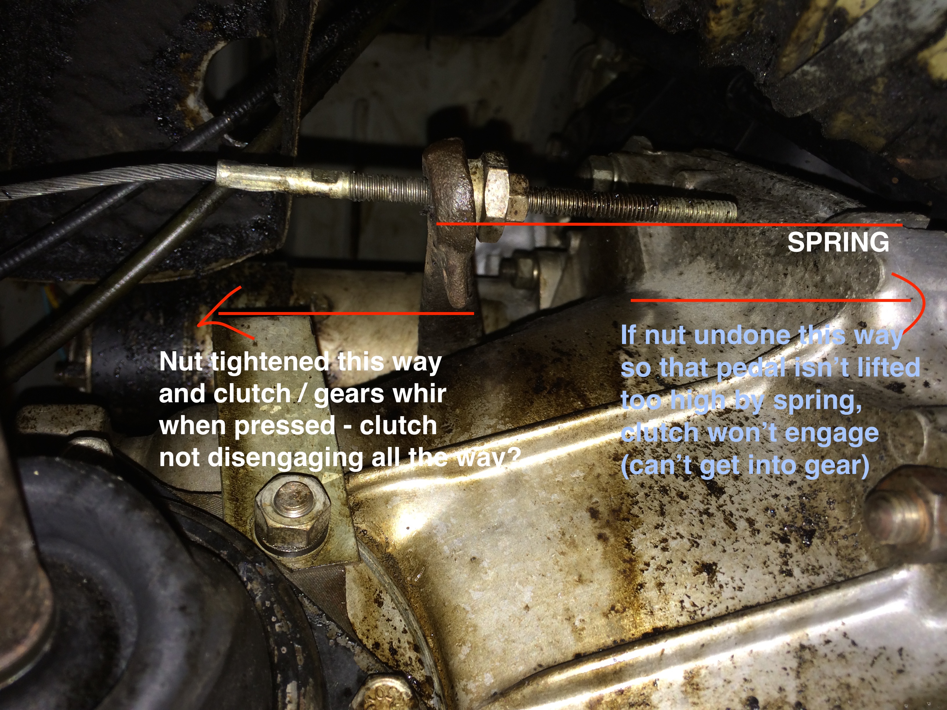

Sigh. So amongst some other parts I received my clutch spring thingo last week. Today after washing the car I thought, "let's spend 5 minutes putting that spring on".
Jinxed myself.
1.5 hours later the spring is back in the box it came in.
Essentially when I fit the spring to a correctly adjusted clutch cable, the pedal ends up almost at the roof of the footwell. Ie I have about 20-30cm of free travel before the clutch engages! Obviously if I adjust the nuts on the cable so the 'lollypop' sits closer to the spring, I end up with a clutch that doesn't ever disengage and I can't change gears.
Probably at the point of leaving well enough alone, but curious if anyone else has had something similar?

My instinct is that you either haven't actually got the cable adjusted properly or that the spring is somehow in the wrong place.Ahhhh ....photo needed please.
Is there any or much threaded rod still available on the adjuster at the forward side of the clutch actuating lever?
Ah my terms are not always accurate as such. When I say the clutch is adjusted correctly, I mean that it's at a point that it works!
The nut and lever are basically in the same place as the images on the prior page:https://www.fiatforum.com/500-classic/440086-clunking-grating-while-shifting-2.html?p=4288846 as I found that if I brought the lever much closer to the frontside of the threaded rod, I didn't engage the clutch fully, and if I undid the nuts and ended up with a lever nearer the centre of the rod, I couldn't activate the clutch.
THe spring is running from the small hole in the end of the clutch lever to the little notch in the metal bit on the far right in the first image.
I'm wondering if my cable is too short and so the pedal is pulled higher when the lever is in a position it is meant to be. Would that make sense?
Not sure if this helps!
Basically when I pull the clutch lever all the way to the rear of the car by hand, to emulate what the spring does, I end up with a pedal at the roof of the footwell and 20-30cm freeplay.
If I adjust the nut towards the back of the car, giving more free cable so the pedal sits at about the brake level, it then becomes all free play and there's no resistance at any point of the pedal depression.
Adjusting the nut further forward I think brings the pedal too low so the clutch can't fully disengage, though it's hard to tell.

Whatever position you have the cable adjustment nut in and whether or not the return spring is in place, move the clutch-pedal by hand from its highest point until you feel it meet resistance but before it gets really hard to push. If you can measure that distance of movement, maybe with a tape-measure based on the bottom of the steering wheel, it should between 35
and 40mm (Haynes). If it's more than that, which I think it will be, keep turning the nut further forward and see if you have sufficient thread to achieve that measurement. Ifcorrectly adusted there is no danger of the thrust bearing being constantly in contact with the pressure plate, which answers the other query.:)
Your clutch is likely to be the earlier type with coil springs and that might mean there are parameters that I'm not familiar with. But if you can't achieve a balanced operation with the above procedure it may be that something else is wrong. The absence of the spring in the first place might be a clue to that.:bang:

Whatever position you have the cable adjustment nut in and whether or not the return spring is in place, move the clutch-pedal by hand from its highest point until you feel it meet resistance but before it gets really hard to push. If you can measure that distance of movement, maybe with a tape-measure based on the bottom of the steering wheel, it should between 35 and 40mm (Haynes).
Thanks Toshi and Peter for the input. I'm a bit stumped as I've never seen a 'normal' one. I have a 63 D if that helps, and the carbon info comes from what the manual says applies to the D clutch.

1st video, your clutch pedal looks normal enough, seems to have approx. 25mm of free play. Don't know what's happening to allow the pedal to be lifted up so high. I can't remember if there should be some sort of stop bracket/tab to limit the upward travel of the pedal. How does the car drive with the pedal adjusted this way?
2nd video, there's something suspicious about the position of the clutch release lever! Usually with the clutch released, the angle between the lever and the cable is less than 90 degrees. As the clutch is operated, this angle increases to 90 degrees and more. There's a sort of 'over-centre' action involved. The pressure applied to the release lever is most effective when the angle is 90 degrees. As the angle goes much above 90 degrees, each mm of cable movement gives less and less movement of the release lever, so the clutch may not free fully causing gear crunching.
I wonder if a later diaphragm pressure plate/release bearing has been fitted instead of an older style coil spring pressure plate/carbon release bearing? Maybe the release lever/fork is not the correct one for the type of clutch fitted.
Some older Fiats used a release fork held to a cross shaft and release lever by a stepped bolt inside the bellhousing. Sometimes (rarely) the bolt can work loose causing the release lever to move through a greater angle before pressing against the release bearing to operate the clutch. The bolt eventually either shears off or falls out. Or maybe a regular bolt was fitted instead of the correct stepped type?
You might be able to check out some of the above by removing any cover plates/dust shields on the bellhousing or removing the starter motor, otherwise it's an engine or transmission removal in order to inspect.
