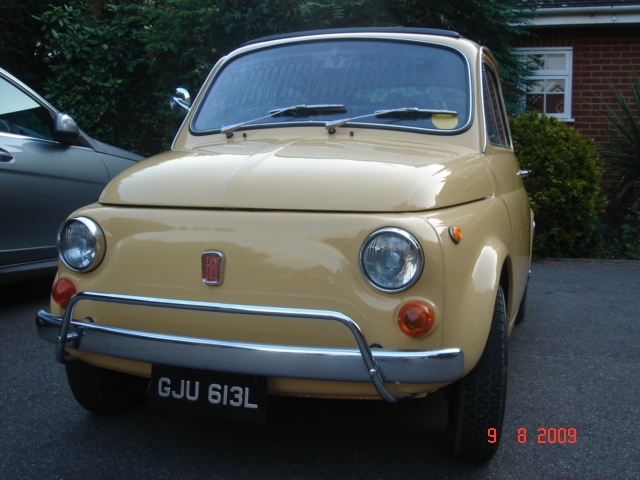

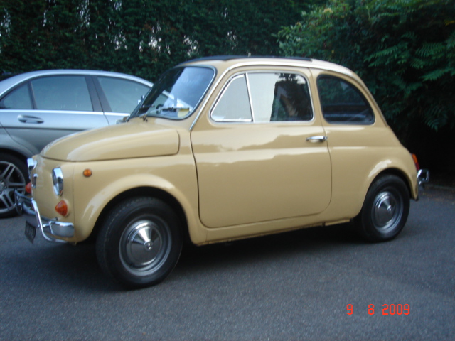

A picture of your car would be nice too! (y)

PS as requested a couple of photos

BTW, nice looking car - thanks for posting the pics!
I like the small Italian style front plate - where did you get that from?

Thanks for that. Plate was on the car already when i bought it.

nice 500 by the way
