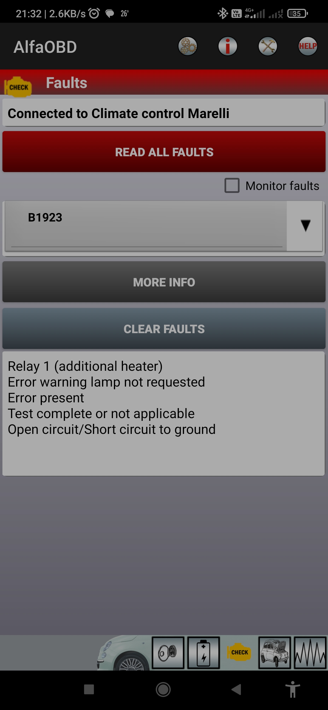

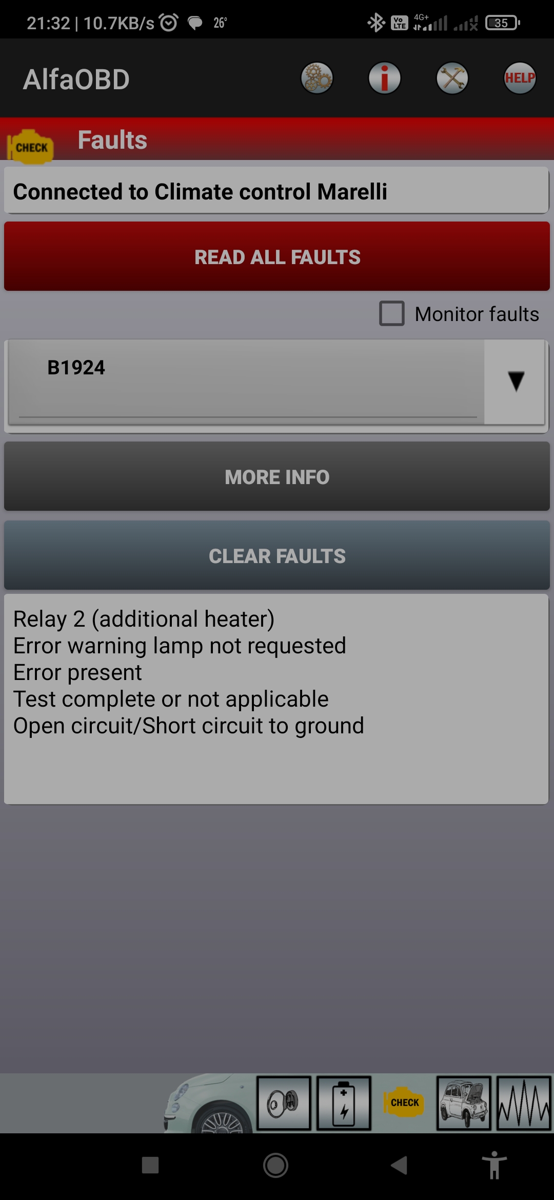

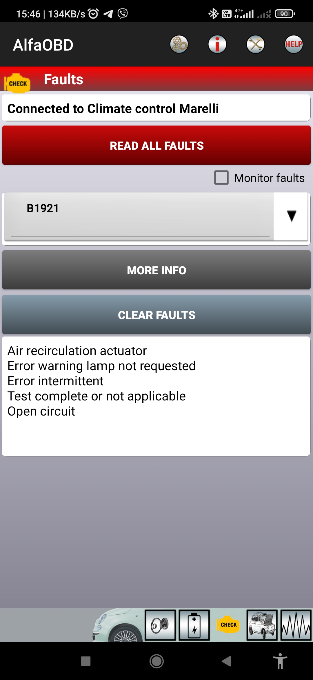

Hi guys,
I've changed recirculate actuator last Saturday with working used one. After diagnostics I've got the same errors like before change. Left mixer has dead motor and I'm planing to change it soon. But, my control unit start to be crazy - sometimes it won't operate windshield flap, sometimes operates only windshield motor regardless button presses, sometimes reports short circuit, sometimes reports right mixer and above all it won't replay to proxy alignment request. I've checked recirculate flap and it's stuck closed, regardless error delete and unit test and selflearn. Looks like Control unit didn't detect proper current of motor and it broke a lever again.
SO, any thots? Also, alfaobd reports potentiometer voltage 3,6V if I recall, should it be 5V?
And when it's full nuts unit reports additional heater error :) (which I don't think that I have)
Thanks

Hi, I have replaced complete hvac node and left mixer actuator and proxy aliment has passed and all but recirculation works. Still shows like open circuit to recirculator and in spring all replace all cabling. Also I've checked grounding wire for hvac and was fine. Potentiometer still shoes 3,7v but it works just fine. :)
Most likely hvac node was faulty also. I have had some issues with old one with max fan speed. Now it's flawless.
