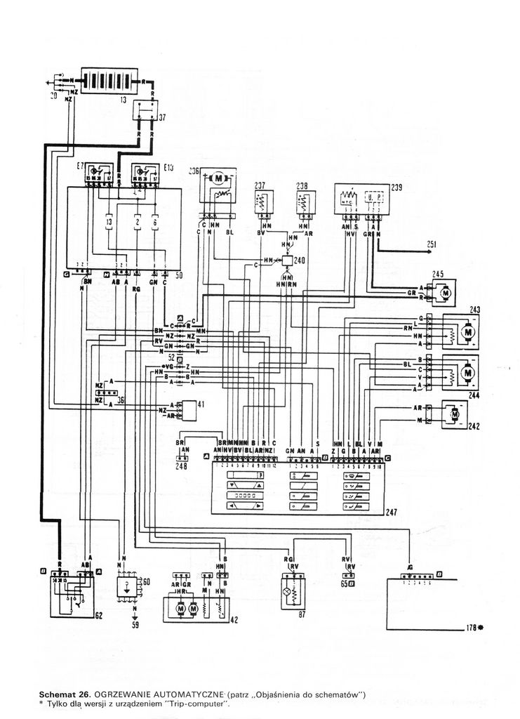

I've got a circuit diagram of automatic heating system. There are 3 temperature sensors labeled with numbers 236, 237 and 238.
Sensor 236 (sensor of air temperature in passangers cab with electrofan) is hidden on the right side of the steering wheel, behind little bars. It's really easy to find :)
Sensors 237 and 238 are hidden inside ventilation system, first one in right central diffuser, second - deeper then previous one. You have to unmount central console to get there and You'll easily find it.
See attached ;)

Thanks for that schema (I had it already). I've already checked 236, and 239 (hidden near ventilation motor above passenger legs) before weekend - it was good, now it is time for rest, when I will have some free time.

What does it mean? Is this question about something Polish? (I think my circuit diagram might be from Polish or Czech repair guide - I've got it from the Internet, I don't remember exactly :eek: )
Yes this is in polish. I was wondering if you are from Poland, because you have scan of diagram from polish version of repair guide. It means exactly "Does colleague come from Poland?".
