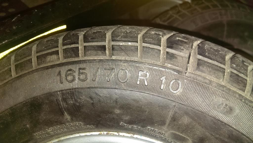

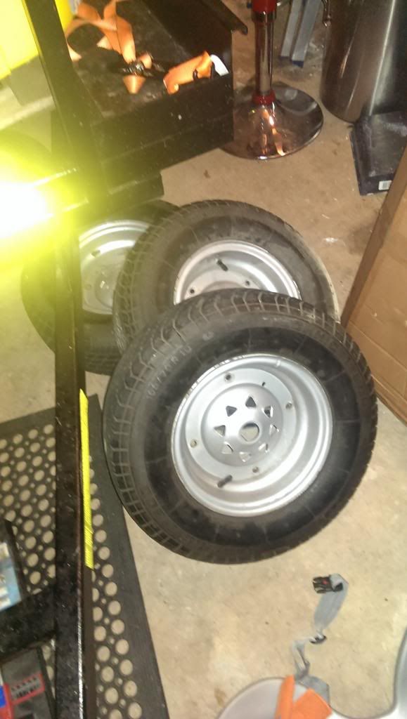

Well
The car is now painted in Campavola grey and I am still looking for wheels
Does anyone know of any companies who can carry out wheel banding?
Thanks
Mike

HI Mike;
Welcome to the Forum. getting steel wheels 'banded' in the UK is difficult these days as it is very much frowned upon, therefore I don't know of anybody who does it now. If you want a nice set of alloys that will bolt straight onto your car (they have 190 pcd wheel-bolt spacing) contact Nathan Robertson Fiat500classic (01536 500314)--when I spoke to him a few days ago he had a set (4) for sale. They do not need wheel arches to be widened to make them fit. If you want some wider wheel-arches, Middle Barton Garage will sell you a nice set of 'bolt-on' group 2 arches. However, be aware, they require quite a bit of 'cut-away and re-weld' work on the original arches. If you are not going to lower the car, I would suggest that you stick to a set of 4-1/2 inch wide alloys.

Not a problem if banded properly. Loads of people do it try banded wheels essex loads of my mates have used them and never had a problem most centres are held to the outers with much less.
Hi I have a set of steel dished wheel but they are 10" and will only work on the old style hubs and matching arches (so that they look right).
