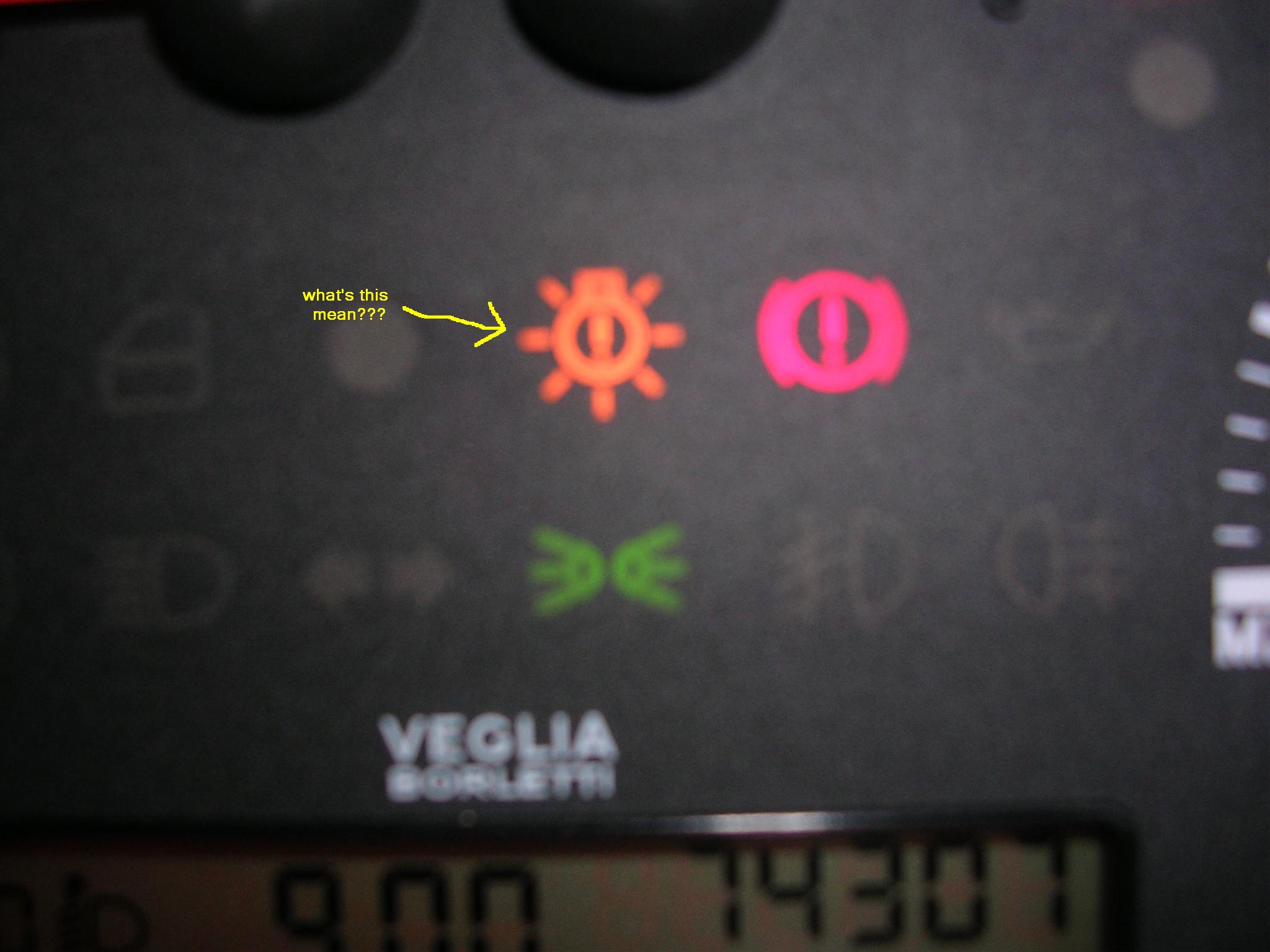

thats easy enough to test - if u can pull ur handbrake past 5 clicks on the ratchet its too loose (DOESN'T mean pull as hard as possible with 2 hands and snap it, lol) - it says in a haynes manual exactly how to tighten it up.
Mercia said:
Could it not just be a slack brake cable? I had the same problem recently and all it took was adjusting the brake cable and getting new rear shoes for wear as I left it for too long.
Mines kept flashing on and off mostly down hill sometimes on flat roads i got the rear shoes done also and handbrake tighten cured the problem..
