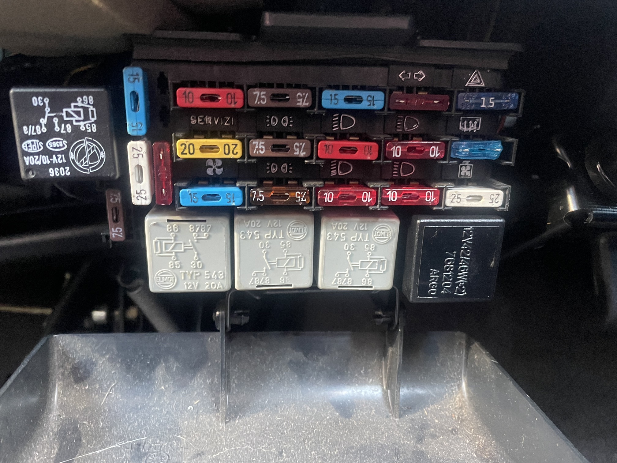

  • The relay (which is the black one on the left of the fusebox shown above the 7.5 fuse). It clicks when you go between position 1 and 2, and the local factors tested it and confirmed it seems fine
  • As per rallycinq's advise above, I took a multimeter to one of the headlight connectors and none of the 3 connectors are getting 12V when the light switch is in position 2.
Assuming I've identified the correct relay... what next?

For future readers:
It turned out that the fault lay within the indicator/light stalks. Fitting a spare set fixed it.
Also it’s not just the black relay on the left of the picture, but the bottom leftmost grey relay is involved. Regardless, all my relays where fine.
