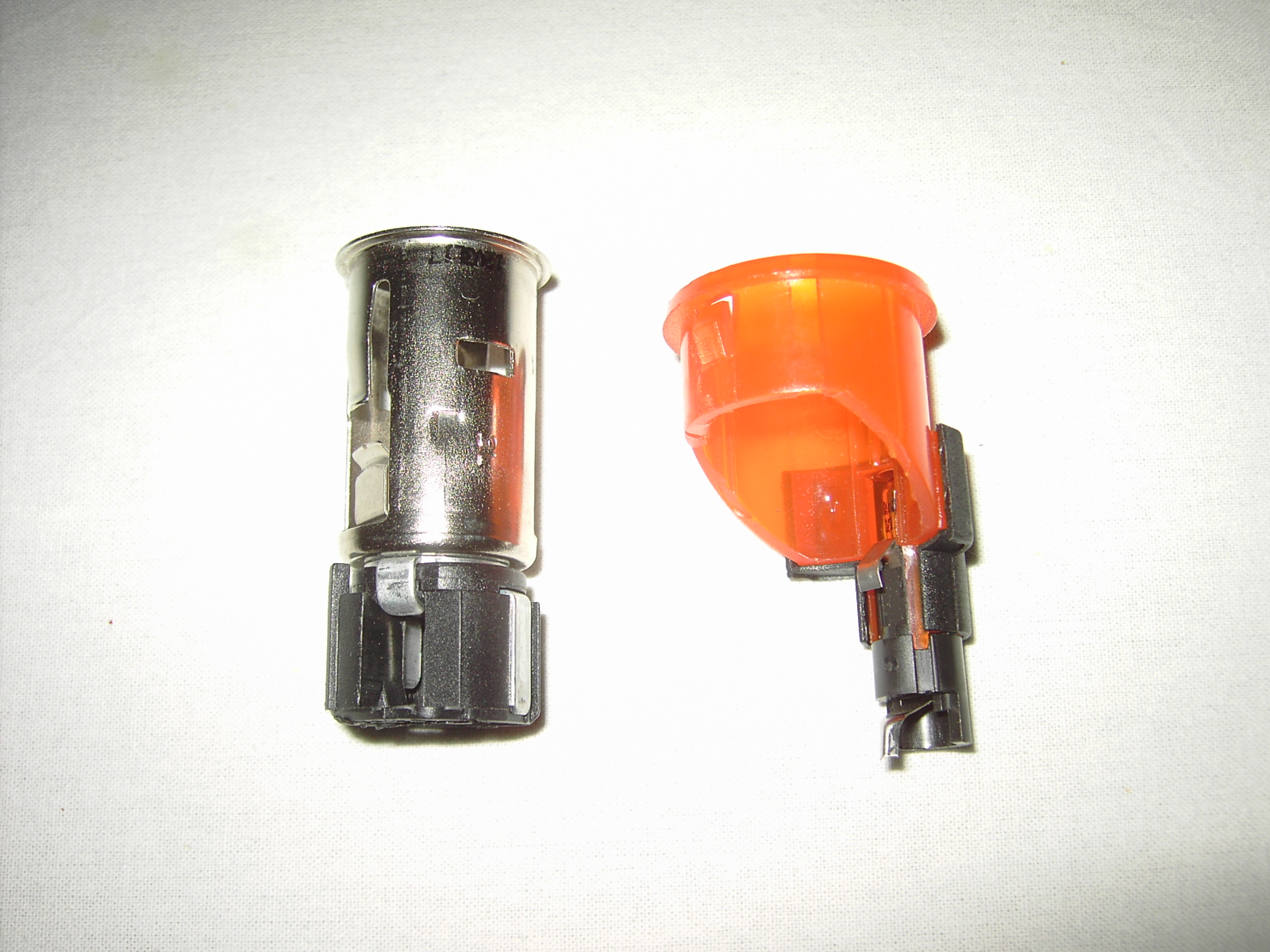

According to ePER, some GPs have the same cigarette lighter as the Stilo, in which case, you don't need to remove anything else to get it out.
Take the metal sleeve with it's wiring connector out first, then tilt the coloured light ring to get that out complete with the bulb and bulb holder. You need a small screwdriver between the top lip of the metal sleeve and the top of the light ring to lever the sleeve up. The two parts won't come out together.

i purchased 2 universal lighters from e-bay. a blue and a red. cannot decide which one to use. love them both. the red is sportier and more compatible with orange but the blue really differs.only replaced the plastic ring. couldn't get the lighter out and i almost broke it.
