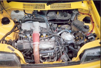

might be able to get my hands on a uno turbo full car for £100 but still no sure if im gonna get it peeple have told me you need driveshafts and need to cut the engine bay iv looked at some treads but cant seem to get the anser does anyone have any pictures of a chinq with the ut engine in so i can see what im going need to do allso if you need driveshaft shortening where can i get them done how much does it cost

iv looked at the turbo faq but it dosnt say much about the ut engine im trying to find some pictures of 1 done so i can se how much you need to hack away at the inner wings who has done this before so i can pm them to ask 1 or 2 things :confused:

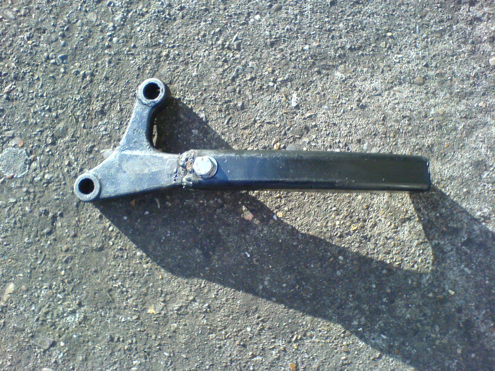

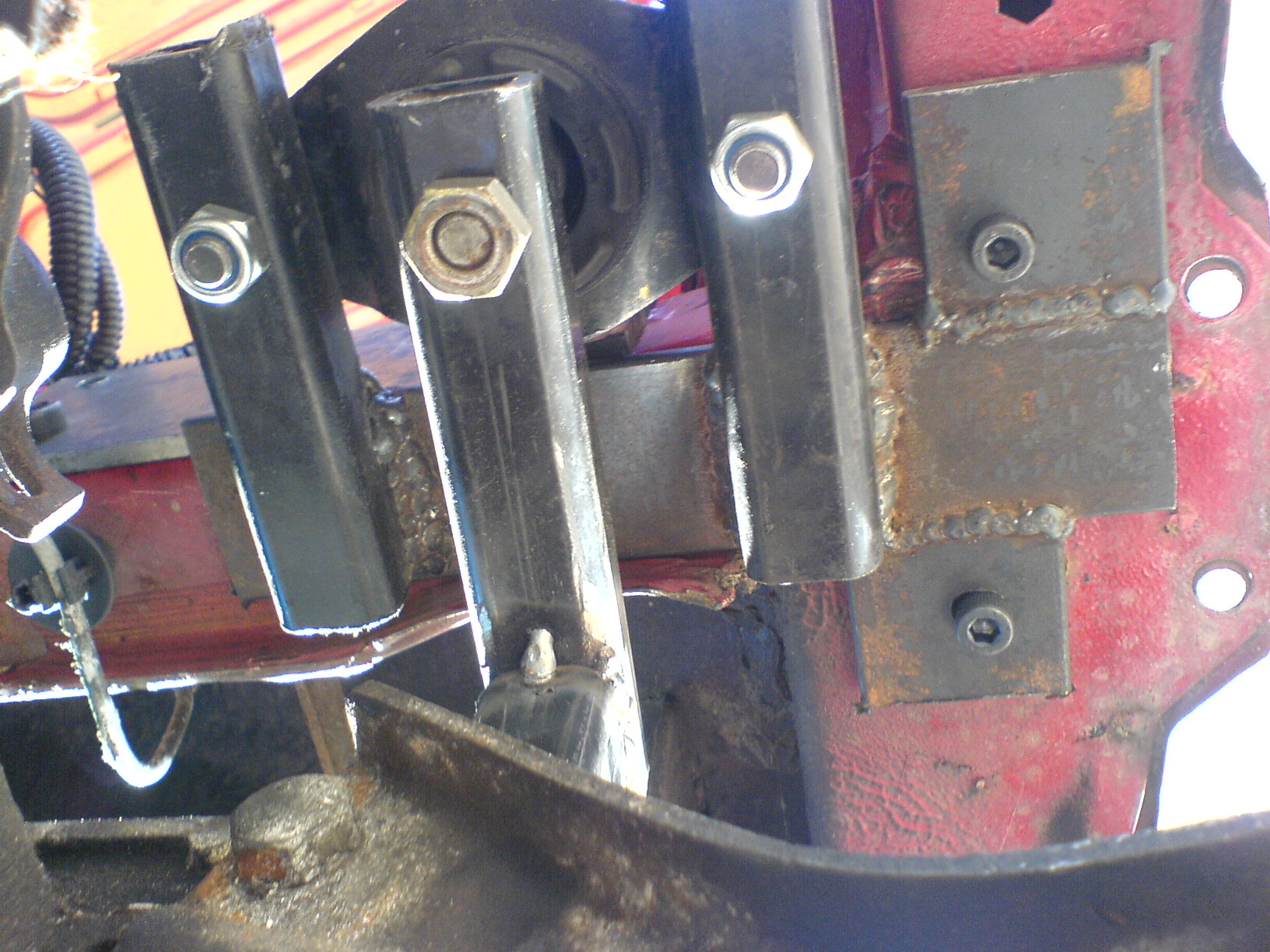

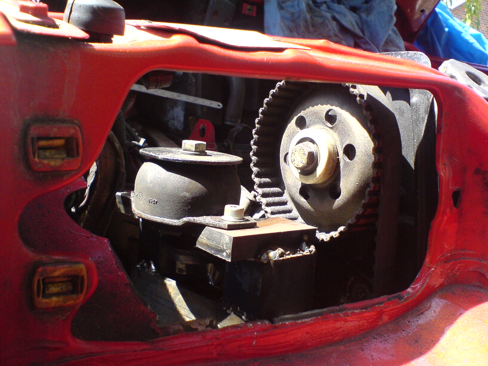

I have taken this engine conversion on using a mk1 1301cc uno turbo engine and I now have the engine in the car with everything lined up. You need to cut the drivers side inner arch around and make a decent base for mounting the engine on. The gearbox side does not require any cutting of the body just make an engine mount up-the same goes for the lower gearbox mount. I will put some pics up later of the progress so far.

Some pics of the car at the moment. I am planning on having it running this weekend and then I have to take the engine out again and finish off and tidy up the engine bay as well as painting it. Also I will be rebuilding the engine before it goes back in for the final time. I have only just come in from messing around with the wiring and this should be done by the weekend. The pictures are of the engine mountings when they were first made and were not fully welded(in case someone says that the gearbox mount is being held on by a tack!)

cool looks good keep up the hardwork thanks for the pictures give more idea where everything sits what gearbox are you using
you no the engine mount next to the cam pulley did you use part of the uno turbo mount then moddify it.
