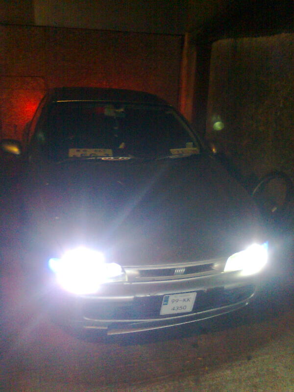

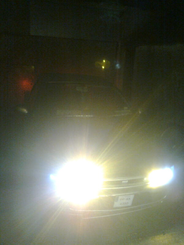

They do outperform the main beams so i had to use 100w yellows as full beams for a while The pictures dont justify how bright the lights realy are :D
