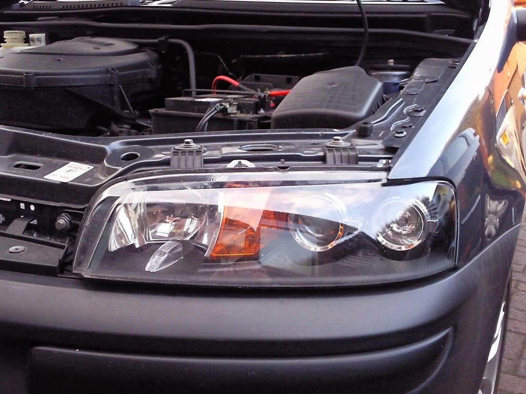

i have took a few pictures just to make sure what i am about to do is right
Picture 1
Picture 2
Picture 3
so you want me to unclip the clips in Picture 3 and i should be able to remove the plastic caseing?

I have managed to get the caseing off and took a picture now of my findings...
How do i get the bulb out and what type of bulb is it if you can tell? (H1, H4, H7)

To take the bulb out, just undo the spring clip in your very last pic to release the bulb.
thank you Chaos,
can anyone tell me what type of bulb it now is loking at the picture?
thanks in advance
I think it's a H7 as per Toad's suggestion. It should be stamped on the bulb metal body.
