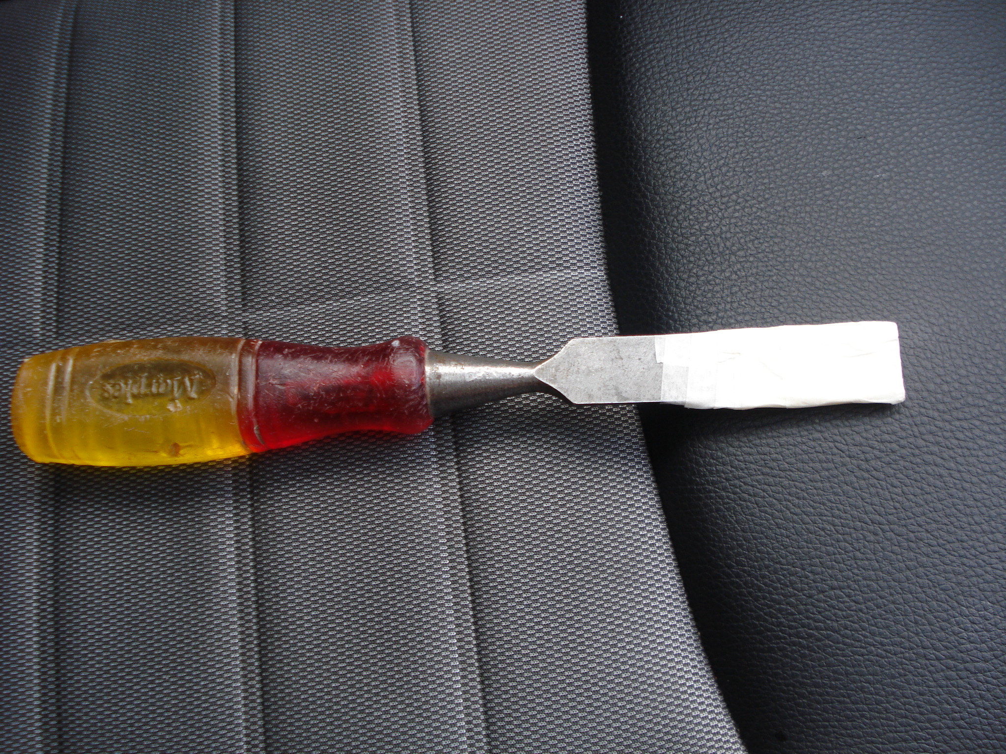

I used a chisel with some masking tape wrapped round the end to avoid damaging the heater control panel or dash. You could use something similar with an old rag, but the chisel and tape worked perfectly, and didn't do any damage!
