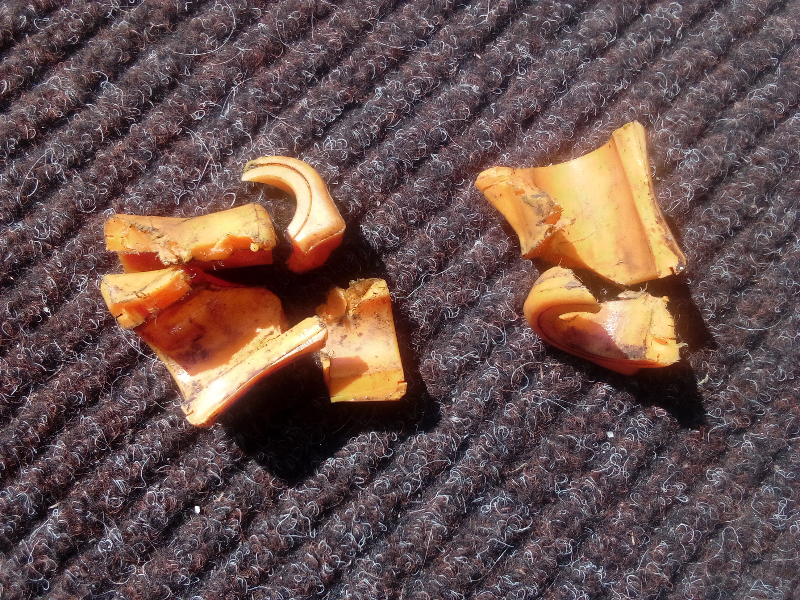

Hi, thanks for the posts on changing anti roll bar bushes for 2010 Scudo Panorama. Garage wanted to charge £650 to replace whole anti roll bar. I followed the above and though very tricky got the job done with £38 replacement bushes and brackets. However after just a few weeks and only few hundred miles the PU bushes are now shredded (I'll try and include a picture). Ive ordered rubber bushes and will try again. Any ideas where I might have gone wrong? Was garage actually correct to say the whole bar has to be changed because bushes are "welded"? Thanks for any advice
Hi, thanks for the posts on changing anti roll bar bushes for 2010 Scudo Panorama. Garage wanted to charge £650 to replace whole anti roll bar. I followed the above and though very tricky got the job done with £38 replacement bushes and brackets. However after just a few weeks and only few hundred miles the PU bushes are now shredded (I'll try and include a picture). Ive ordered rubber bushes and will try again. Any ideas where I might have gone wrong? Was garage actually correct to say the whole bar has to be changed because bushes are "welded"? Thanks for any adviceView attachment 447088
The new rubber bushes will work better I think. As this is an older car the suspension is older and the PU had been subject to harsher forces.
There's no good reason to buy the full anti roll bar and no good reason to pay a garage. Indeed £650 sounds way too much.
You're on the right path. Fit the new bushes yourself. Problem sorted.
Any issues then come back.
may be a bit late responding here but the bushes look a bit dry. Did you grease them before fitting,
Interested if you solved the issue because I did the same several years ago and to date all is well
