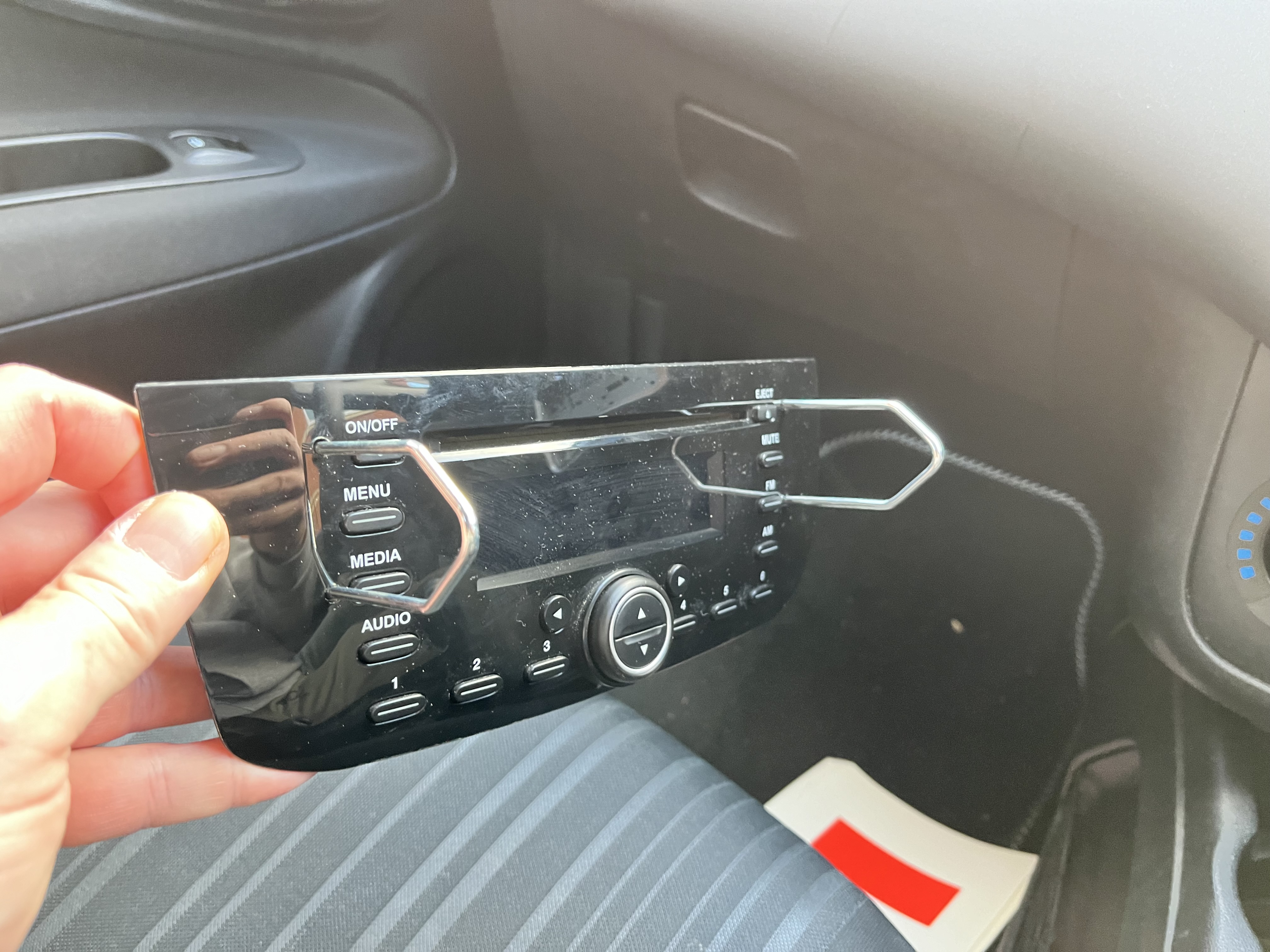

1 x set of radio keys

Disconnect the battery. Remove the radio from the dash using the radio keys and a flat head screwdriver for prying, mine was quite stuck and needed lots of prying to come loose. Be careful to not mark the surrounding centre console.
