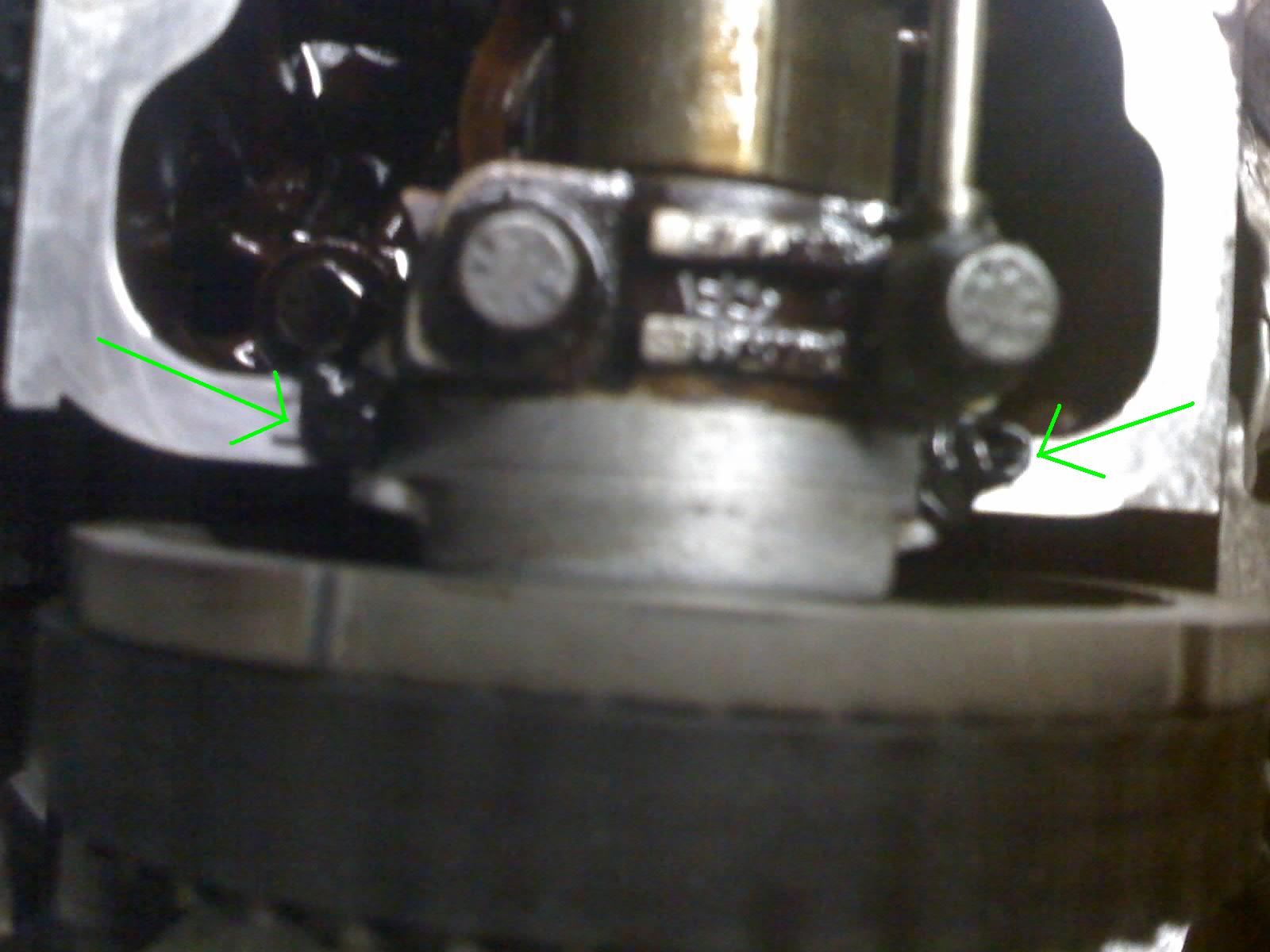

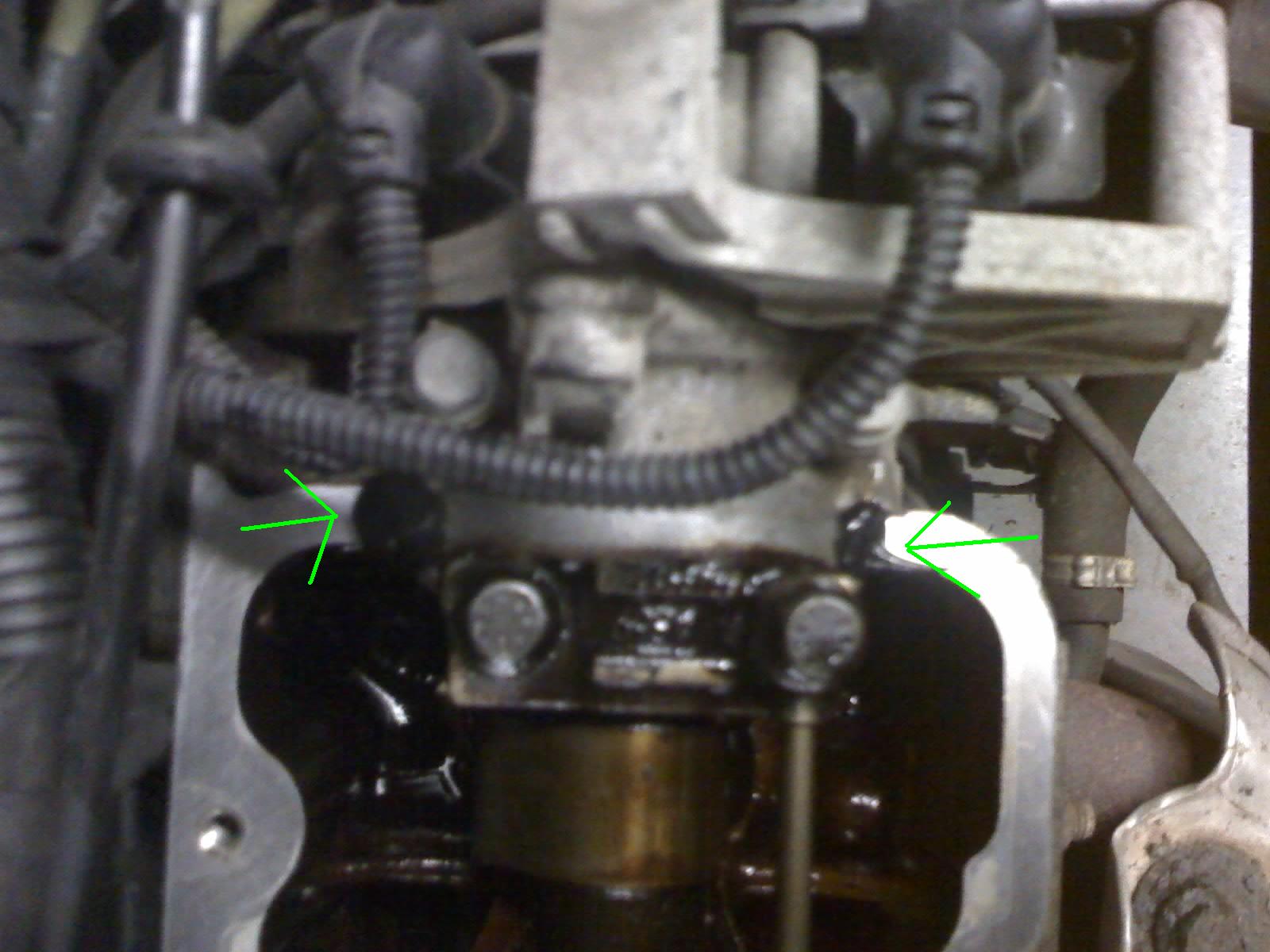

you need to put a large pea of this glue in the corners of the head were the seal turns to go over the cam shaft cap as this is were fiat put it when the cars were built and it will leak in the corners if you don't
some people use a little blue hylomar around the rest of the surface aswell but this is not that necessary as they usually only leak in the corners after people don't use silicone glue
here are some pictures of a car i serviced last week (sorry i only had my phone to take them for you) so you know were to put it
