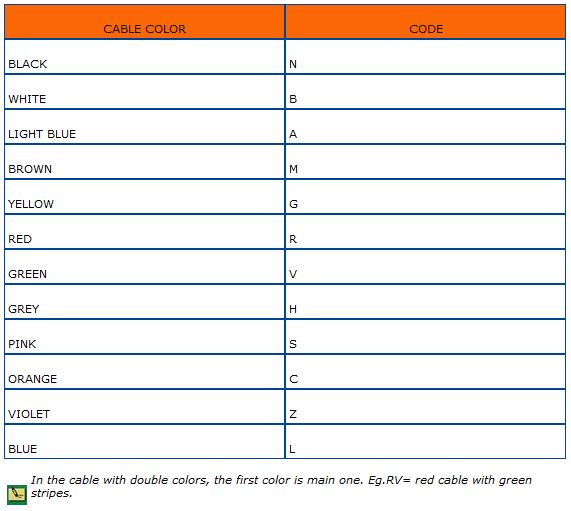

BTW, have checked eLearn, the 3rd light wire is orange/black, here some screen captures that may help...
Regards, Bernie

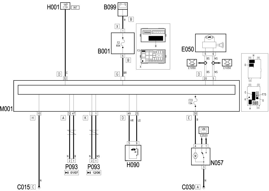

3rd light works, wiper works, not sure about heater because no ice to test melt, lock doesn't work, makes a clicking sound in the dash, but doesn't open or any noise from the lock itself
You hear the relay in the dash (actually in the Body Computer), but the power doesn't get thru the boot opener, here's the drawing, hope you can read it... if not, tell, and I'll explain...
Regards, Bernie
BTW, wasn't this thread about third brake light originally ??
3rd lights, wiper, heater and locker are separated and they share the same earth point WITH SEPARATE WIRES (or maybe shared in a certain way) , You have to check and fix any issue here !!

What does this black wire connect too
I have the black I'm in the connector along yellow, but this black looping one doesn't look like it's connected to anything :/

BLACK wires are 99,99999% of the time ground wires, so they're connecting , say like plastic 3rd brake light assy, to the car's chassis (negative pole of battery) and the On Board Controller, being simple switch or Body Computer, provides the positive part to the device (in this case the central brake light) USUALLY thru a fuse and a control switch (or body computer's relay) .
One of them missing (disconnected/broken/roten...) and the device stops functionning...

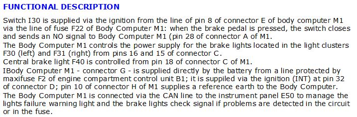

Hi Gimba,
can't make a better description than eLearn...
Regards, Bernie
