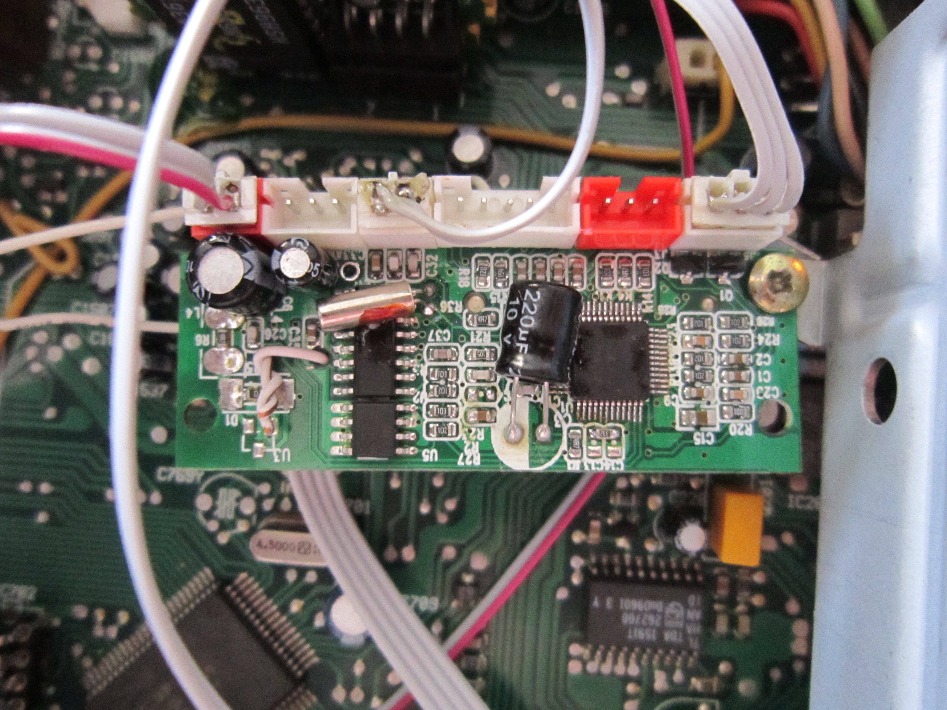

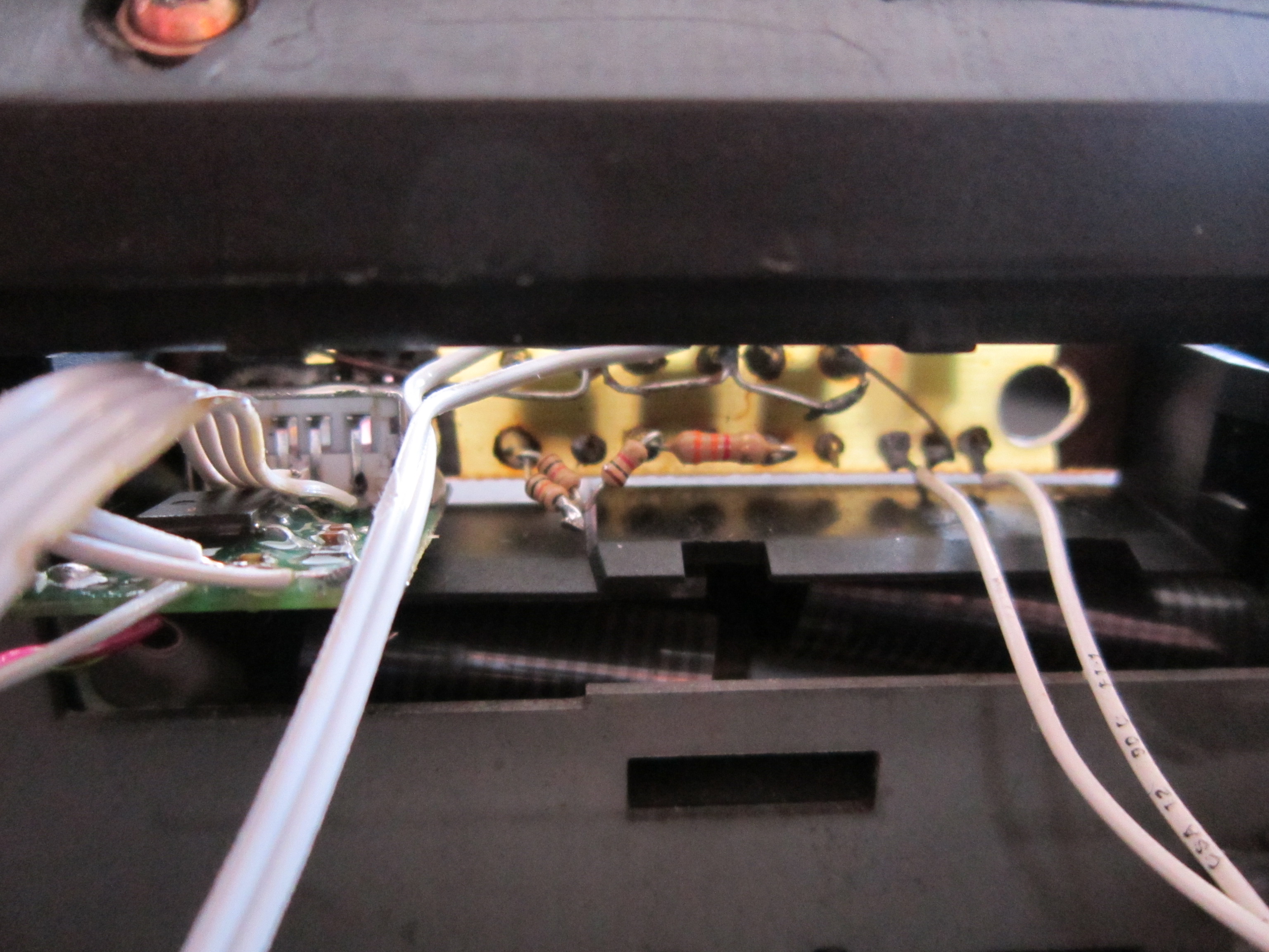

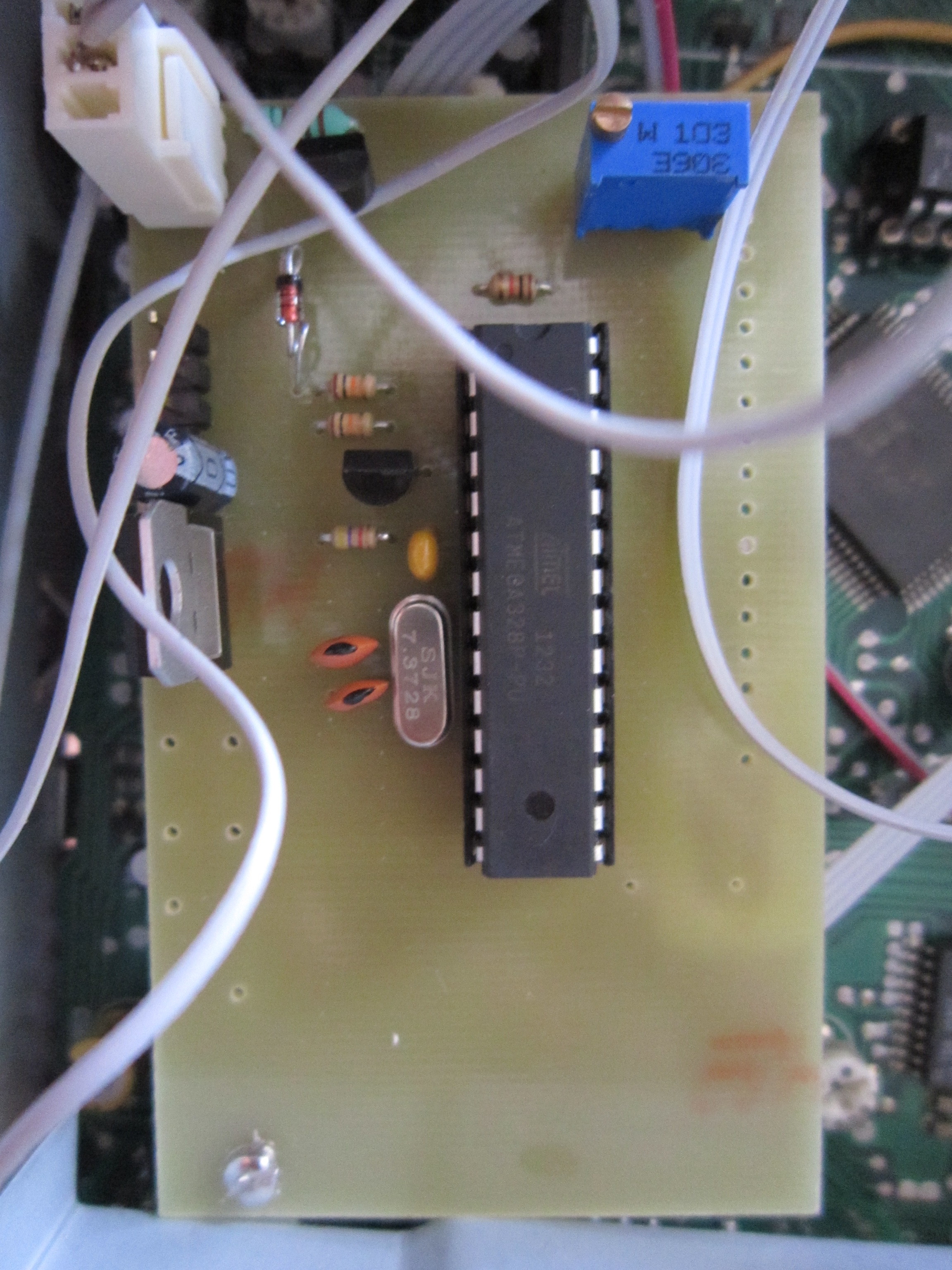

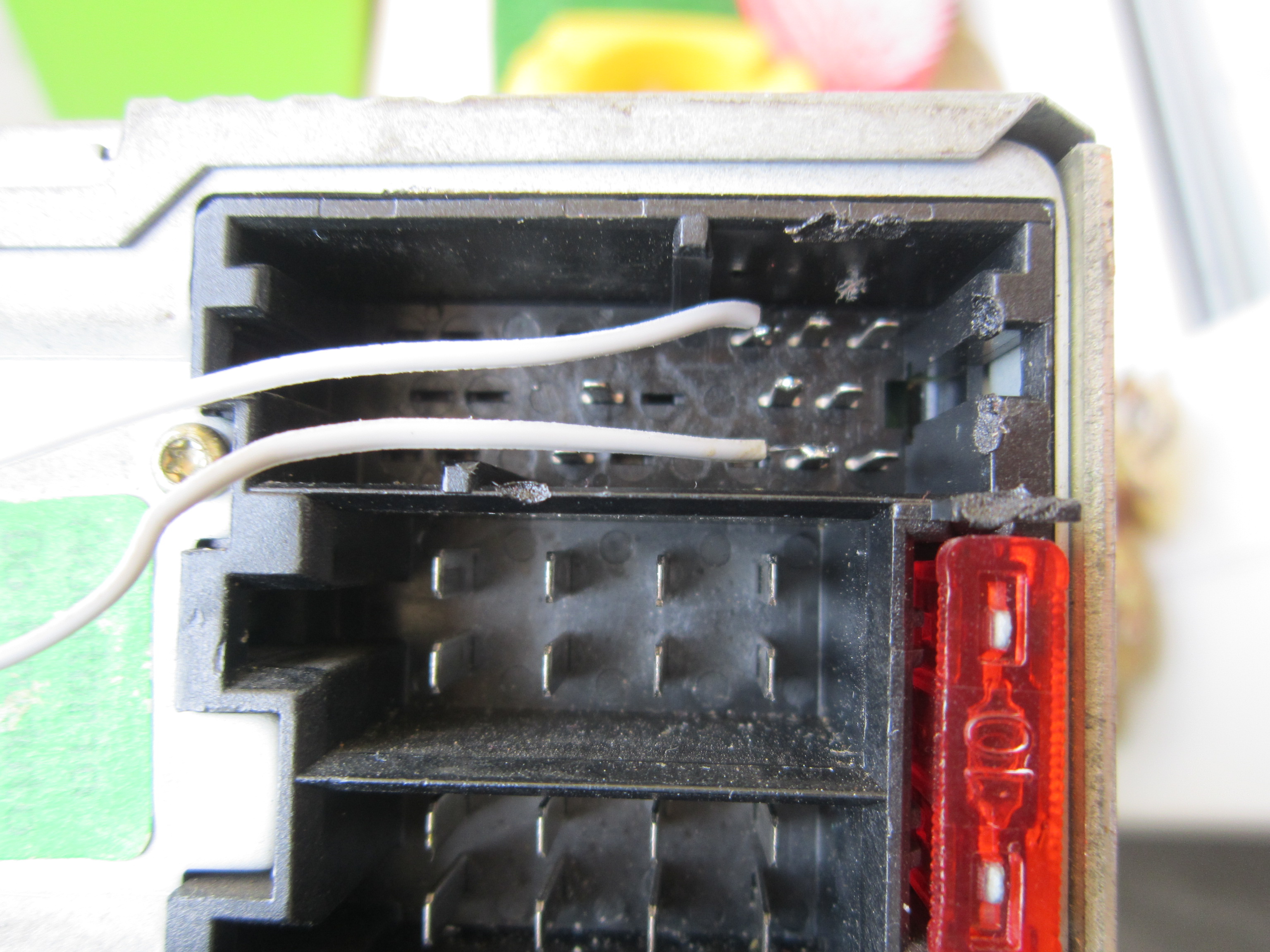

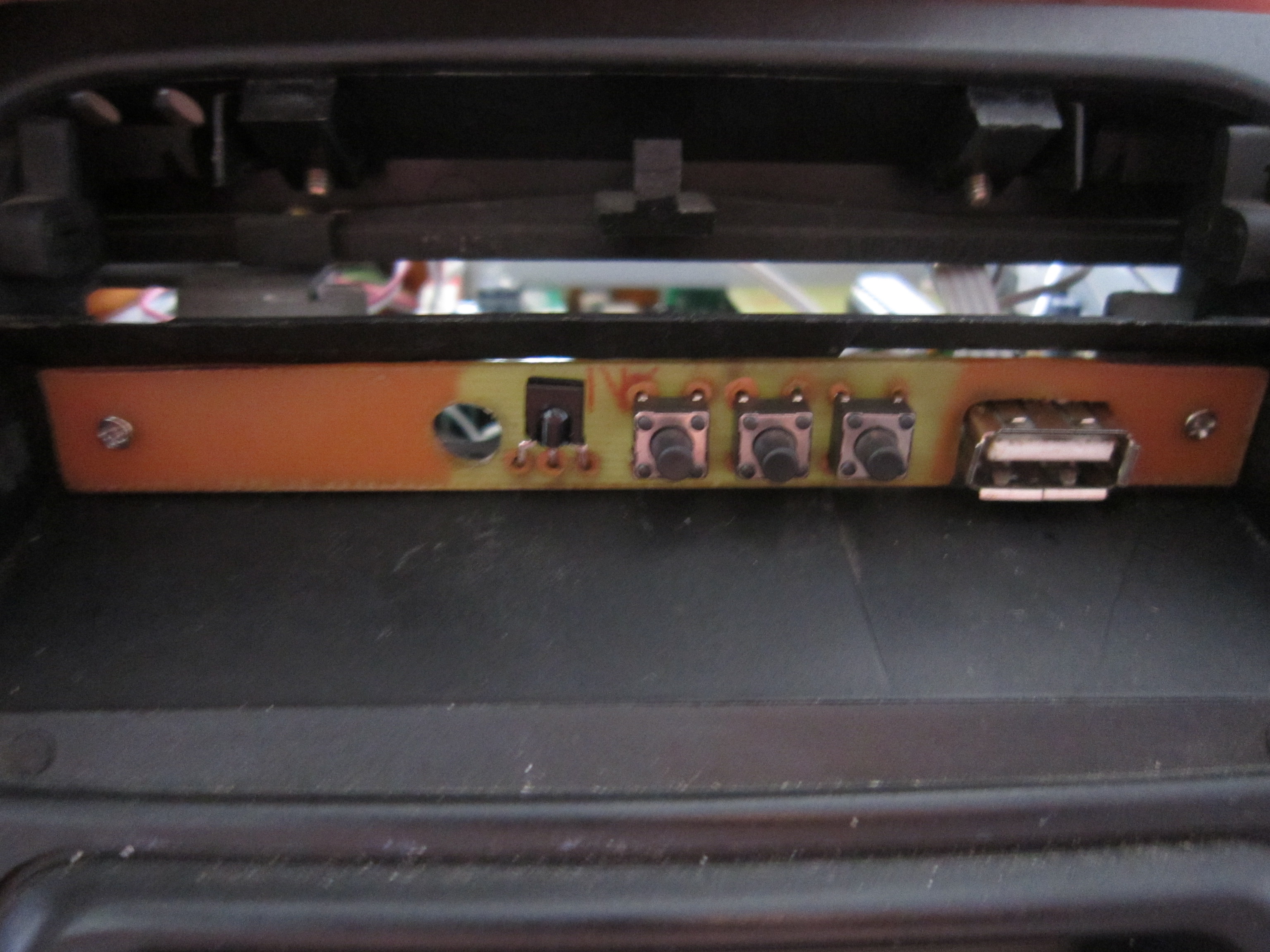

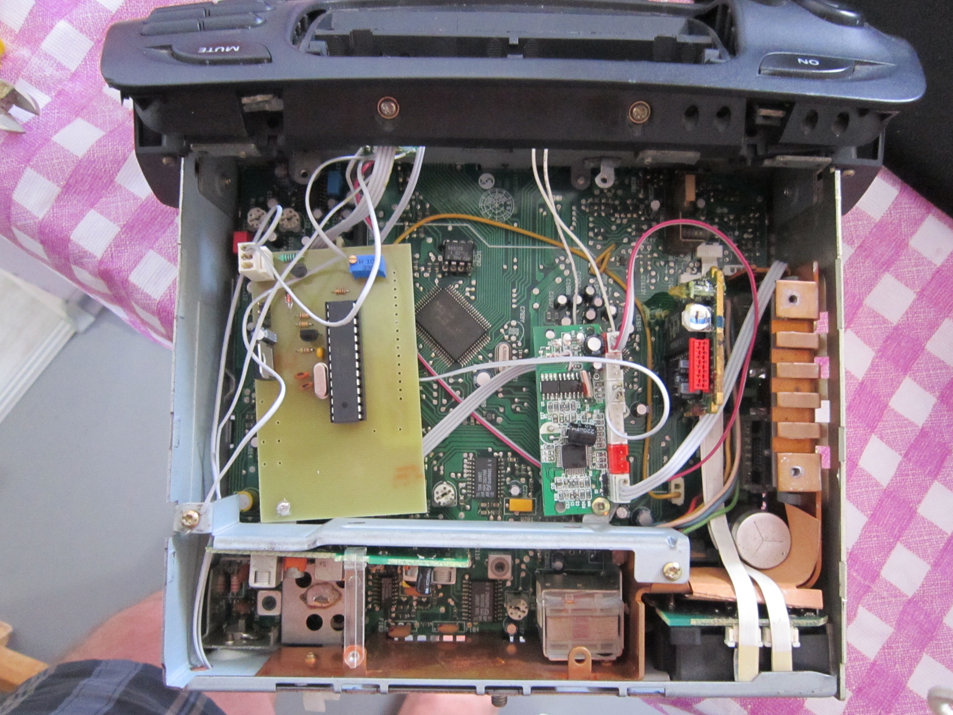

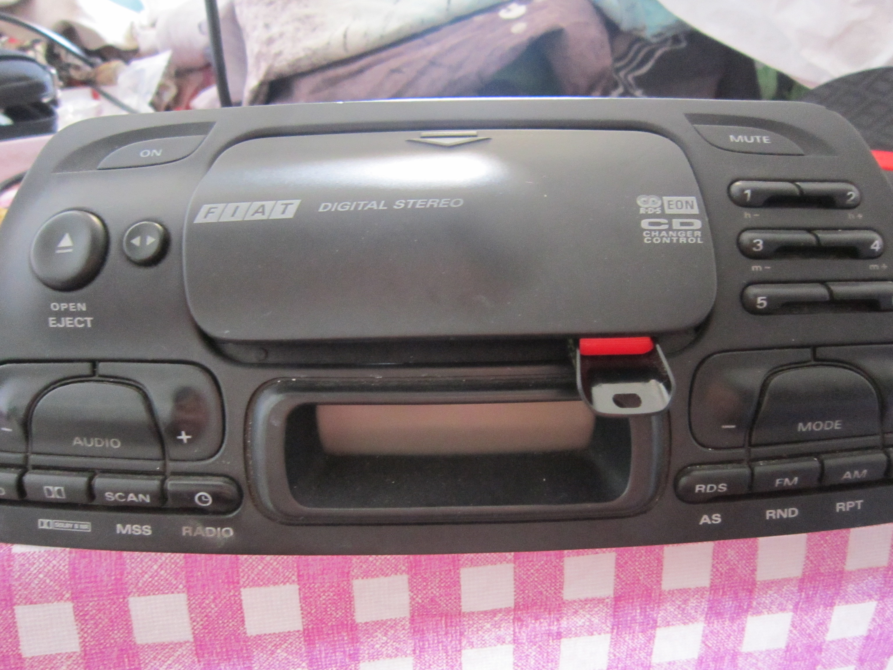

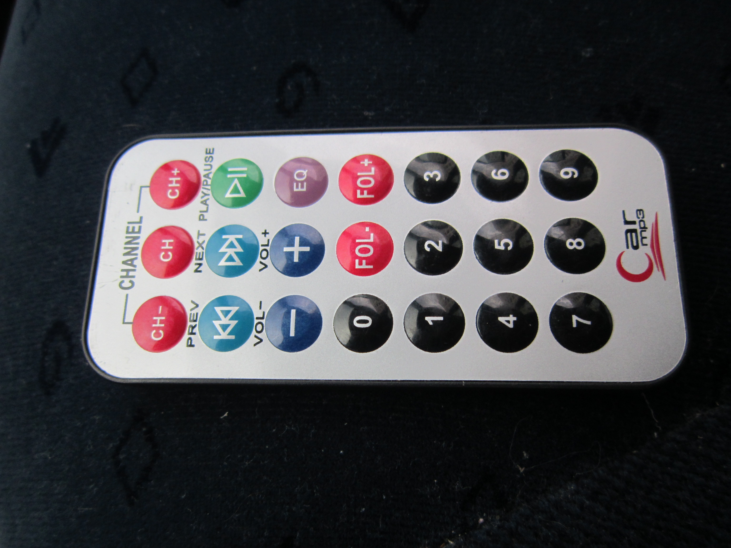

Hi guys,
If you have stock Grundig radio with CDC support you can try the device below.
It emulates a cd changer. You can listen to a mp3 with high quality.
Check out this video ->
Source code and schematics are free. Download here.
I use MP3 module w/o display.

Eagle... be free and use eeschema from kicad :p
So are you publishing the source (grundig proto mainly) or should I decompile the AVR hex? (elf would have been nicer)
Considered doing it myself as I got spare grundig radio that came with the CD changer I installed on Marea (but good old music comes on CDs so havent had a need).

Hi guys,

Links seems dead. Please, find package attached.

Actually sniffed the bus today, 1200 baud serial seems to give proper data. Just rx/tx crammed into same line with some address comm protocol.
Cheating it to think there is changer connected and looking for the next/prev etc command might be possible with some time sacrificed, actually sending proper track time data looks like too much of a bother.
I think I might just use the AUX method and just wire the steeringwheel remote to the unit separately. Much less time consuming.
