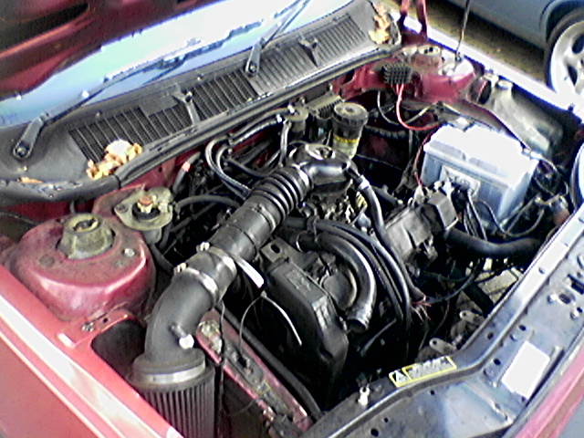

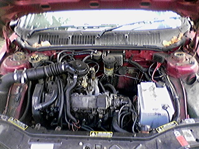

Check the top mounts look the same on both sides. There are left and right side mounts but they can be fitted on the other side of the car. Doing this will alter the castor. Take a photo if you can.
Seeing as I'm not sure what I'm looking for, here are some older pics.
The only diff now is that there there is a StrutBrace across the Mounts.... and the Induction Kit is gone.

I think they are right, but the pictures are not clear.
If the castor is out a little it wont really affect anything much. I would not worry about it.
Coolio :) I'll take better pictures in a mo. I'm off outside to give Tipo an Interior clean out so will take them while I'm out. ;)
the NSF one had been changed but I'm not sure about its proper fitment. It was rattling and a garage I took it to happened to have one lying about and the guy used that one.
