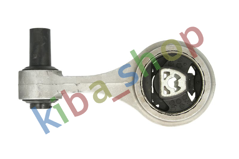

It could still be an engine mount , but more likely the one at the bottom that looks like a dog bone and is fixed from the subframe to the bottom of the gearbox and takes up the load as you pull away. The top engine mounts take the weight of the engine but the bottom gearbox mount stabilises it from jerking about. Possibly looks like this.

Yes you were right! It was engine mount on the gearbox.
Parts that were fitted:
Gearbox Stabiliser Bar - OEM: 55700441
Gearbox Stabiliser Mount Support - OEM:55700439
Drives like a dream now :p(y)
