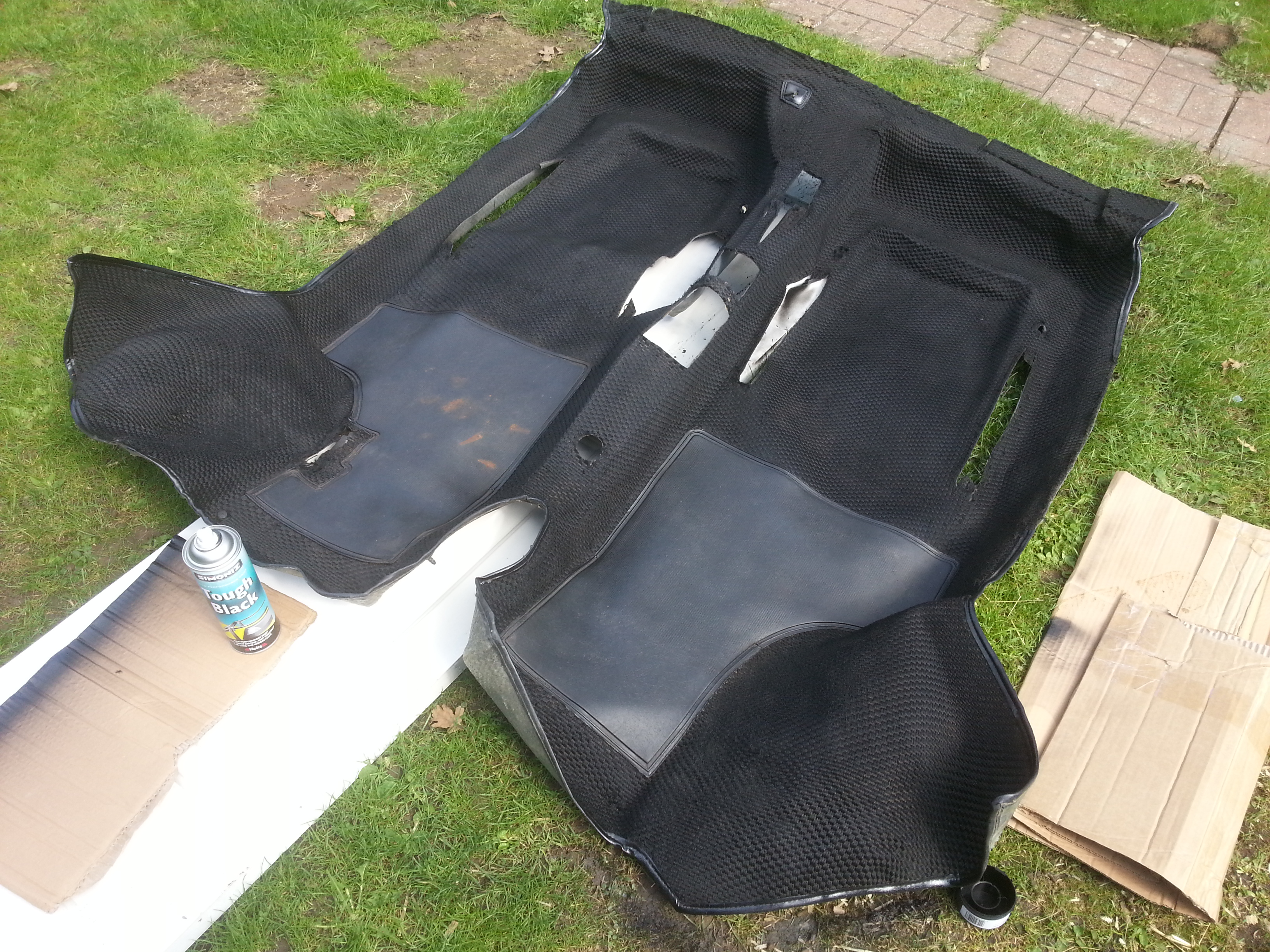

I was able to buy a 2nd hand 1 piece carpet--not perfect, but will suffice until I can get a new carpet (my son's boss owns a motor-vehicle upholstery company--very useful!). 2 points---(1) it is difficult to fit without a lot of fiddling (and a few naughty words) and (2) the sections that cover the wheel-arches seem to be to very voluminous (!?) and it required a lot of 'pulling and heaving' to get those parts to fit nicely. If Tim can get a local upholsterer to make him a carpet (in sections) so much the better.

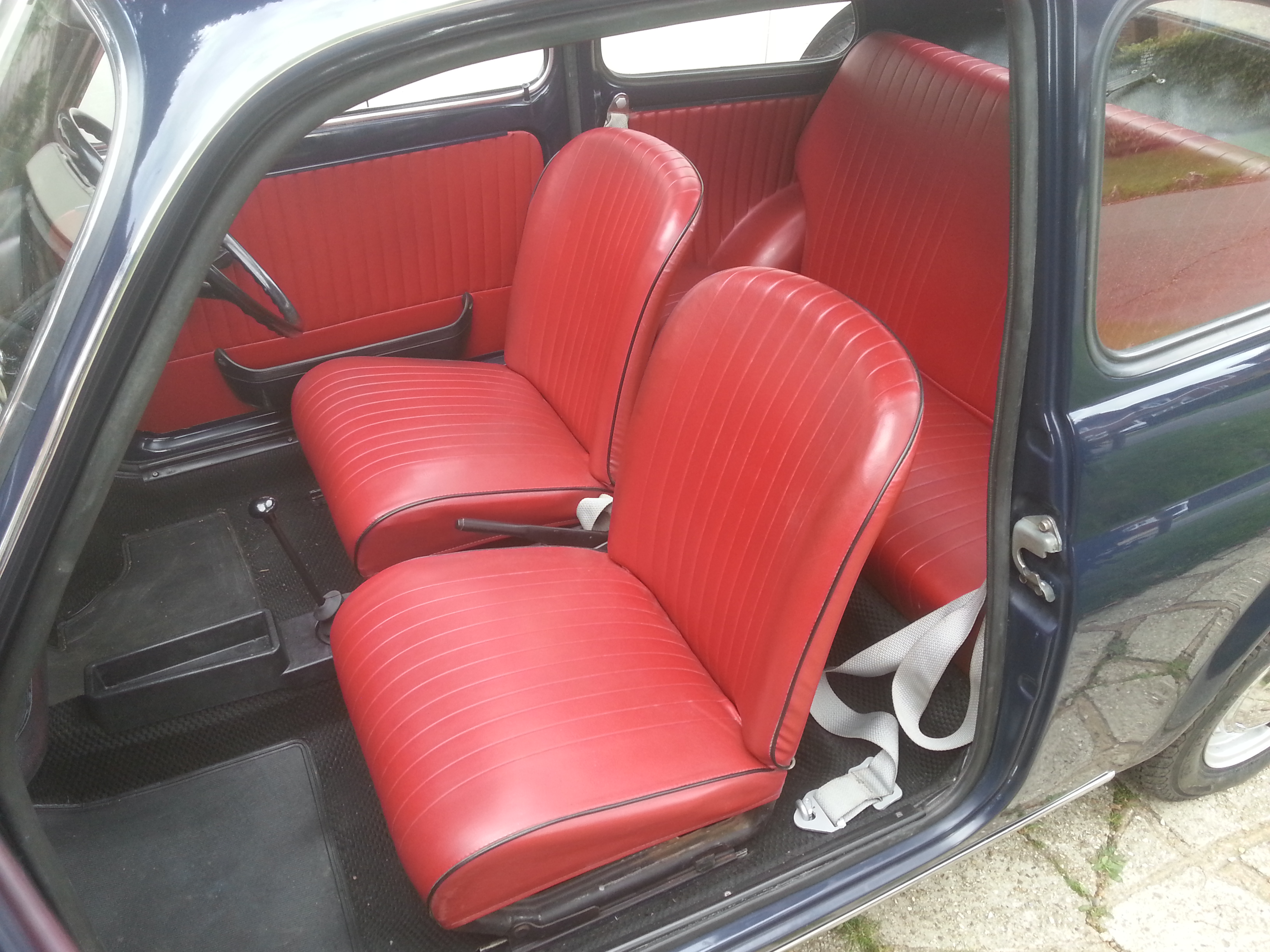

My original carpet fits well, I touched in the faded bits with black paint.
A few self tappers, original fittings keep it in place easy to remove if there is a problem, I would not stick.
