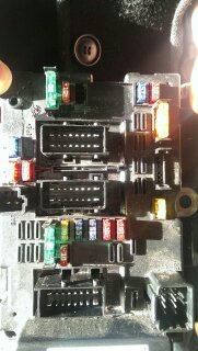

I have attached a photo of the fuses in case it jogs your memory :)
The 2x red and 1x blue fuses on the left were very oxidised. could this be the problem and opening up and cleaning be a fix?

hair dryer too..!!;)
cruddy connections could be ALL you need for an issue,
use NEW / swapped fuses in these 2 x slots;)
