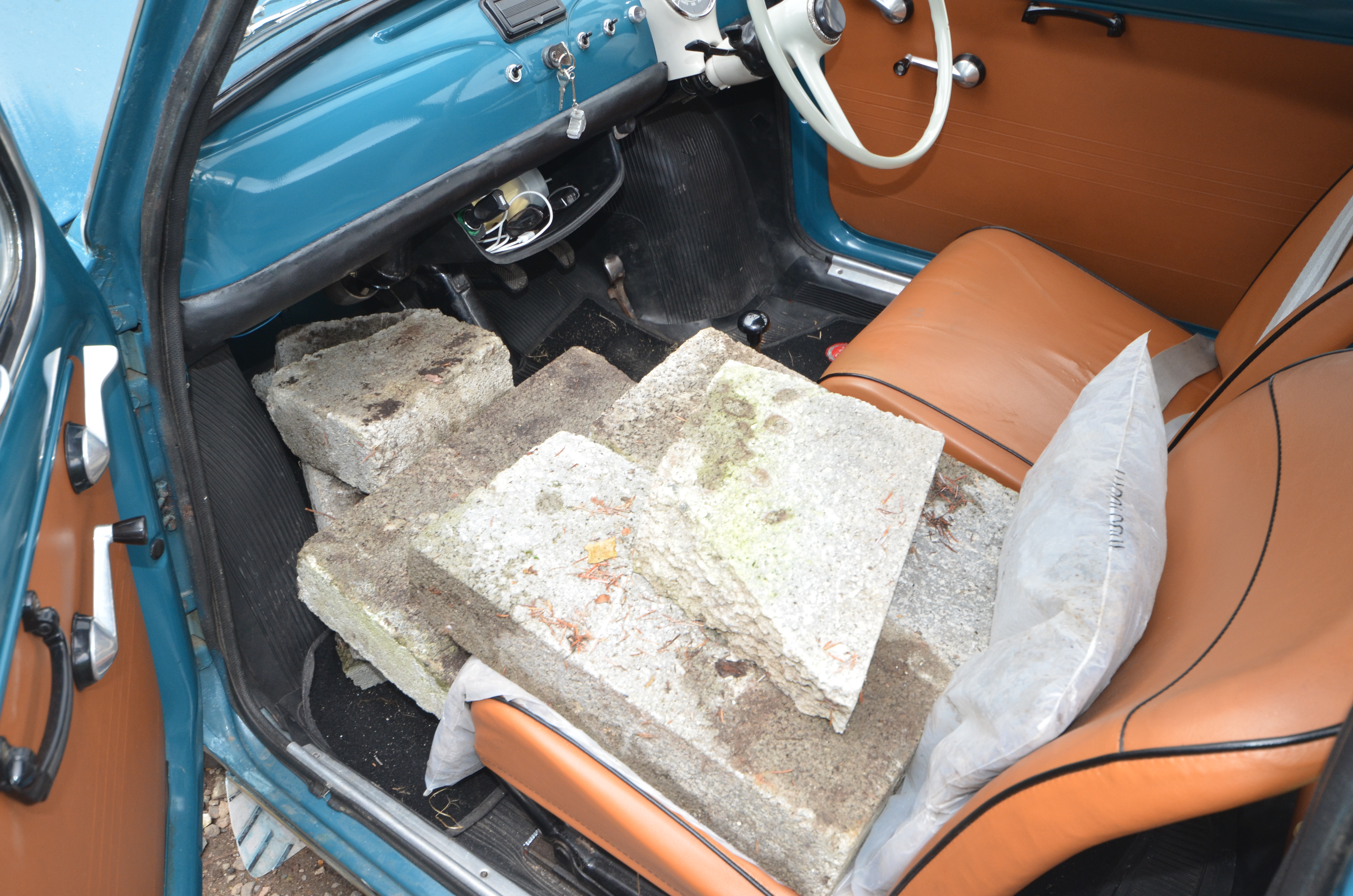

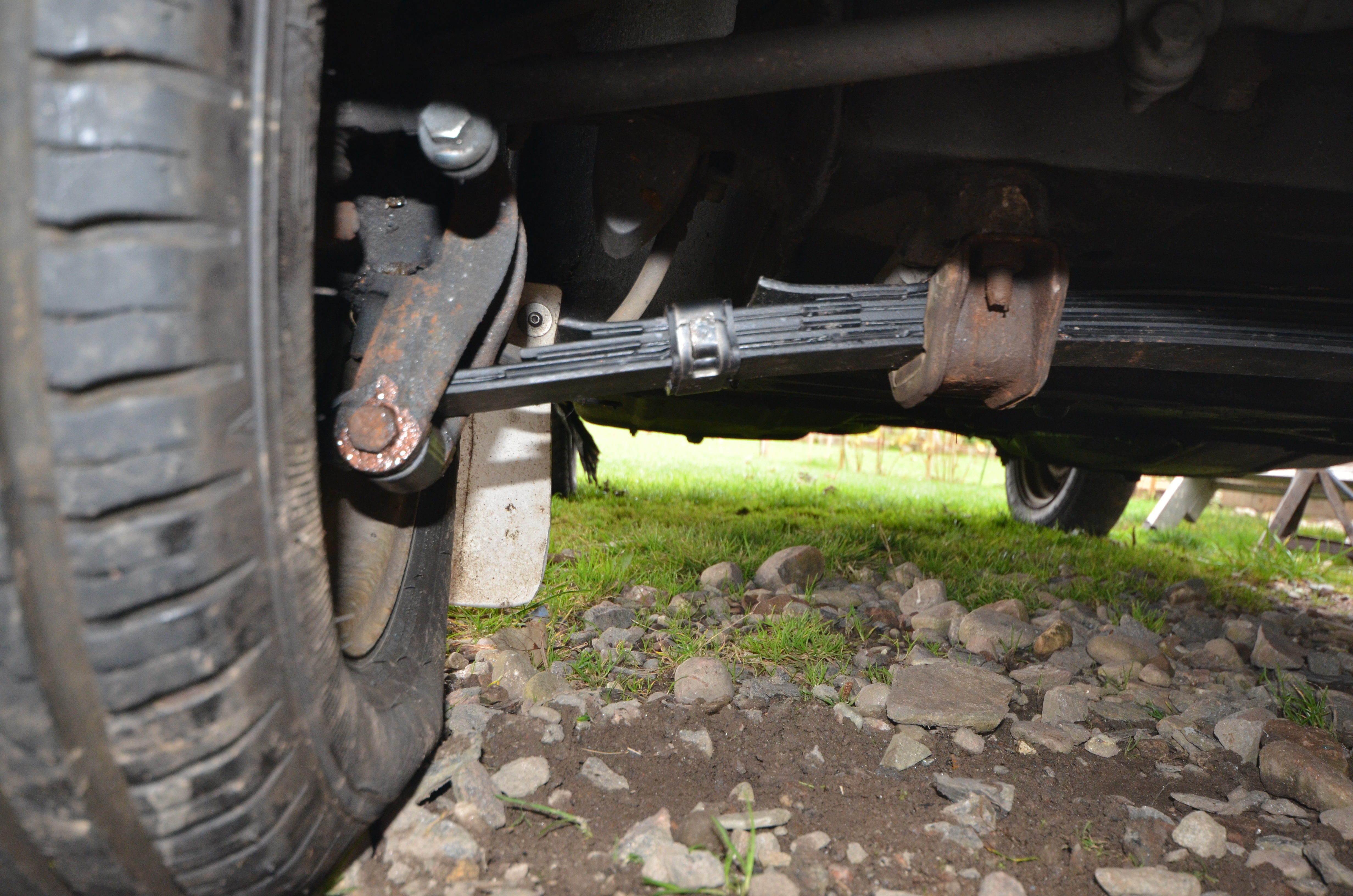

I decided to replace the front spring because the car was sitting low at on side. After reading up on the subject I realised that a lot of people experience ride-height issues after doing this job, so I tried to bring together all the advice available and to tackle it in a way that is possibly a bit different from standard.

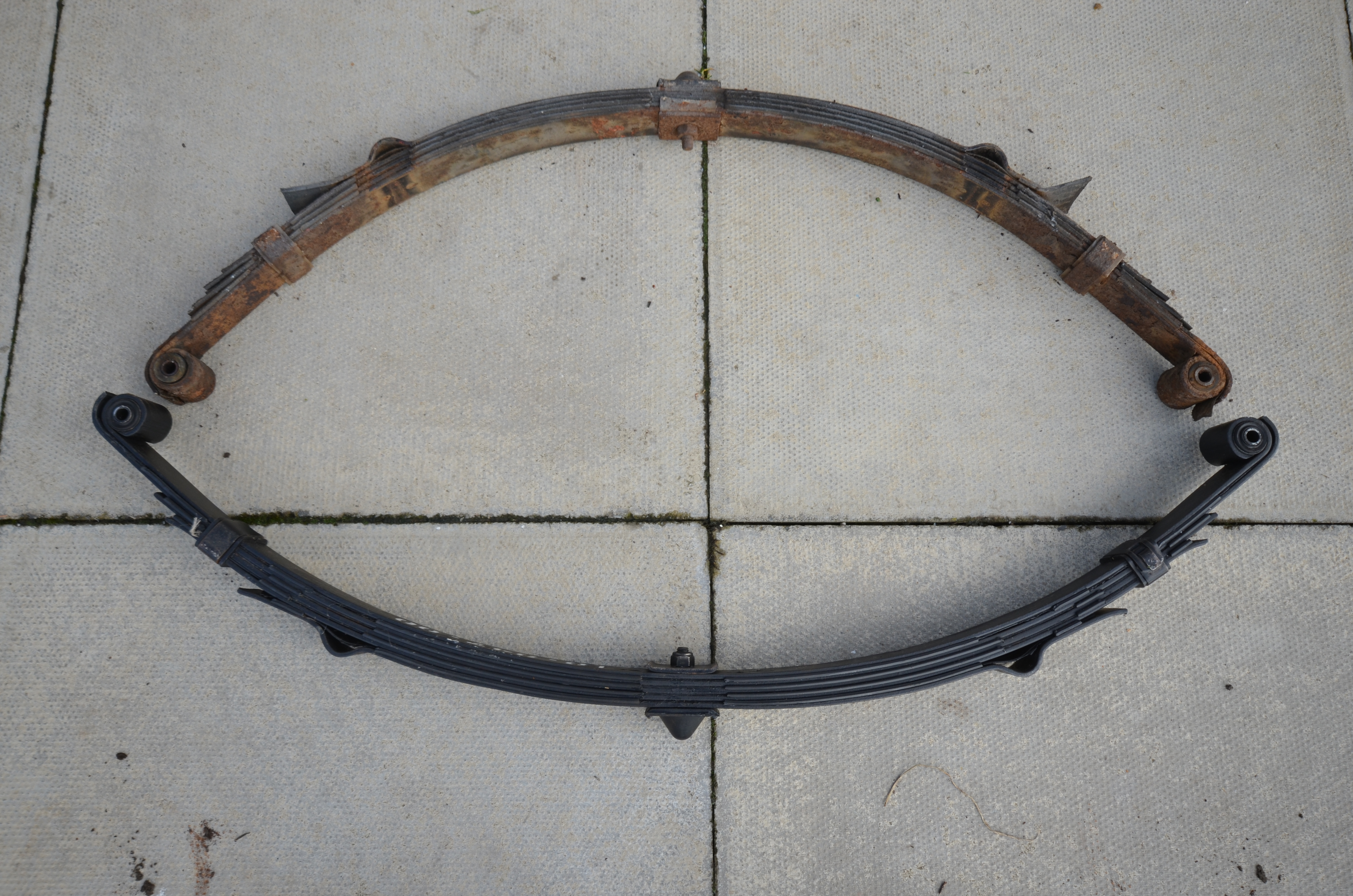

Removing and replacing the spring is easy as long as you undo and tighten things gradually and evenly at each side. I think Haynes covers it well. The old spring is the original and was easy to compress by hand but had a greater curvature than the new one, which worried me at first since I expected the old spring to have flattened with use and therefore the shape of the new one looked wrong.

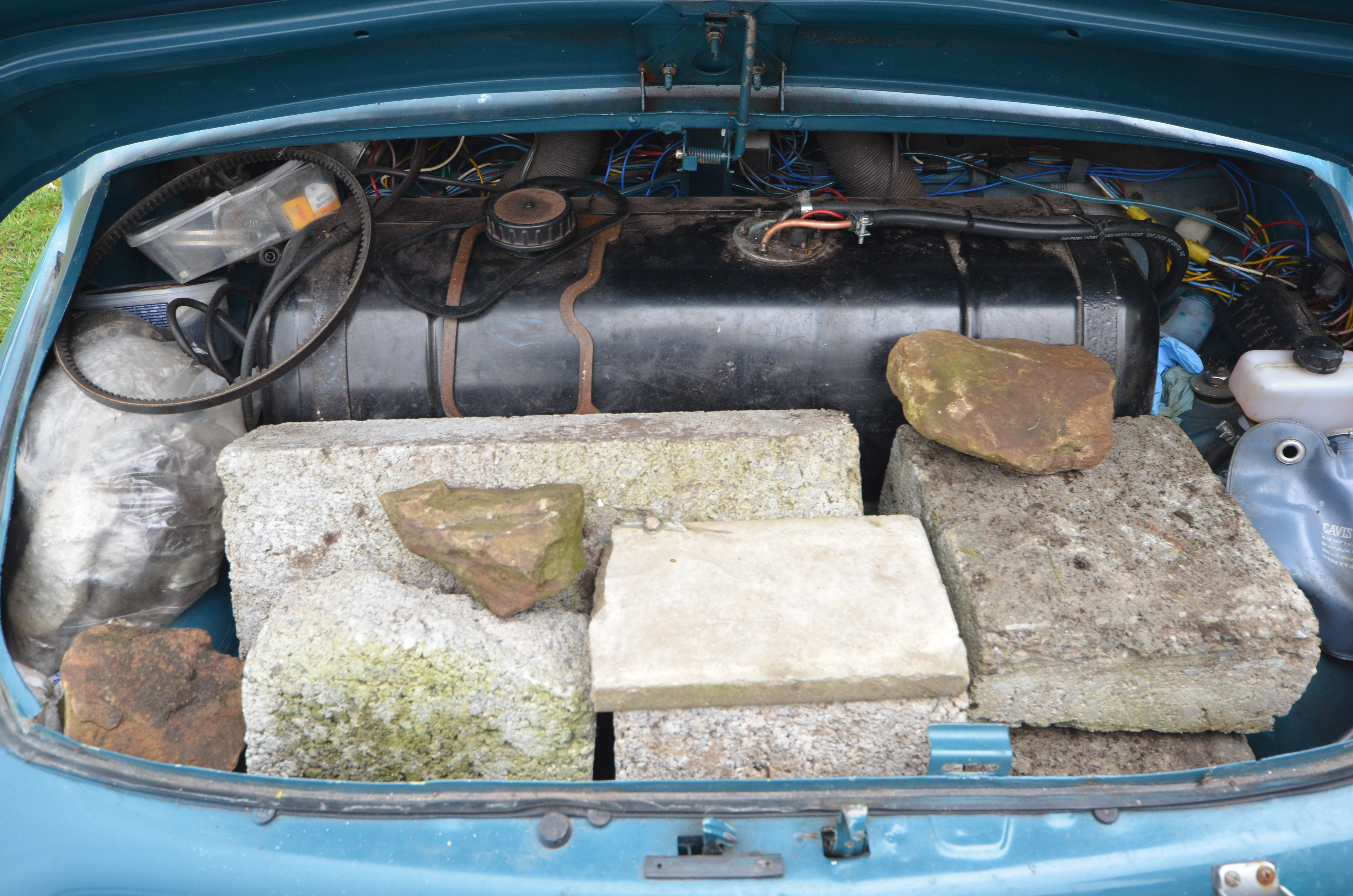

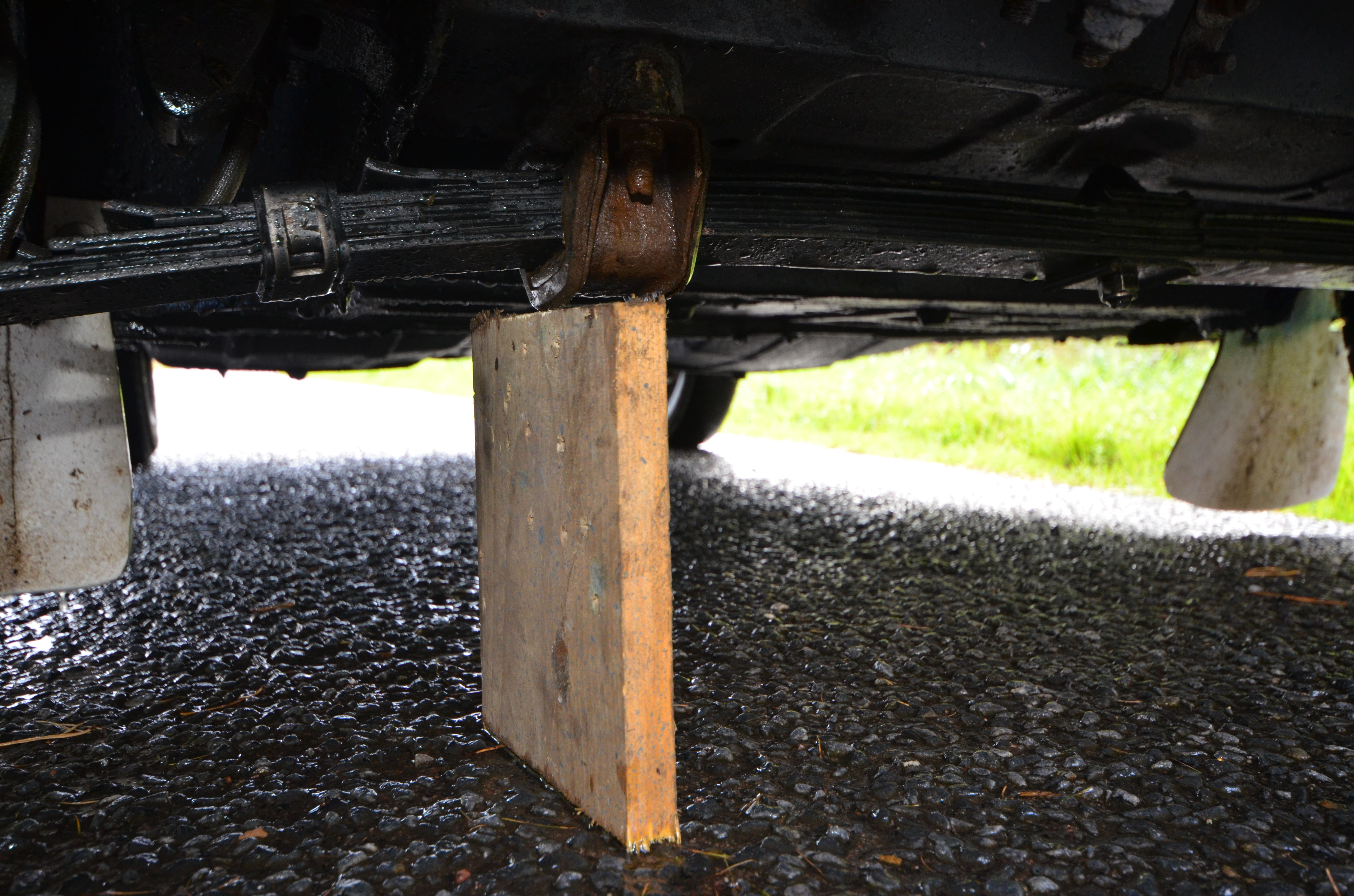

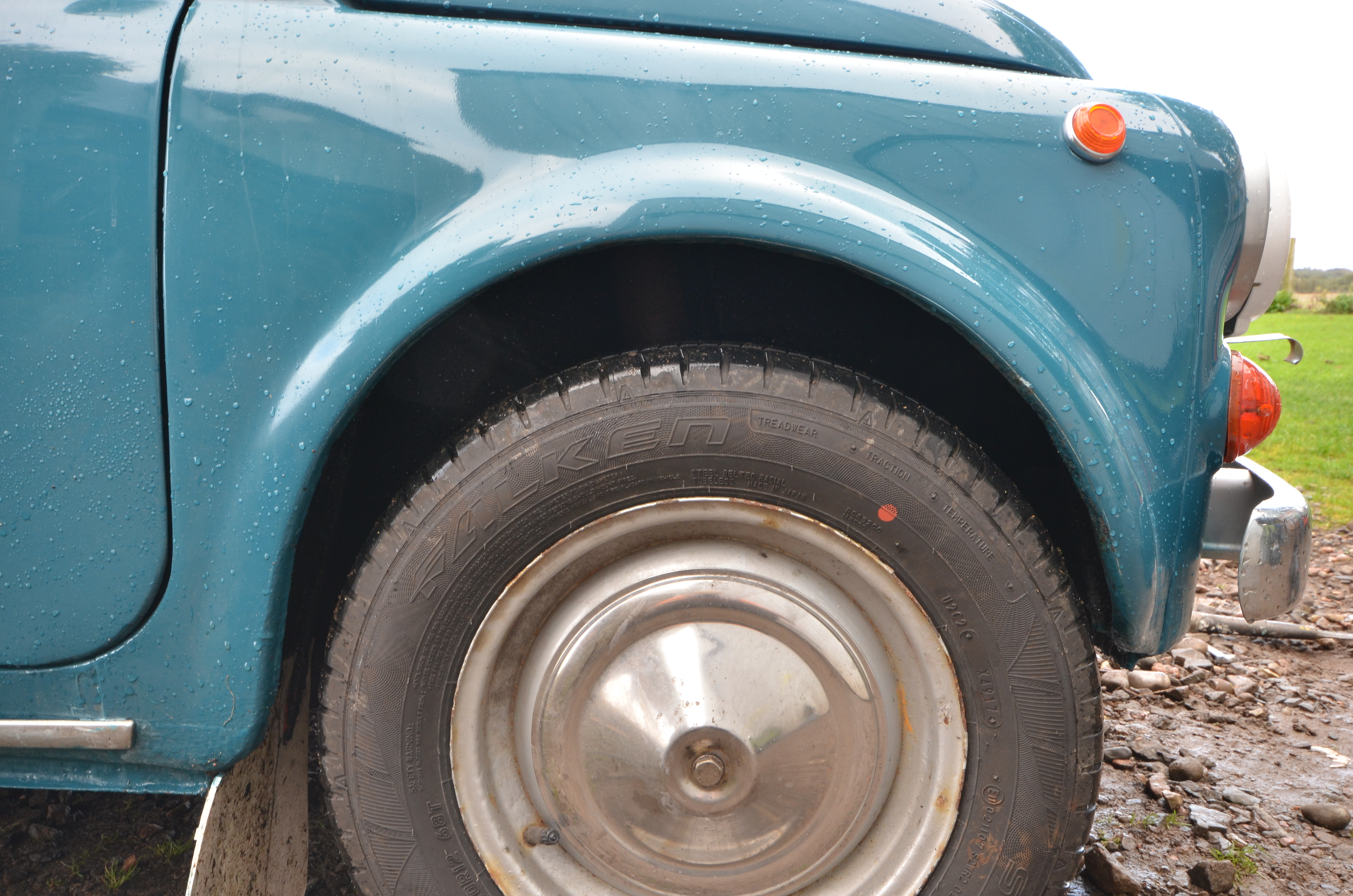

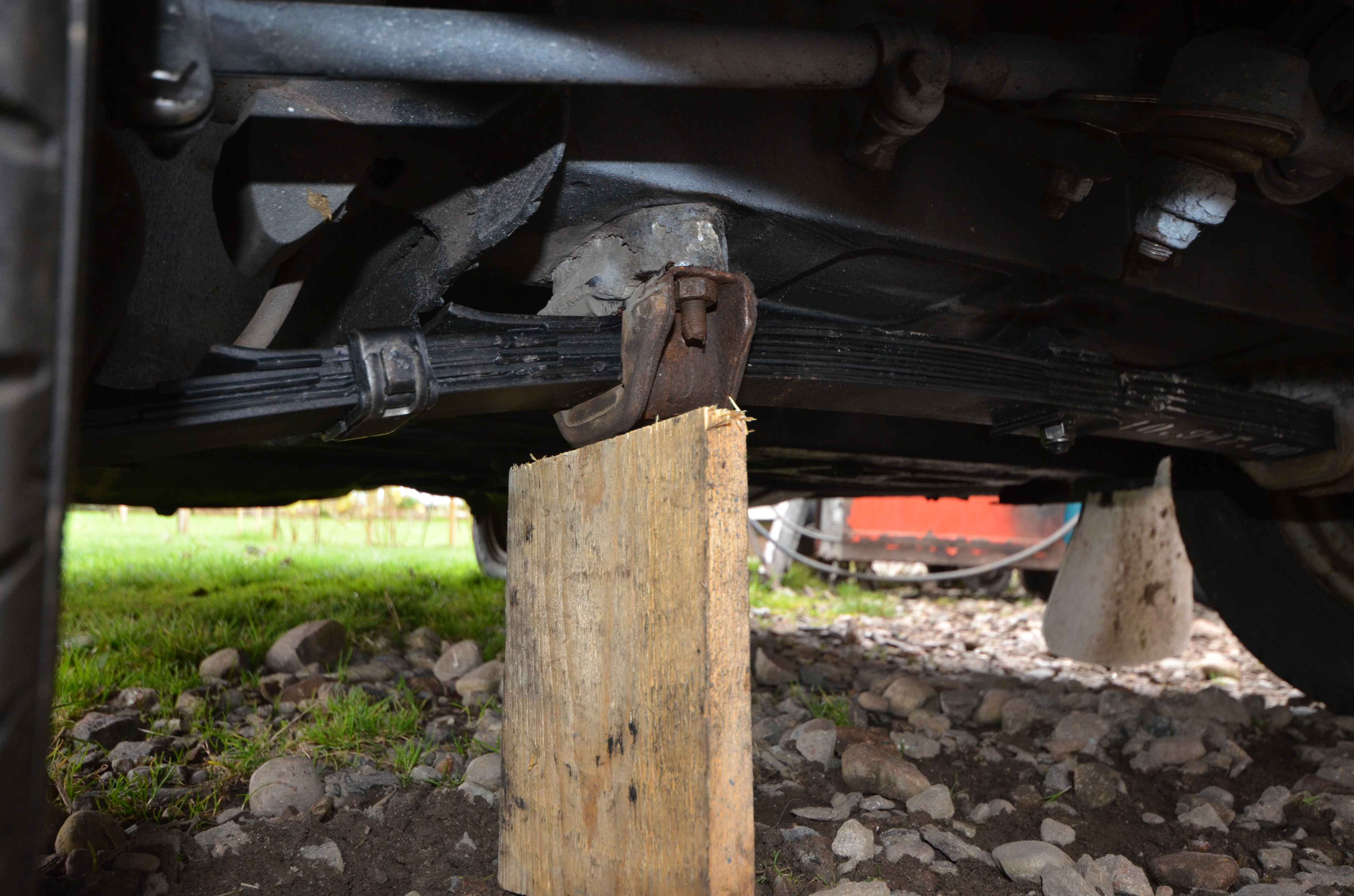

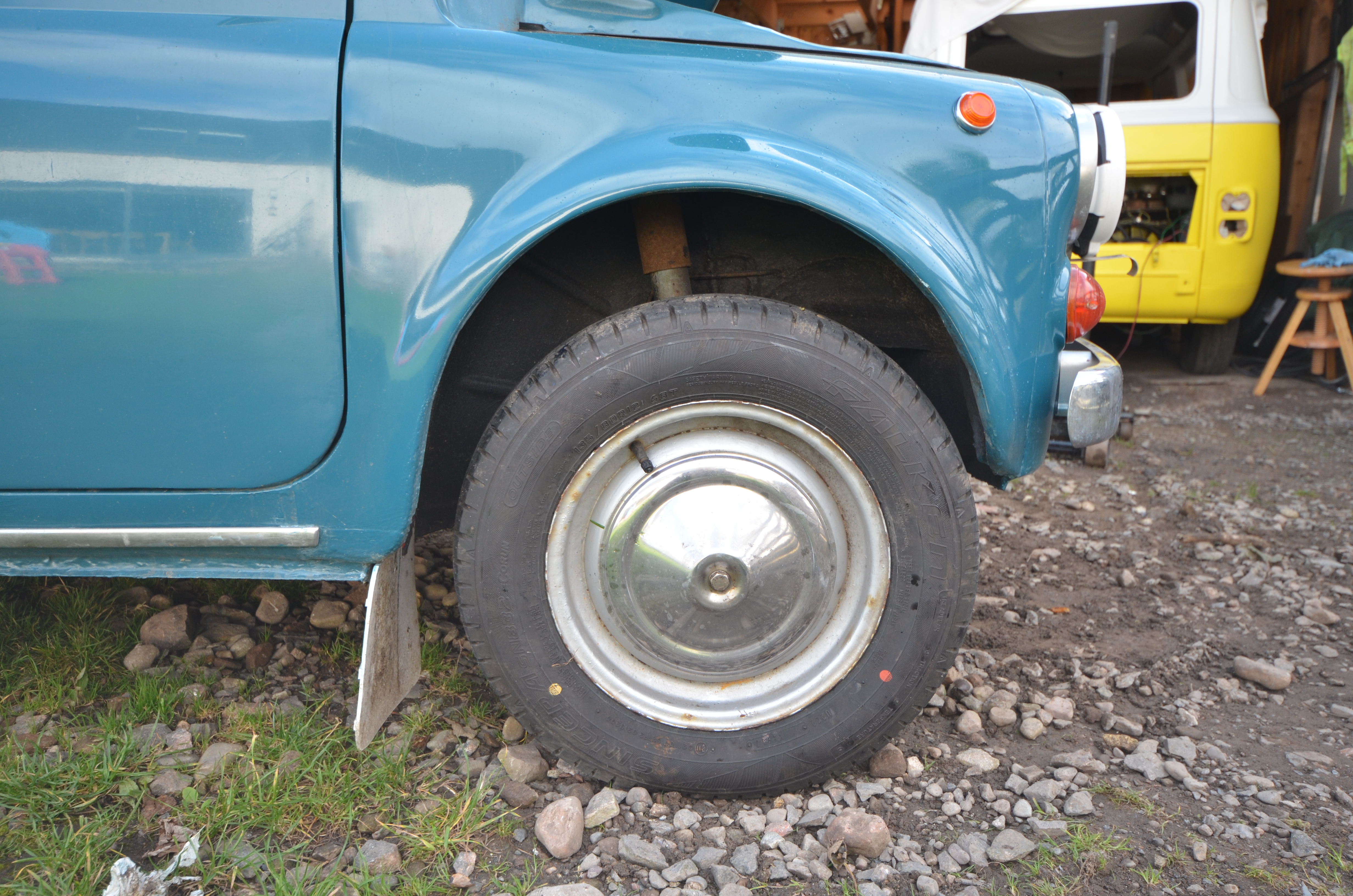

The spring is supposed to be preloaded to the extent that the bottom of the spring clamps ends up 173mm above the ground. I filled the car with about 150kg weight in concrete blocks, left just slightly more than finger-tight the nuts for the top and bottom king-pin housing rubber-bushes and for the spring-clamps and went for a short drive. I then found the spring had settled to the extent that it sat lower than 173mm. With a few trials which entailed gradually removing weight, I ended up with the equivalent of about 50kg in the boot with the car just resting on a piece of timber cut to 173mm. At this stage I tightened all of the nuts, without moving the car, removed the remaining weight and then I had a car which sat at a proper stance and was ready for the toe-in to be re-checked.
Since it's now all tightened-up I've had a short drive; the cars sits correctly and is slightly softer and more springy at the front than it was with the tired, old spring. It seems a bit more sure on the corners, which is good because I did previously feel it was getting a little flighty at times.
  • Height of 173mm eventually achieved using three concrete blocks in the boot.JPG
You forgot add that it took you 3 hours to empty the bonnet of its usual contents, in order to put the rocks in :D Mind you, on further inspection of the pictures, it doesn’t actually look like you managed to remove all of it. It might have been quicker to leave the original contents in situ as it probably weighs more than the rocks, sorry ballast.:idea:
Have visions of an upset partner wondering why the bathroom scales are scratched and covered with fine concrete dust...
....:D we've been there with that sort of thing, mainly involving blunted scissors and garden-tables covered with paint.:rolleyes:
I'm smart enough to consult the internet for an average weight for concrete blocks. Ideally I would have used bags of sand, but none in stock just now.:)
My approximate weightings are just a guide. But the principle of preloading is very important. Once secured it means that the metalastick bushes are predetermined to be in a relatively neutral position once the car is loaded, which leads to a ride that is more as the designer intended.
...true.:D But since I replaced the porcelain, Belfast kitchen-sink with a lightweight, pressed steel one, the weight up front has diminished somewhat. ;)
