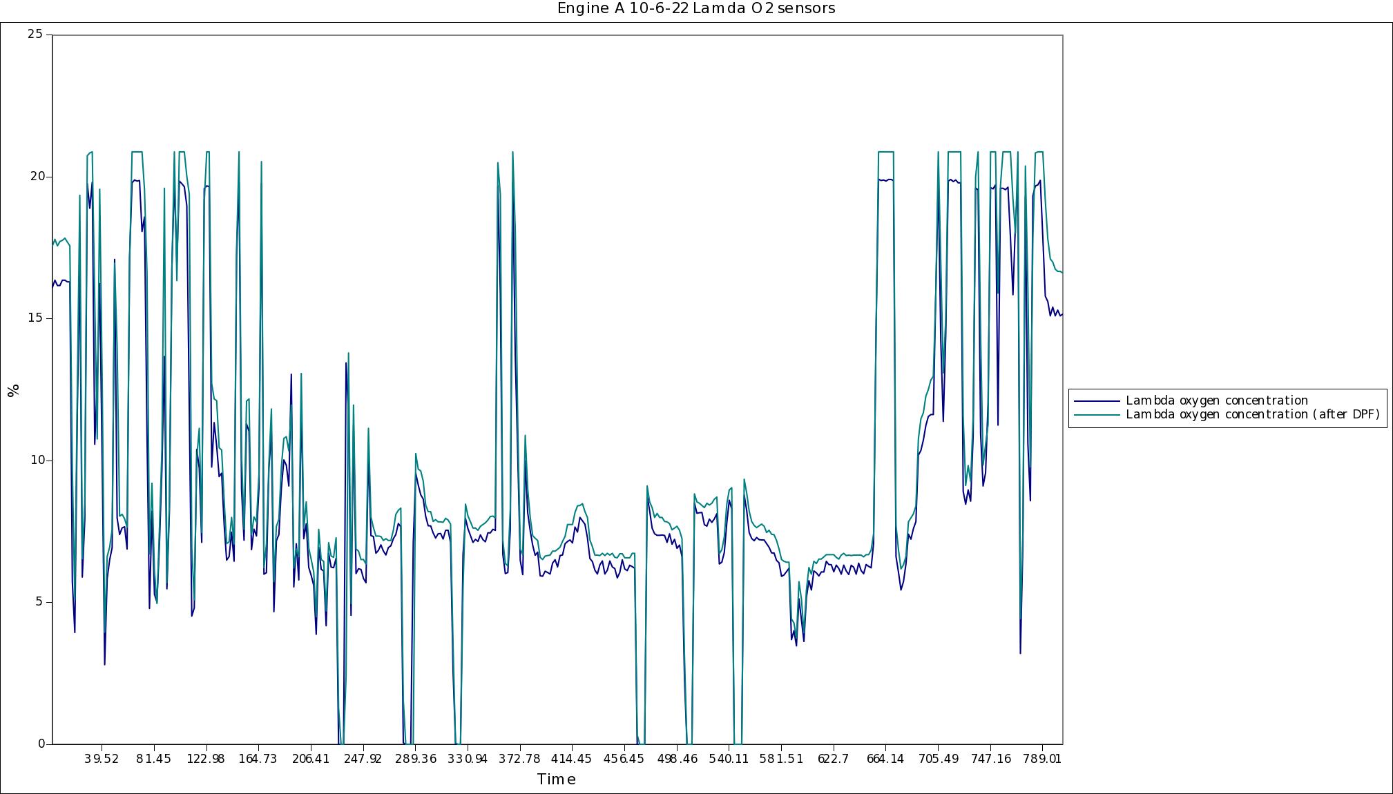

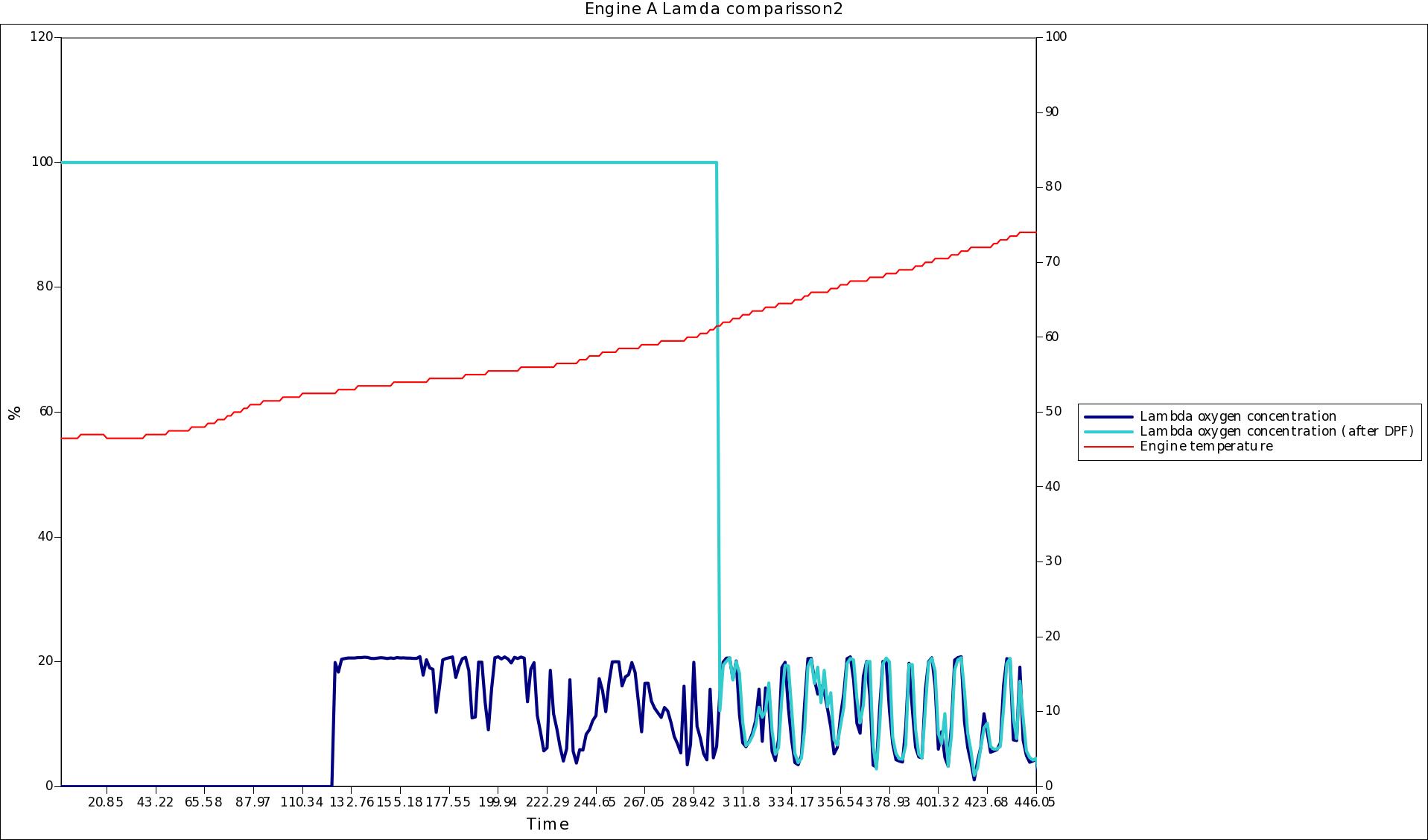

The graph is from data collected by
Multiecuscan. It starts from startup so sensors dont start up imedeately this is normal
View attachment 428072 not odball. The value will never exceed 21% ratio of oxygen in air.
the next is more normal running. Where O2 values dip to zero the O2 is consummed and soot could be generated/ deposited.
So you see the O2 can vary a lot. your values are they voltage?
just checked all my data i have not calibrated the Oxygen sensors so cant help there.
