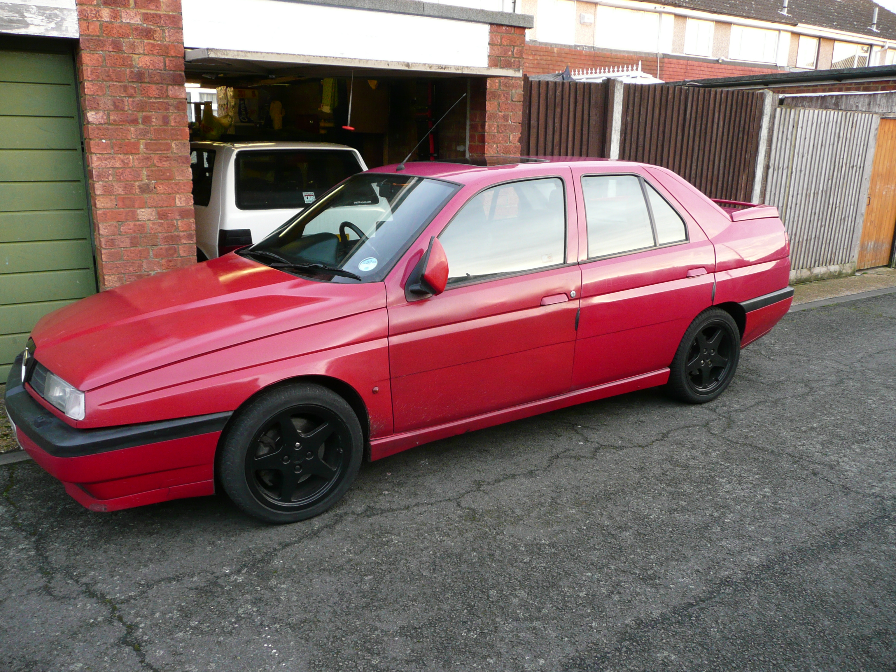

it's all about personal preference, mixed with a little technical knowledge, now you have the numbers, ignore the aftermarket jobbies, and get retro wheel hunting, as damon - pandasport pointed out to me, fiat is not your only port of call, lancia, and alfa are also in the frame, and from there it gets intresting:

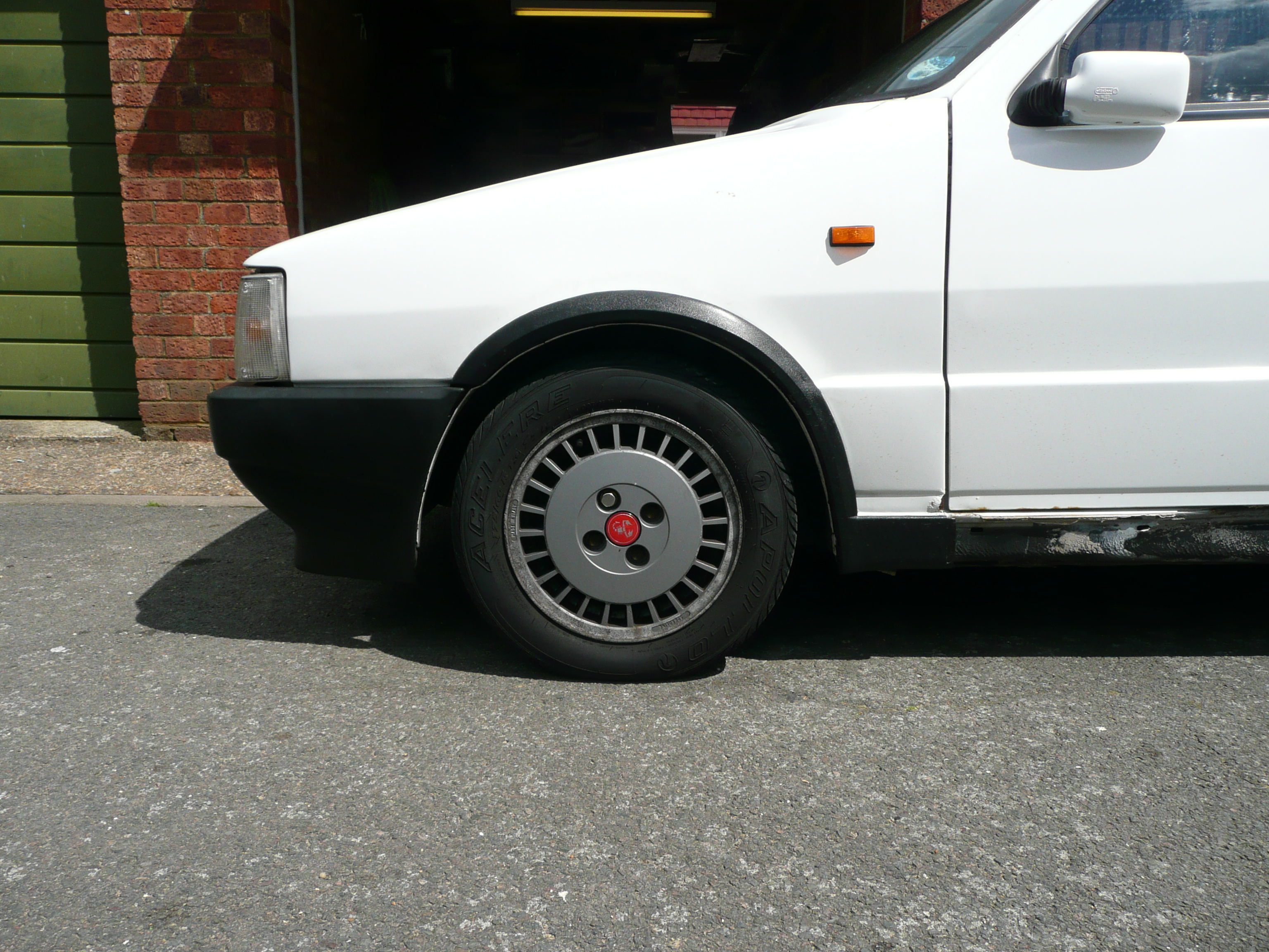

and with a little arch work, even these will fit:

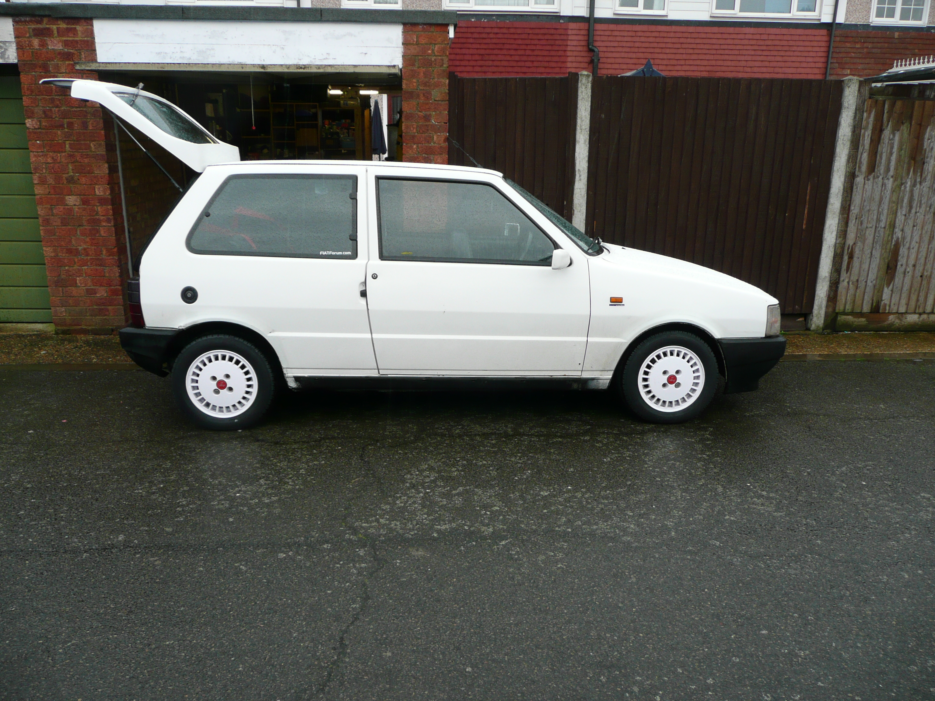

there's a ton of different looks out there, personally, i like the original 13s on the white car, but love the tipos 15s on her.(y)
